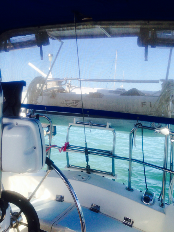

Will take photo tomorrow. Dark here now. We sail as sloop also, but we have staysail halyard as well as spinnaker halyard. Both would do to lift dingy. Our running backs were wire to near the deck with 4:1 tackle. Not suitable for lifting dingy. Not enuff hoist to cope with bridle.
