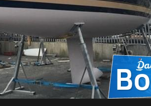

I have recently purchased a 2004 373 and there is some confusion as to the draft on this boat. Initially she was presented as a deep draft, but upon the haul out she was found to have a shallow draft, I was not present at the haul out. The surveyor said she was the shallow draft and in the photo she did not appear to have a bulb or much of a bulb keel which would make her draft 4'11"? I have not been able to find any info on a shoal draft 373 being offered. Does anyone know what the draft for this boat is?

Definitely shoal draft; you are correct, draft is 4'11".
Welcome to SBO! I made an offer on 373 many years ago, but it didn't pan out; purchased 343 instead with 4.9' shoal draft keel. No regrets 10 years later. Enjoy!

Thanks, So this is the standard Keel then, I just expected there to a more pronounced Bulb along the bottom of the keel

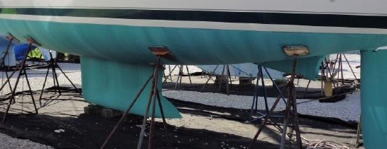

Maybe it is the angle, but it doesn’t look quite right to me (I have been admiring the B373 for a while).
note the fairly large bulb on the bottom, and relatively flat foot…and the long extension on the bulb.
Just doesn’t look the same To me.

Here is an image of a:
BENETEAU OCEANIS 373 CLIPPER 2004

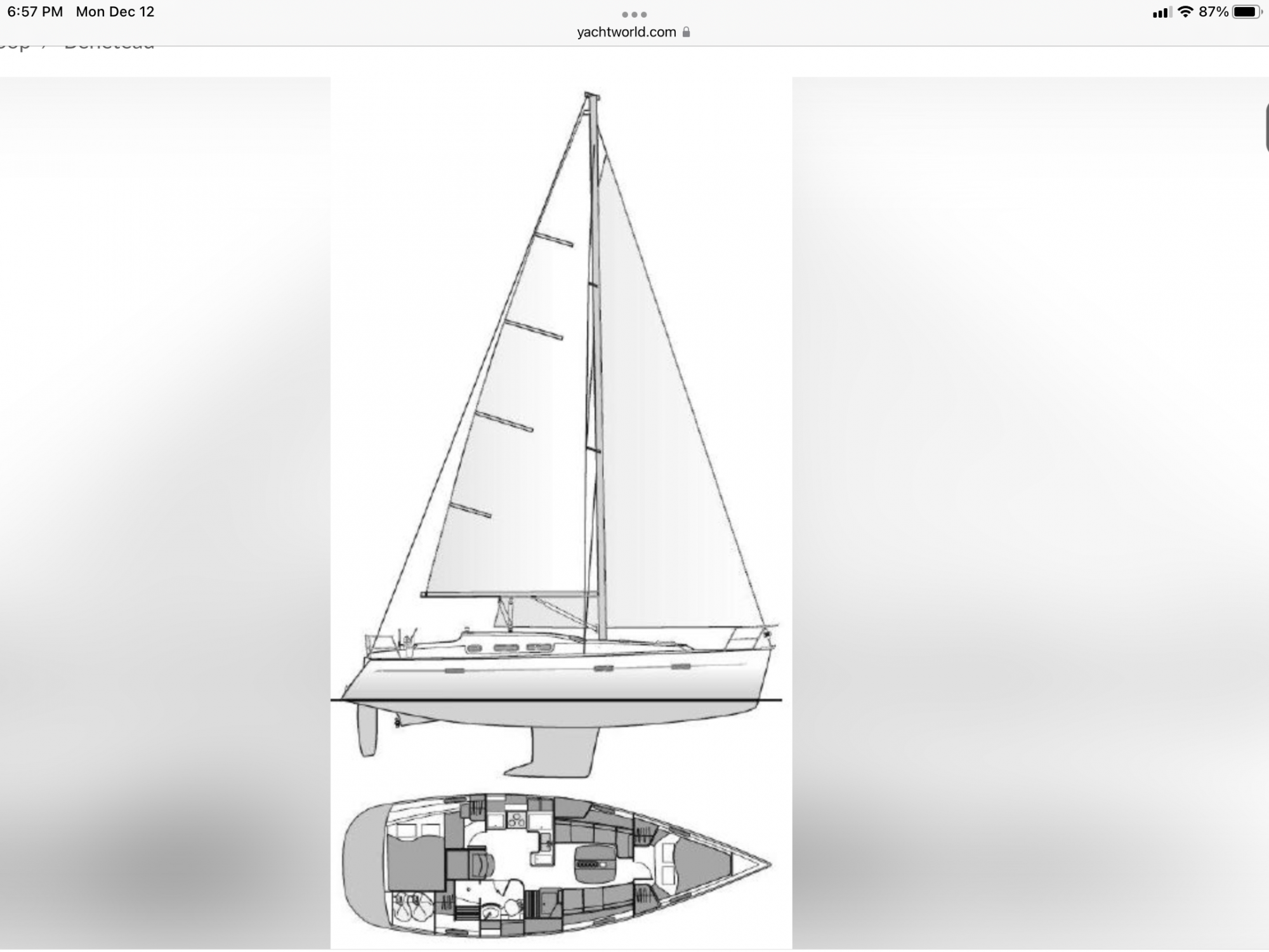

I think the confusion may be that Sailboat Data drawing is the deep keel and in the descriptions they list the 4'11" keel and not mention that a deep draft keel was also available for this boat?

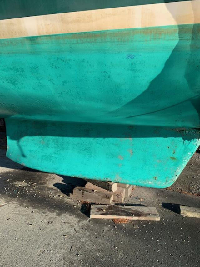

Here is my confusion, if the first image is the standard keel and the second is the deep keel, could mine be even less than 4'11" and without the bulb could the weight and the Bal./Disp. ratio be off? I will diffidently have a tape measure with me when the boat arrives and hopefully the crane can weight the load.

That image is not my boat, I was showing the difference in keels. Though, I did get a photo from the transporter this morning from the rear of the boat showing a much better view of the bulge in lower part of the keel. The keel on my boat still different than the one in the image above.
It appears that the camera angles are not revealing the bulb at the bottom of the keel. Either a forward or aft camera orientation would show the extent of the bulb. Most Beneteaus offered a shoal keel as standard and a deep keel option. I know that the 323, 331, and 343 also offered a swing keel option ; however, there aren't many of those configured boats available. I wouldn't be overly concerned about the keel shape; the important information is the draft, which you already know.
