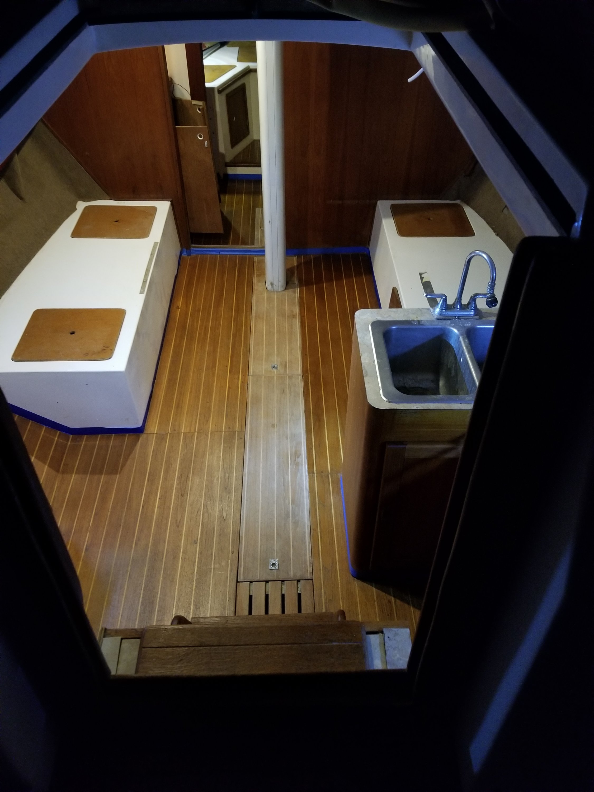

Mine has a very slight list to starboard also, I assumed it was the waste tank, batteries, kitchen and propane all being located starboard. Additionally the previous owner took out the aft cabin wall and doors as well as the desk.

Thanks for the post. Sounds like you got a bit more on your starboard side than i do.
Not to derail my own thread but do you have pictures of the interior? I'd love to see what it looks like without the bulkhead, nav desk, and door...

Yea Its kinda a work in progress, the p.o. really liked open space I guess, he also took the table out in the salon

AVSDDS - thanks for the pic - does look more spacious. Like yours, mine does not have the salon table either. I need to make something one of these days. I am thinking a fold down table like my 27' has.
