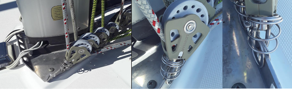

All my halyards, boom vang, mainsheet and continuous furler control lines are run through turning blocks (Lewmas with stand up springs to keep them off the deck in a vertical position) at the base of the mast step then back to the cockpit. If I had reefing lines (and I do not) they would also run through them and back to the cockpit. Each are attached to the mast step hole with a shackle and 2 large diameter clevis pins.

A picture of your mast base would help clarify the challenge that you are observing.
Dec 18, 2012
160
Hunter 37.5 Annapolis
Hans, The chances are you have an Isomat mast and base, like I do. The turning blocks screw into a thin nut slipped in slots along the lower edge of the mast base. Check out this Rig Rite page:
