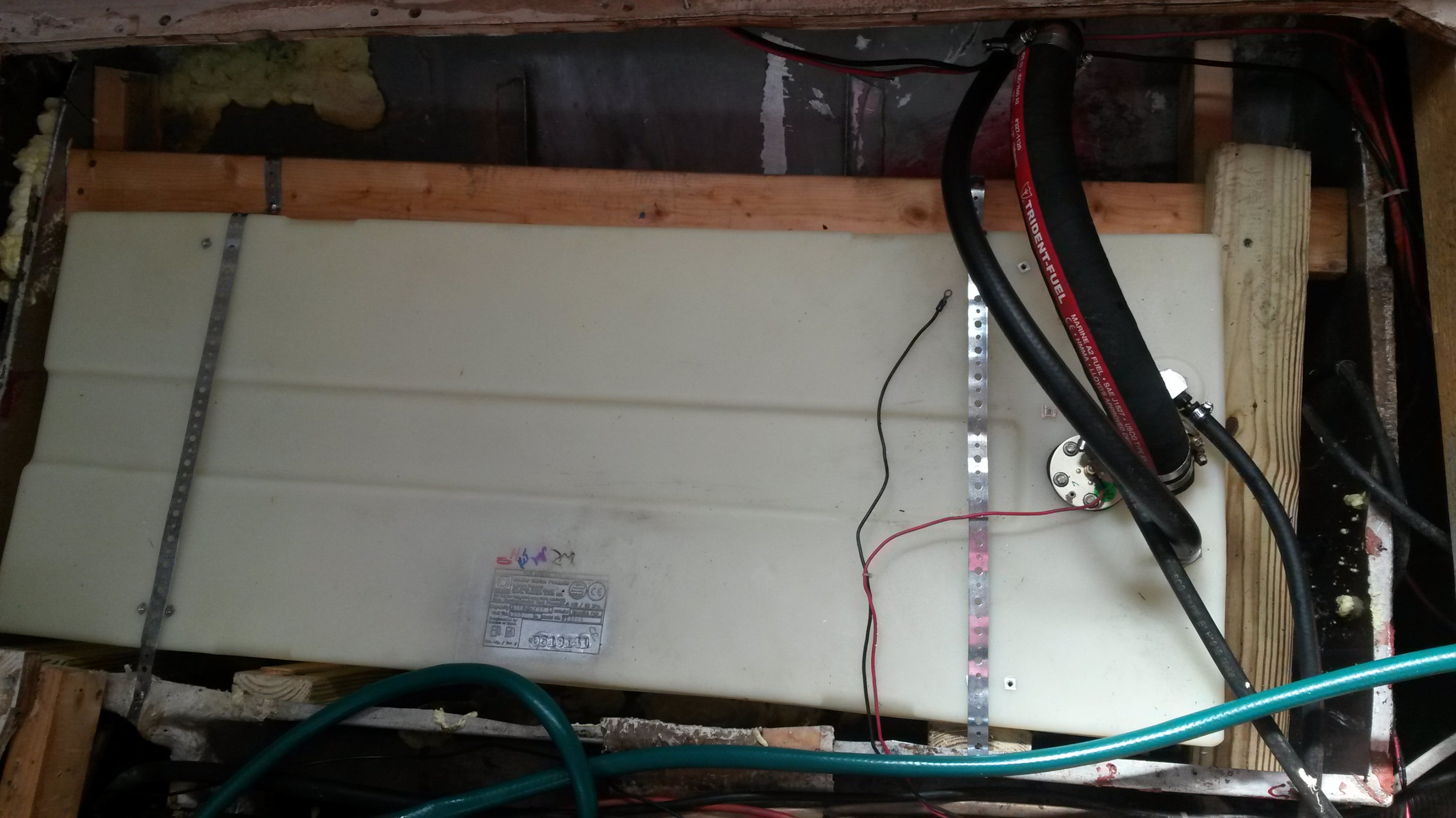

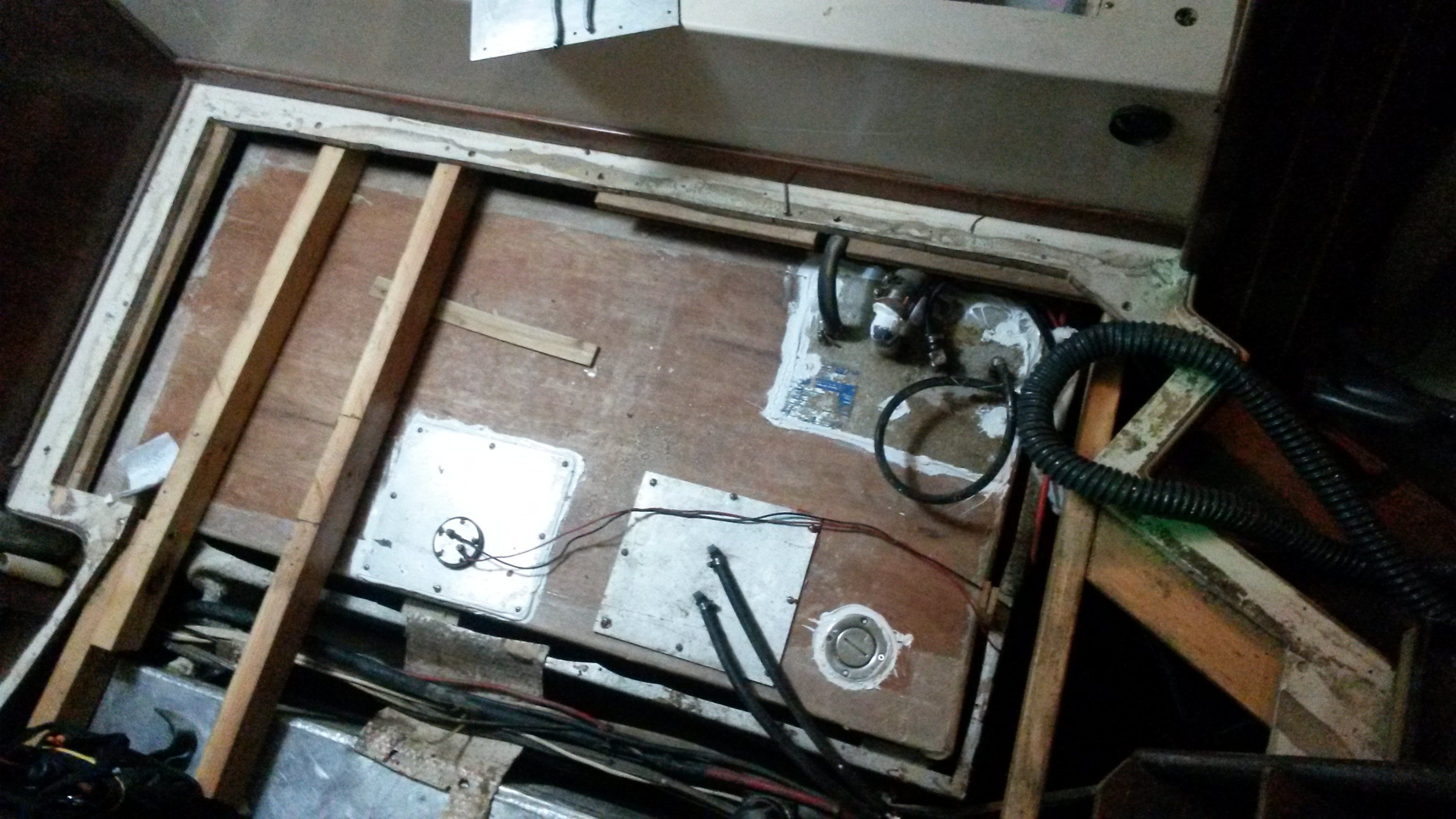

There were two, equally distributed. The whole bottom of the tank was corroded away and not salvageable. I will look for pictures and post if I can find them.
Apr 16, 2015
9
irwin 37 cc Oriental
I don't know why it posted multiple copies. The one with the wood inside is a fiberglass tank I build but then I decided I underbuilt it so I pulled it out. The other is a 27 gallon tank from Defender. You can see the aluminum tank edges and also the water tank to port in the first photo.
