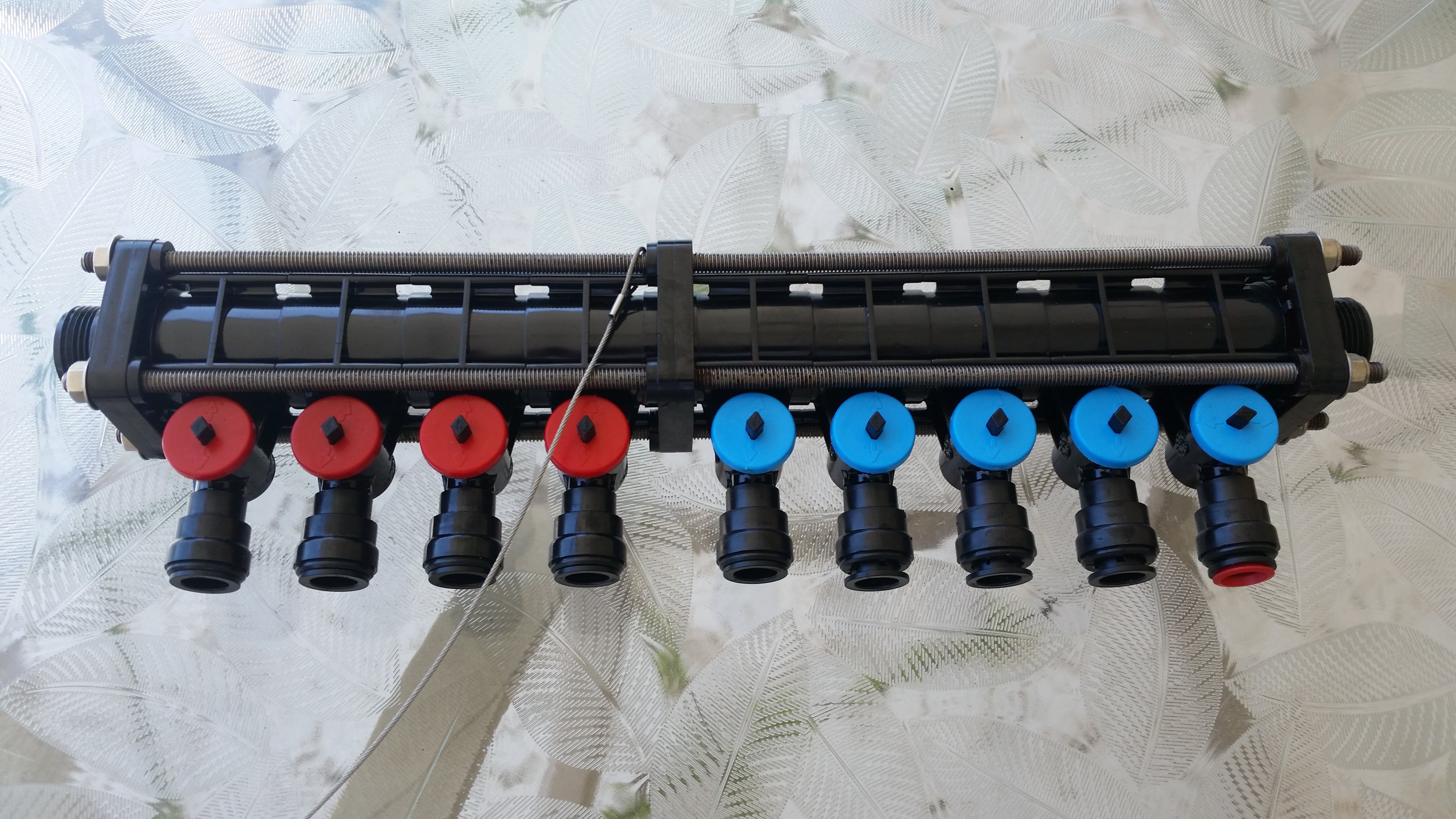

Ok, everyone who said manifold is probably correct. I spoke with a guy from Sea Tech. They no longer build that manifold but he says the divider between the cold and hot is a gasket or something and absolutely suspect. I'll take it apart tomorrow. Has anyone opened one up. After eliminating the heater, it seems logical. Thanks to everyone that took an interest.

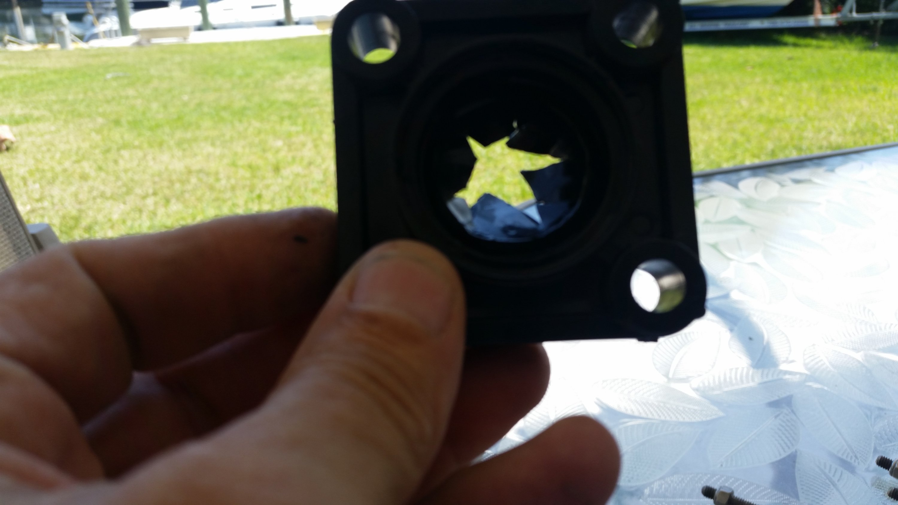

If you said manifold then next time you are in Miami, I'll buy you a beer. Not to bad to take out, about 20 minutes. The thing with the star shaped hole is supposed to separate the cold from the hot. The fix was a 1/8" thick aluminum disk that would fit where the old divider was. The flanges of the push in fittings left and right though petty thin hold it in place. A little Dow Corning 733 (they said it's food safe) takes up the little slack (1/4" too thick , 1/8" a bit thin and no 3/16" available). Put it all together and voila constant hot water. Guess, the high water temperature on the plastic and the constant pressure broke the plastic piece; the aluminum should hold. Wow! Thanks for all the interest. Can't wait to enjoy the hot water. See pictures.

One last thought, will the aluminum transfer the heat from the hot side to the cold. 'Have to wait and see. Here's the look down the tube broken.

Wow! it looks just like a joker valve - that explains the fluctuations.......
