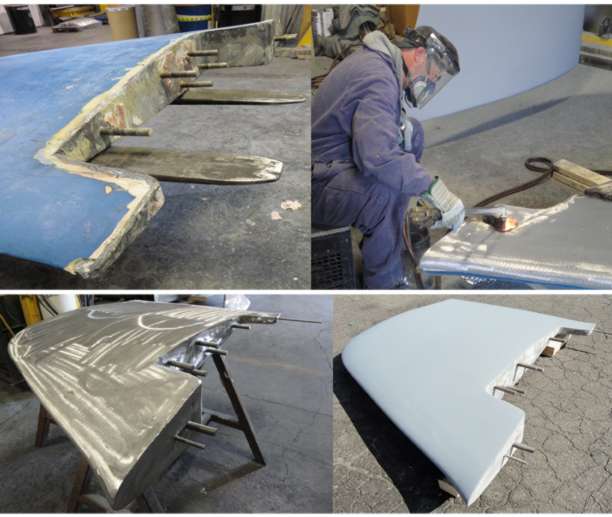

Chuckwayne and Crazy Dave, I was looking at the MarsKeel website and found these pictures. Note the file name is from MarsKeel and says Hunter 356. It's the deep keel no doubt but definitely "U" shaped.

Those pictures then tell me what I was looking for. I ordered the wing keels only which would have been correct for a straight line only sealed with 5200 as was standard practice at that time. With a deep fin keel that would explain the u shape previously mentioned. The original post did not say which keel he had. Probably the deep fin keel. The keels were lead and there were times where keels may have misaligned which a fiberglass skirt could have been added to make a smooth transition from stub to keel.

Guys, there is no difference only that the fin keel is longer and has no wings. Mine is a wing keel. Look at the bolts in your bilge they could only work with the U shape. Look at the front large bolt with the 1/2" one right in front of it which are 10" higher than the other large bolts; this is just as shown in the Keel drawing. Look also at the aft 1/2" bolt that is right at hull level as shown in the drawing. What you are probably looking at is fairing that would wrap and hide the U parts. Anyways this solves nothing as we still haven't figured out why the fairing at the aft end of the keel has come loose and bent in such a peculiar way.
