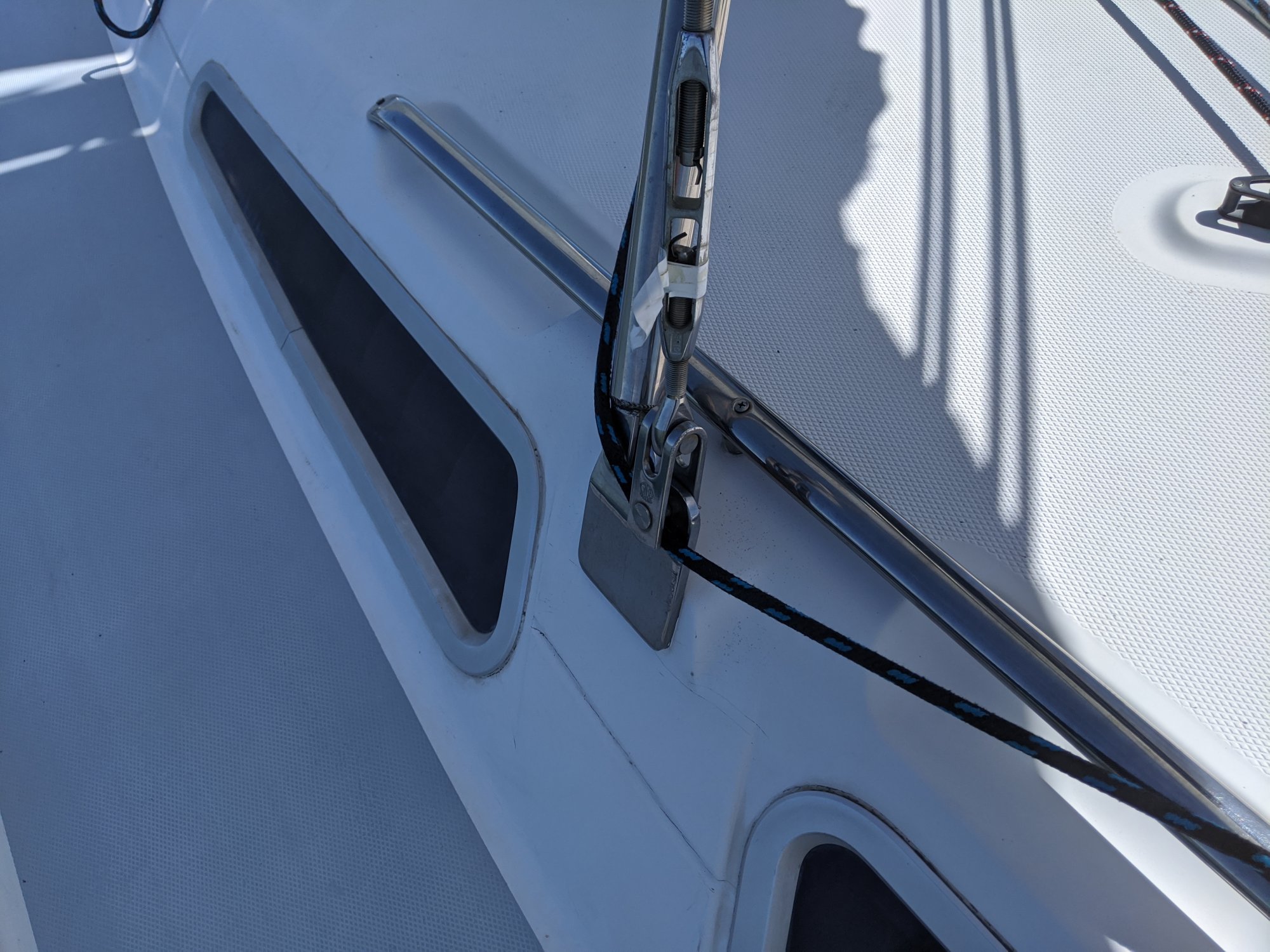

356 Jib sheet keeps getting caught in the rigging

You are not the first one to have that happen on a Hunter 356. Good tips proposed in the attached thread.

Chucks idea to put some line in there sounds like a cheap and easy fix. Thanks for the link.

The newer H-36 rigging is setup different no strut needed and don’t have you problem.

The same exact problem, for another boat model, was discussed this past week. There is a gap between toggle and tang that catches the line..... so eliminate the gap by installing a spacer/washer on the inboard side of the tang to push the toggle jaws inward so the outside is flush.

Hunter 356 Lancaster
On our boat, I found that there's enough tension on the shroud line that a few taps with a hammer will push it in and close the gap that catches the jib line. The washer idea is next if it doesn't stay put. Cheers.
