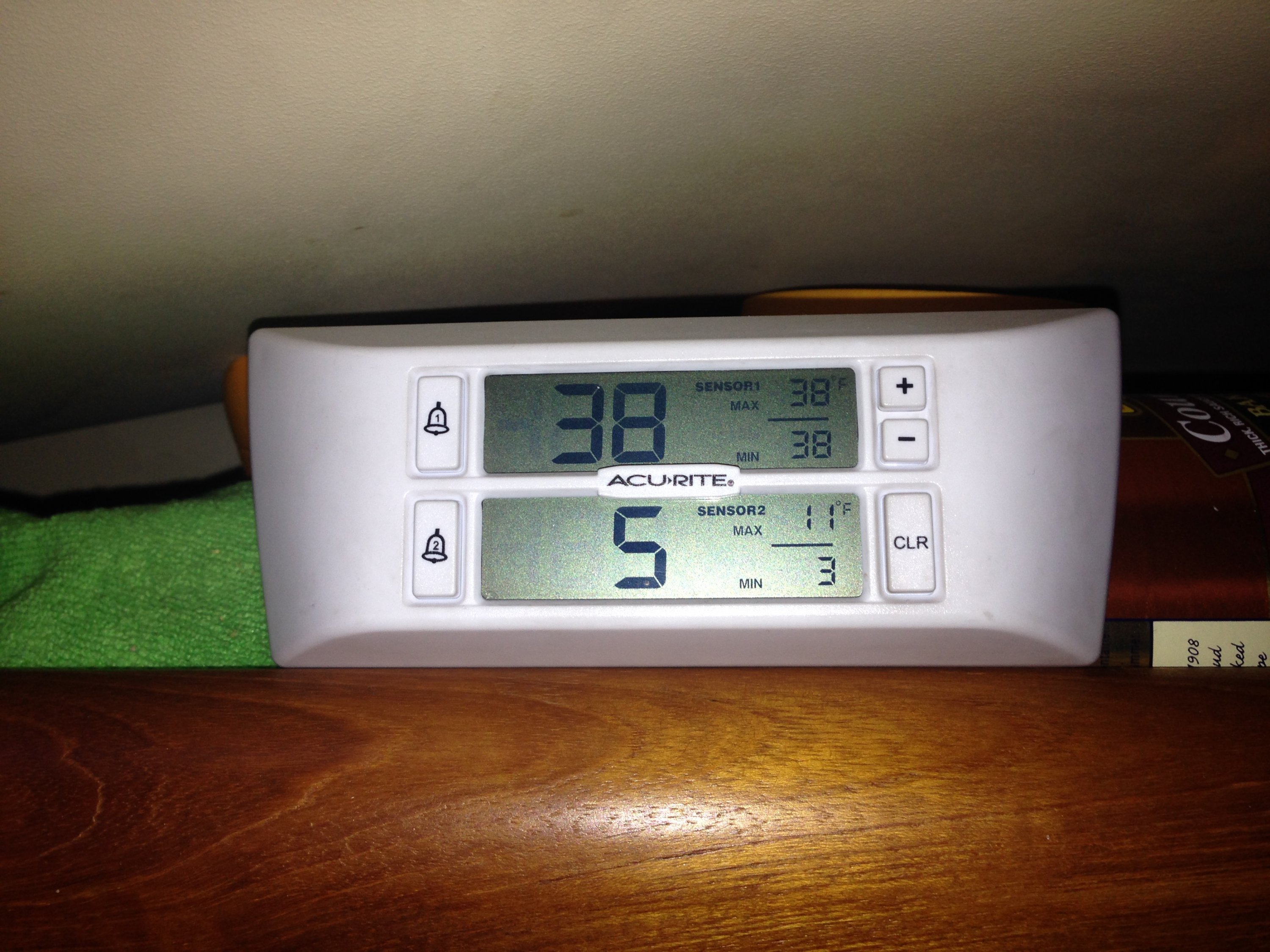

There should be a spill over fan between the two boxes. It blows air from the top of the freezer to top of fridge, draws air through the hole connecting them on the bottom. The freezer has a thermostat set well below freezing, the spill over fan has a thermostat in the fridge set for 38*F. Let us know if that is how yours is set up.
Most like to buy wireless thermometers to keep track of the temps in each box.
http://www.amazon.ca/AcuRite-Digita...45918418&sr=1-4&keywords=Wireless+thermometer
Use a piece of paper to test the seals around the lids, replace seals if the paper pulls out too easily.

On our system the spill over fan thermostat ran off the freezer thermostat power, so it could only run when the freezer got warm, the second issue was the spill over fan thermostat would not turn on until 40*F and not turn off until 30*F. Too much hysteresis. We replaced it with a cheap electronic thermostat running directly off 12 volts and fridge is much better.

Ours works fine with the insulation from the factory. It may take a while to get used to the settings. Buy a wireless thermometer and monitor your readings. On a six month cruise, we had to defrost only once.
You do have to be careful not to block the transfer hole between the two boxes so the air from the freezer side moves over to the refrigerator side. Also make sure you put a stopper in the drain hole. The stopper makes a difference.
