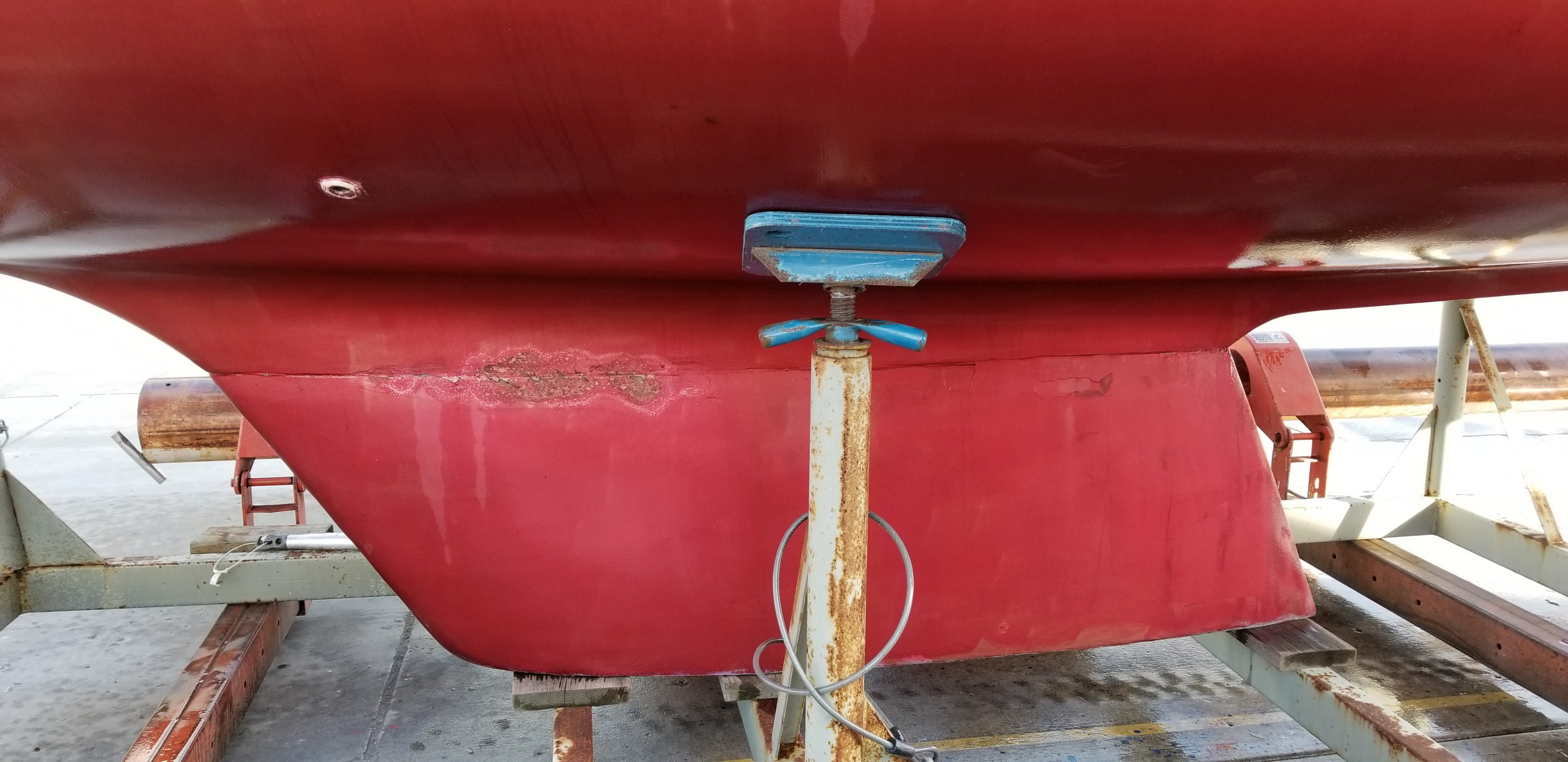

Several years ago I stripped our cast iron keel and applied seven coats of Interprotect, over which we apply VC-17 annually. For the last couple of years, when I haul out in the fall, there are a few areas of rust at the keel to stub joint. On our boat (not sure about 34s in general) this joint is not faired, but the sealant is visible, like a caulk joint. I applied the Interprotect right over this. Before launching, I have ground down these areas, applied new Interprotect and VC-17, but the next year, the rust is back in those couple of areas.
I am wondering if the chronic rusting is because the sealant has failed, and if I should consider dropping the keel and rebedding it? I have never checked the torque on the keel bolts either, but I am guessing if the sealant has failed that re-torquing is not going to solve the problem.

Resurrecting an old thread as this problem has not gone away on it's own :) Last winter I checked the torque on my keel bolts, and this summer closely monitored any water in the bilge. I have nothing that drains into the bilge, and the only time I had any water at all was after a rain and I was able to determine that water comes in through the mast during a hard rain. I am now confident there is no seepage at the keel/stub joint and the joint is not moving under sail. HOWEVER - this year it dawned on me that the discoloration evident at the keel/stub joint goes not only onto the keel, but also onto the fiberglass stub. When I inspected the entire bottom I found that there is similar discoloration around every metal through hull as well (albeit very slight). I also determined that the area on the keel that is discolored is right at the keel bolt where the bonding wire attaches - and the bonding wire is similarly attached to all of the metal through hulls where this issue is occurring. I think it is reasonable at this point to assume I have an electrical issue and I am wondering how best to begin the troubleshooting process, especially with the boat out of the water. A couple of points - we are in fresh water (always has been) and on a mooring so the likelihood of stray current from docks or another boat are extremely slim. The good news is my magnesium sacrificial anodes have been doing their job - the prop, shaft and strut don't show any signs of corrosion, and any electrolysis around the through hulls seems to be limited to the copper bottom paint.

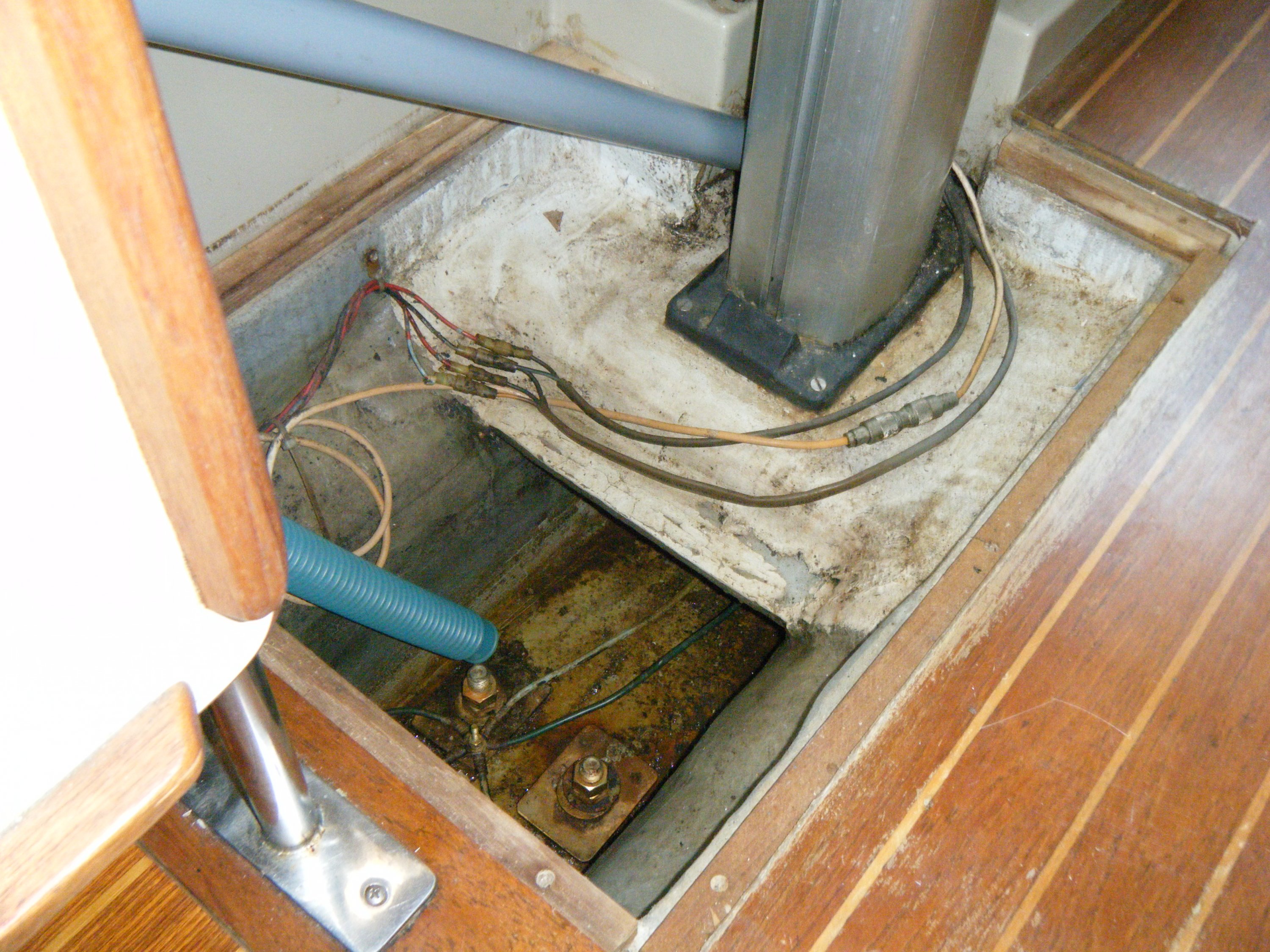

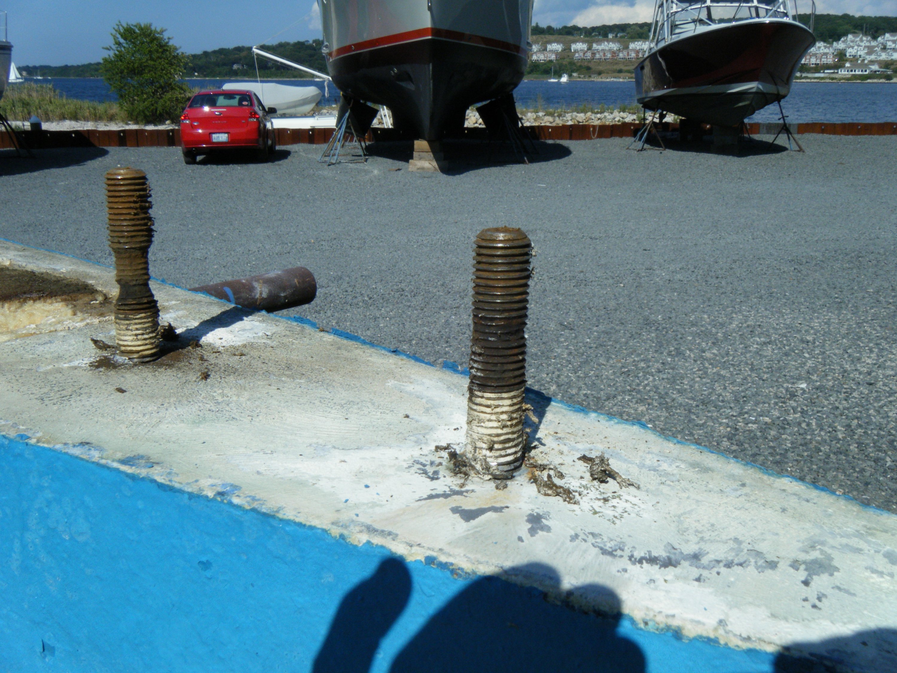

When I first saw the boat there was evidence of water in the bilge. After I made an offer to buy the boat, at the first survey, I discovered that the keel was loose, and the deal was off. The PO dropped the keel and we all discovered that 4 of the seven keel bolts were corroded to the point that they were not doing anything. One of them, the foremost one, snapped off entirely. The yard sent the keel back to I Broomfiled & Sons, and they replaced the original 304 stainless J bolts with larger diameter 316 stainless bolts and shipped it back to the yard. The yard rebedded and reinstalled the keel, then wrapped the joint with fiberglass cloth and epoxy.

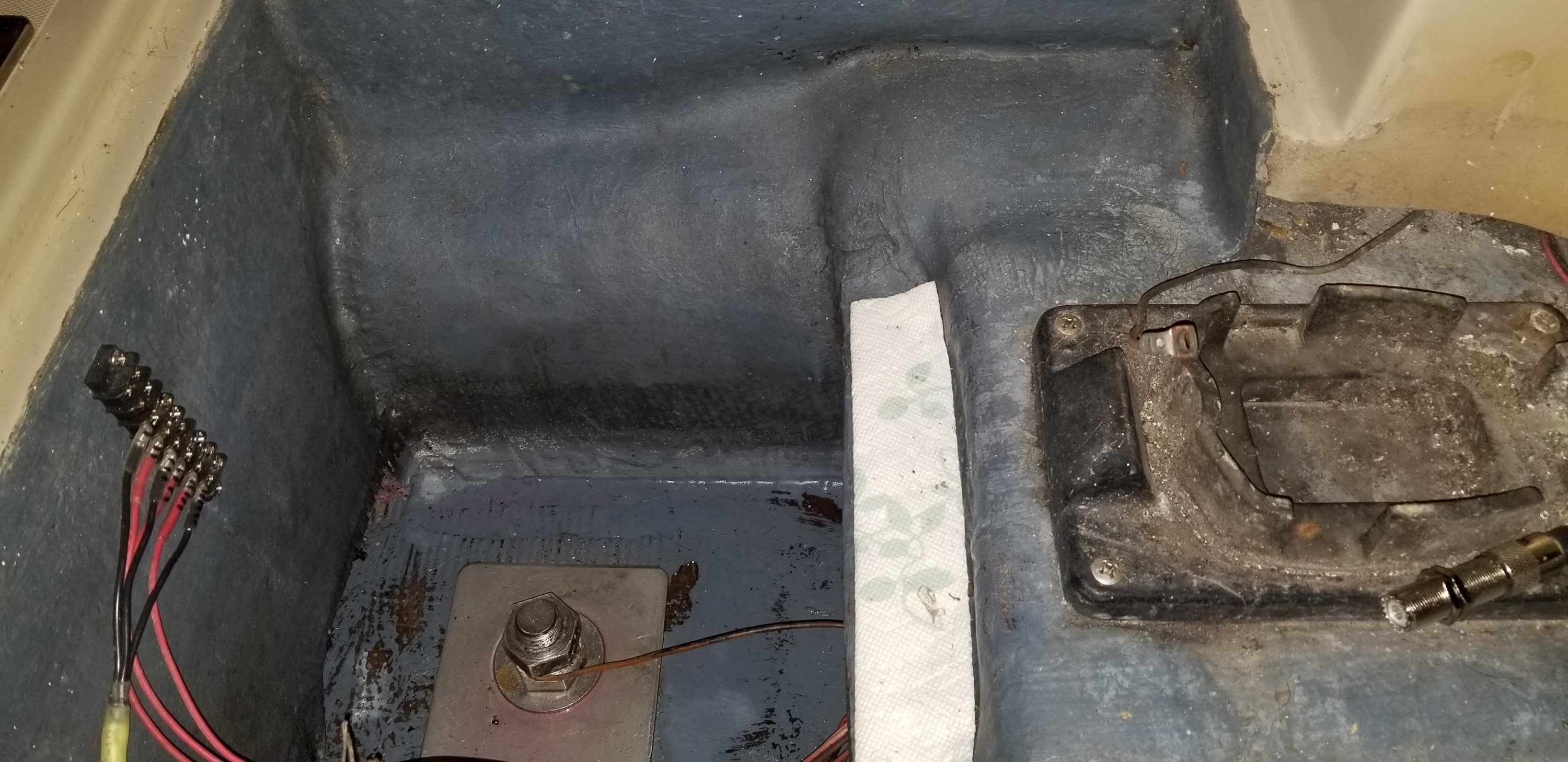

My keel bolts all look bright and clean inside, and I don't see any external evidence of the keel moving, nor do I get any water at all coming into the bilge through the keel bolts either when the boat is at rest or after sailing, even hard on the wind.

With a breaker bar and a deep socket and a lot of patience. I put the socket on the nut, then tried to position the breaker bar so that it would engage with the nut and allow me to rotate the nut. If it didn't I would rotate the socket one point and try again.
Here is a pic of my bilge and a keel bolt before the keel was dropped (when there was a problem).

And here is a picture of the bilge and keel bolts today.
