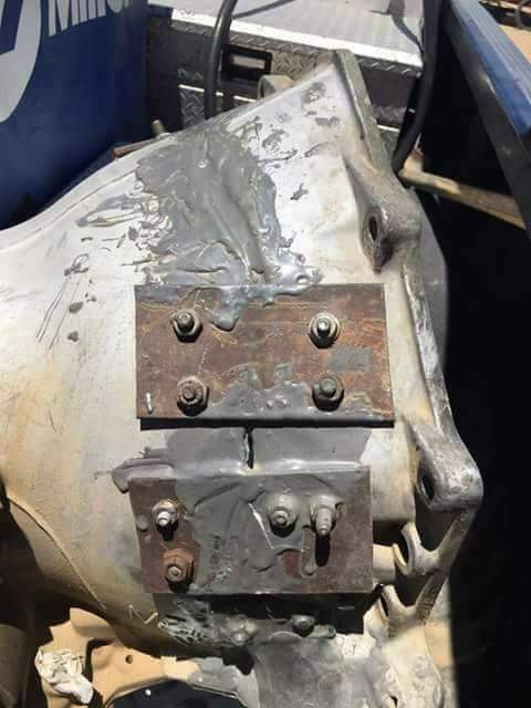

@jibes138 I saw this posted somewhere else and immediately thought of you with your cracked housing. Unfortunately, I realize I am too late with this helpful suggestion ;)

Wow, that should be an encyclopedia picture for "repair."
Getting off track, after pulling it all apart there is a pad on the side of the engine just forward of the flange for the bell housing that has 4 tapped holes that are unused. It looks like a motor mount could be machined to mount on that pad instead of the using the aluminum bell housing. It would be a hell of a lot stronger and similar to how the front mounts are attached. I just noticed yesterday the flange on the other side might also have a crack starting. I'll have to look with a magnifying glass probably overstressed when the port side failed.

Scott that cracked housing repair looks like something the po of my 34 would have done. ..lol.
