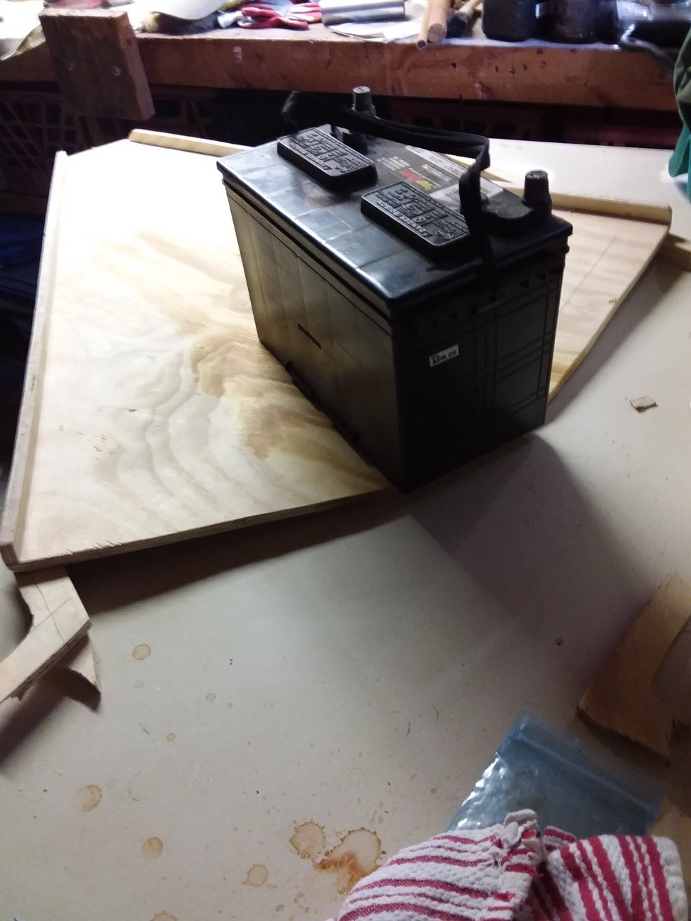

I planned to take pictures of the dissection, however once I got into it, didn't stop to take progress pictures. I'll take and post some during the replacement/rebuild. Planning to use 1/4 " marine grade plywood and encase in several layers of 6 oz fiberglass. The build requires that I provide a 1" bend in the plywood to account for deck slope.

Thanks rajh. I saw that video and may try that. Currently, I'm using 1/2" instead of the 1/4" plywood as originally posted. I've managed to get the appropriate bend by wetting the plywood and shaping with weights... found a use for some old battery cores :) Once I get the shape right and start glassing, I'll post more pictures.
