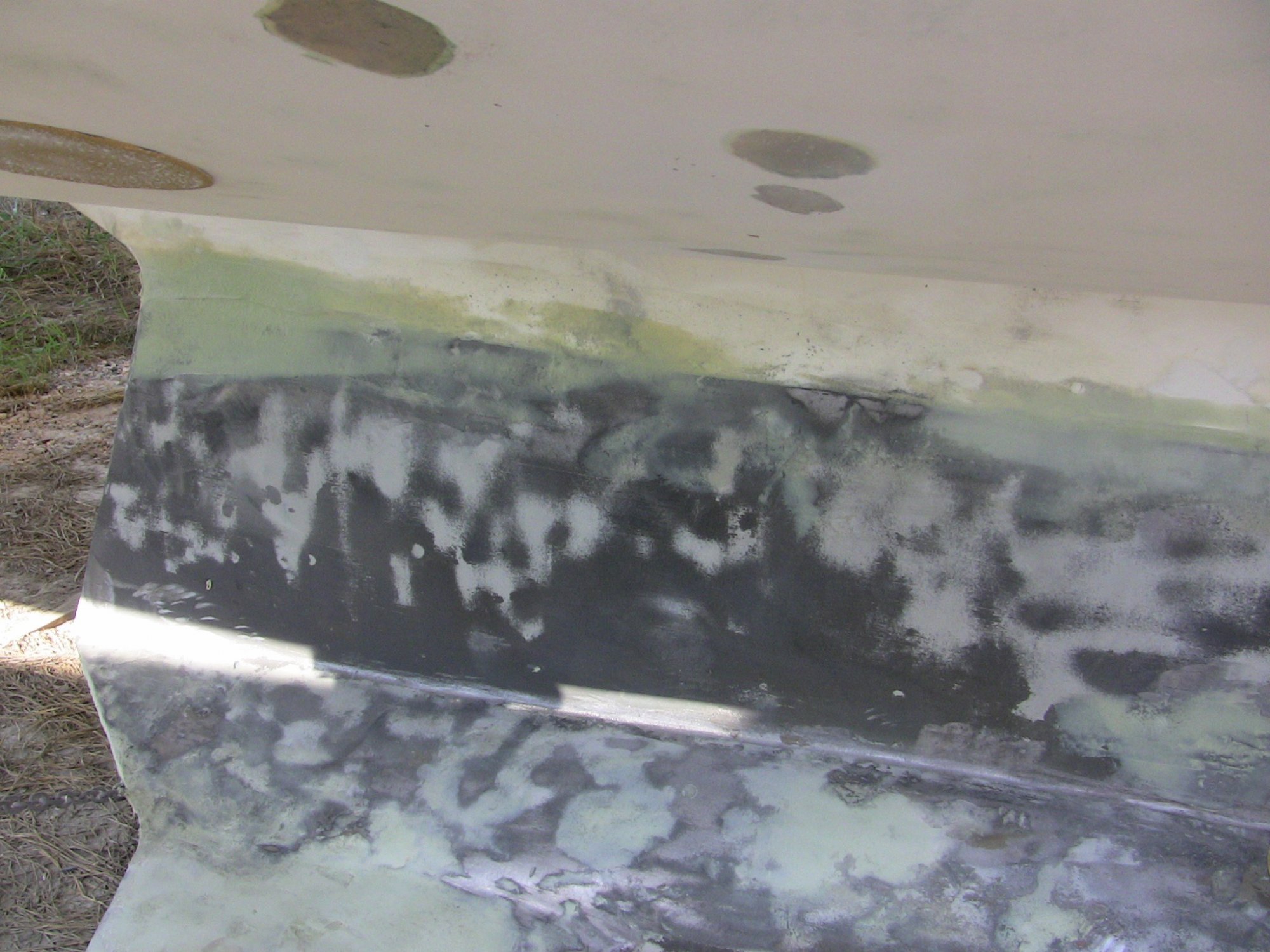

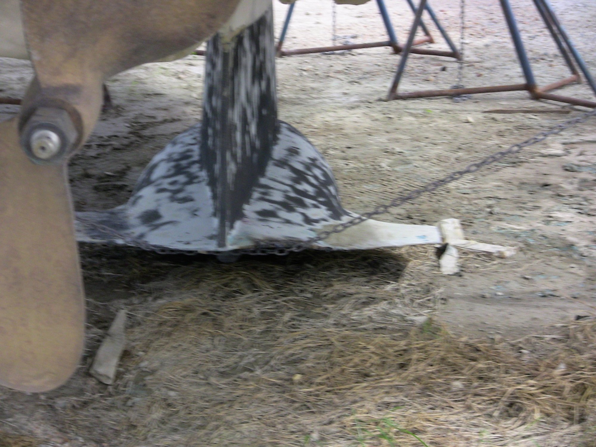

33.5 winged bulb keel, what's the airfoil?

I have to fix some rust spots and refair the keel, looks like it's been done poorly before. Was just curious if it was still anywhere close to original. Right now it's more slab sided than tapered haha.
