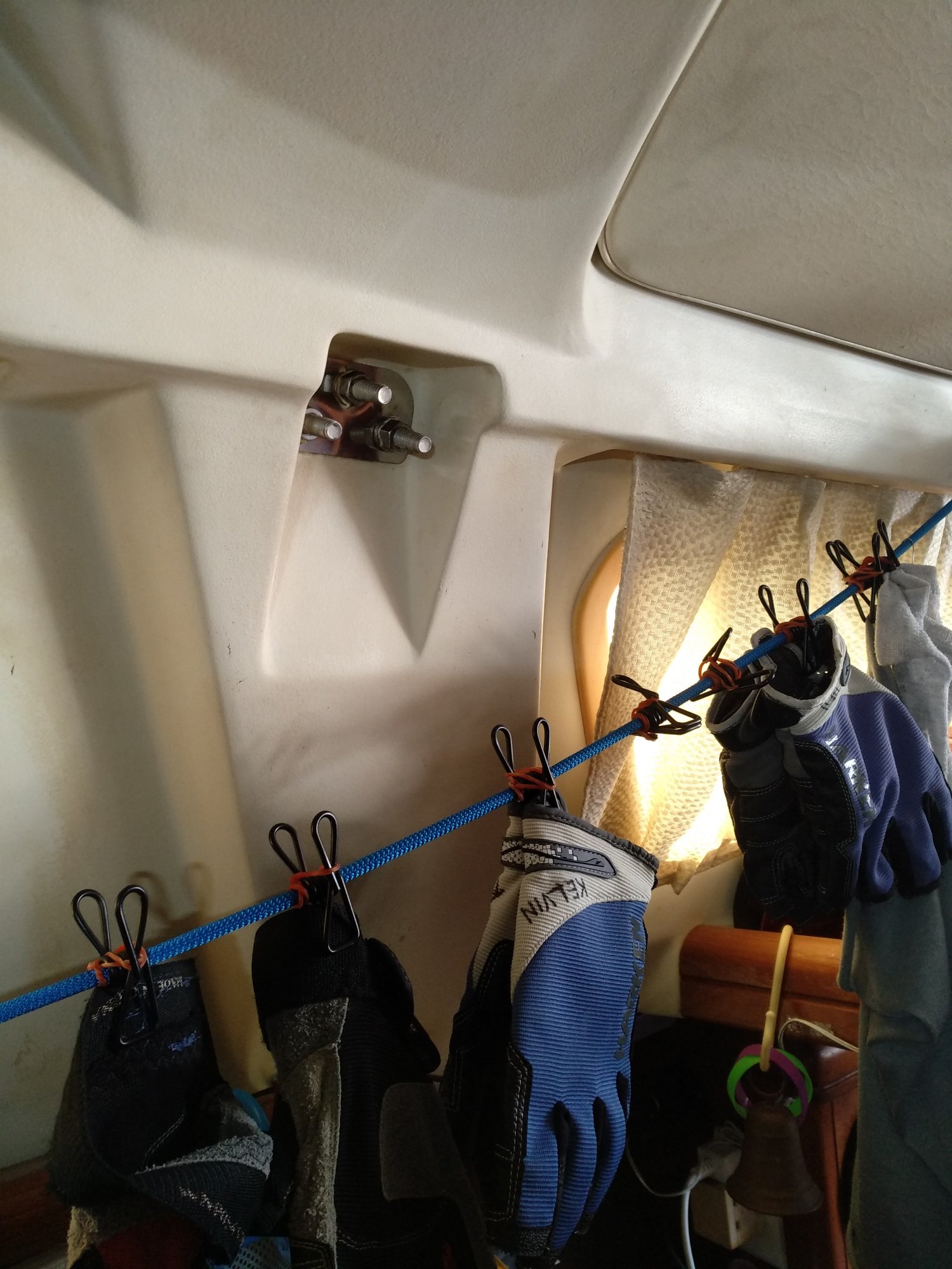

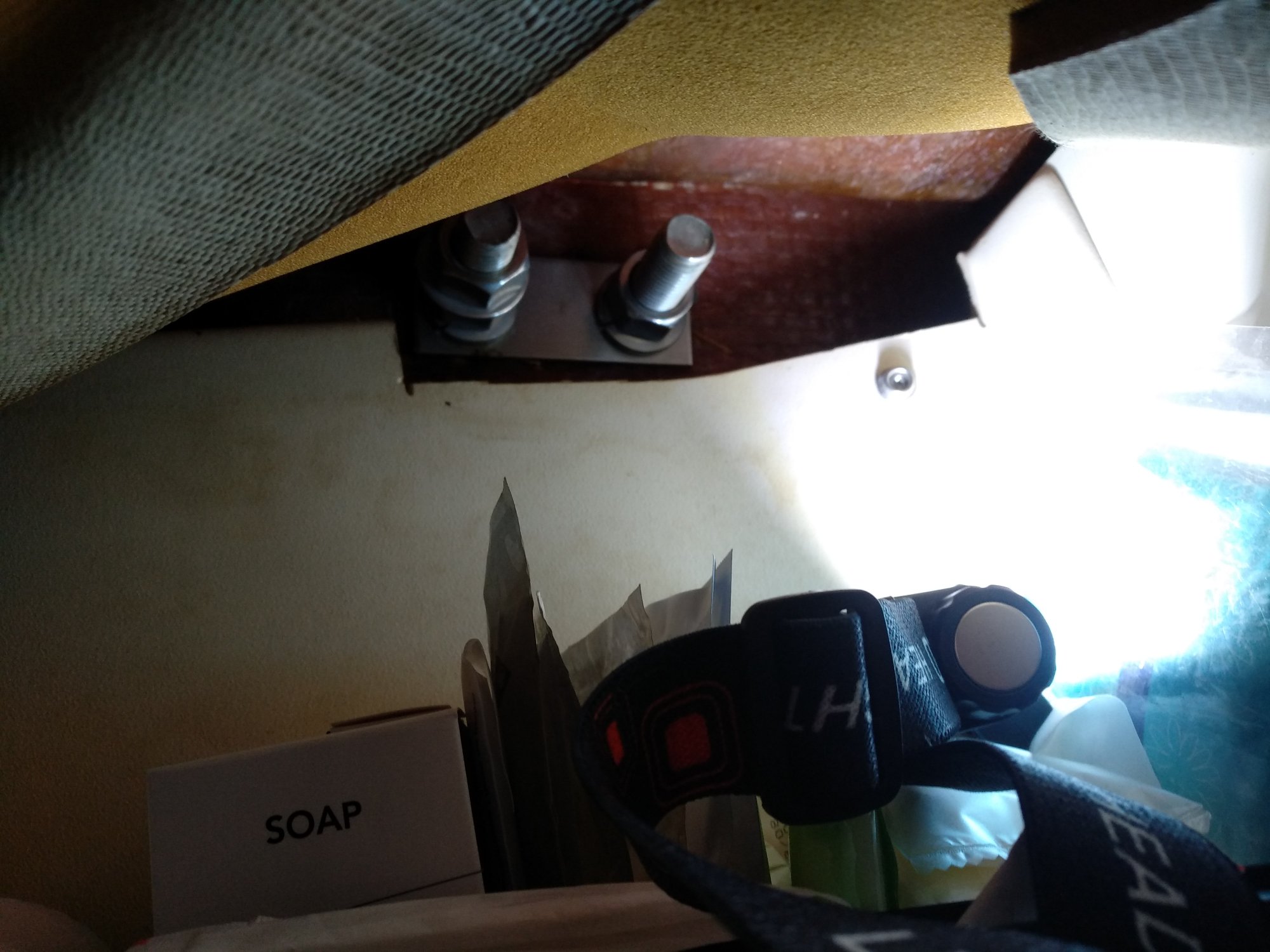

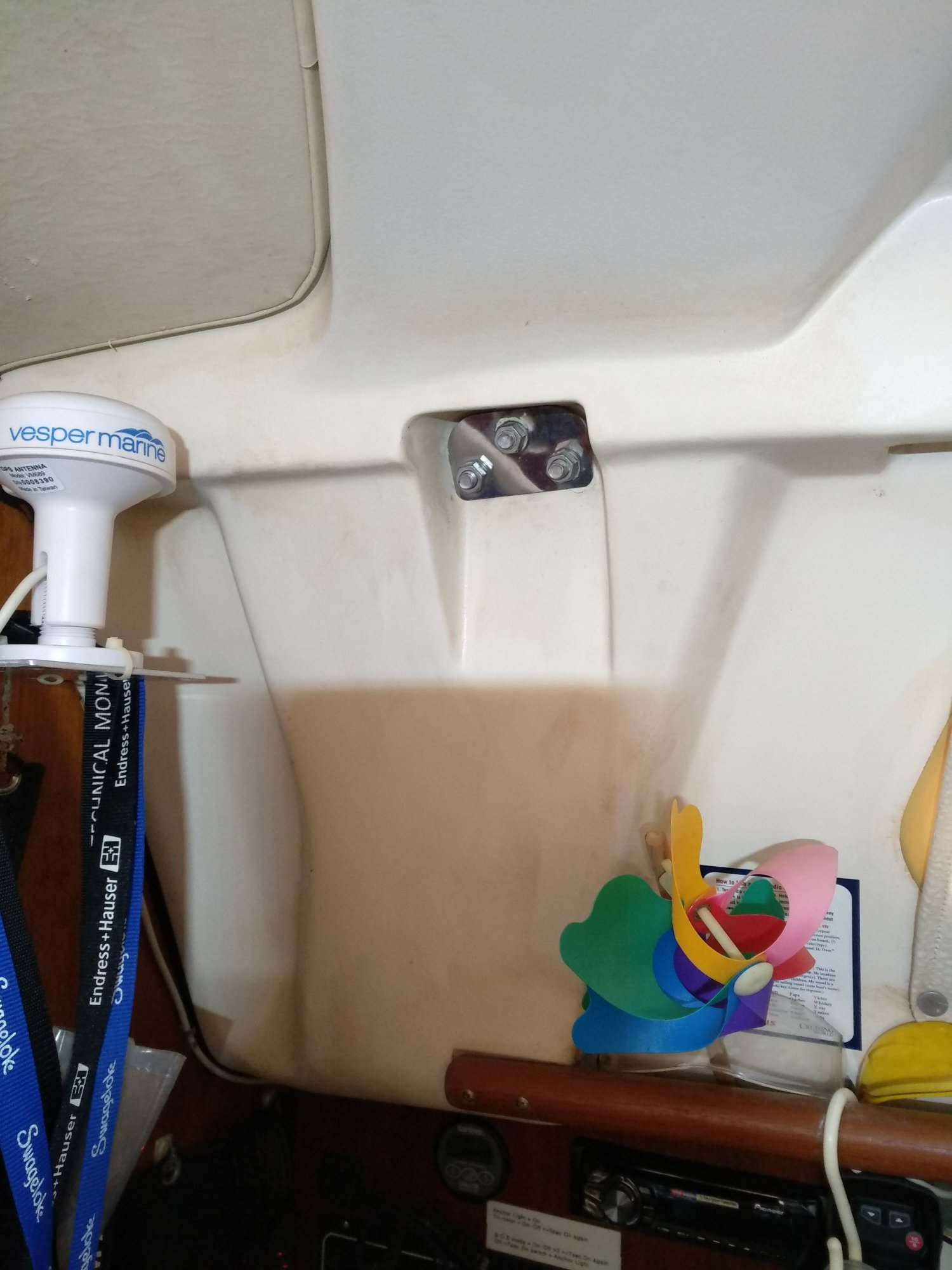

yes on the 356 and I think on the others.... on each side of the cabin headliner is a hard joiner strip between the forward and aft side pieces of the headliner. They come off with a few screws and provide full access to the chainplates

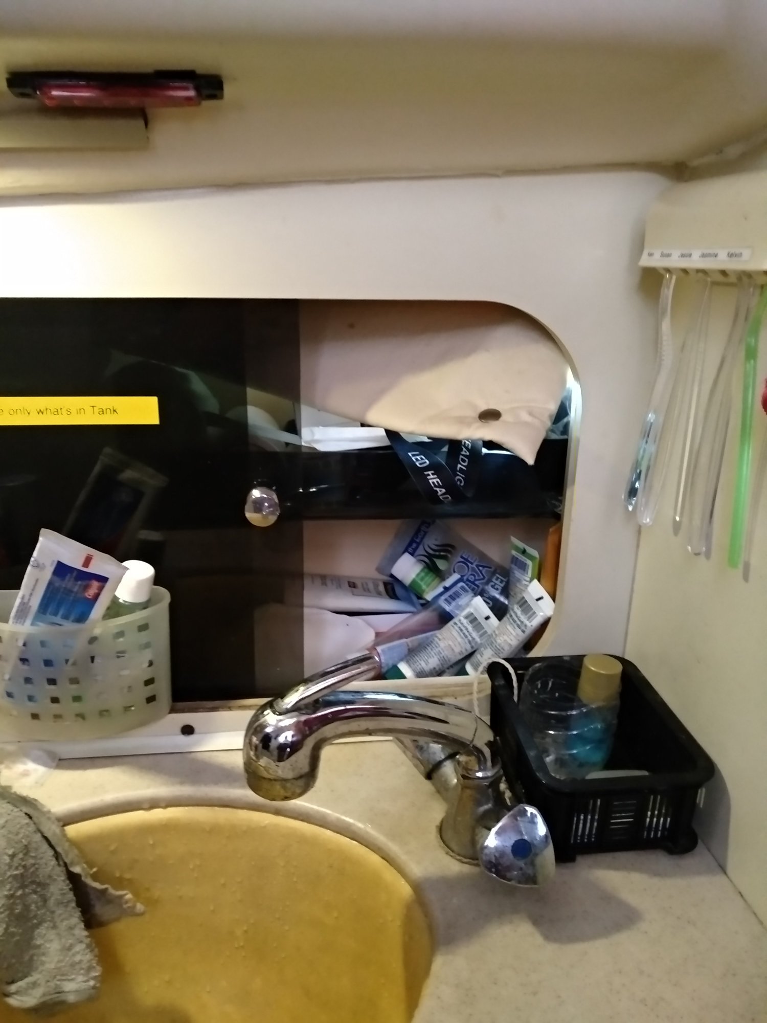

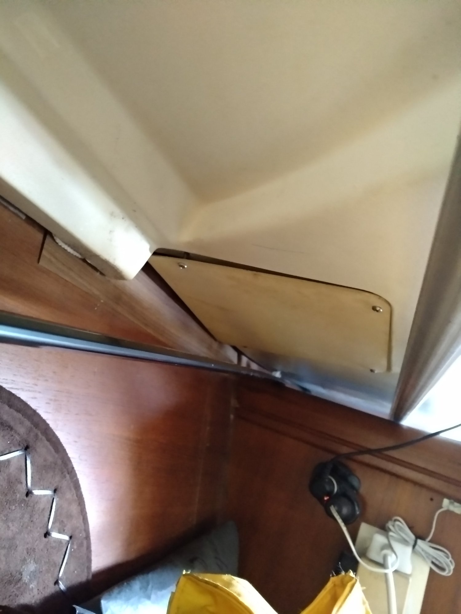

H326 shroud chain plates can be access from the Heads cabinet Port side and a through a panel SB side just ahead if the galley. If there's Struts, the mounting is not cover and easily seen.
