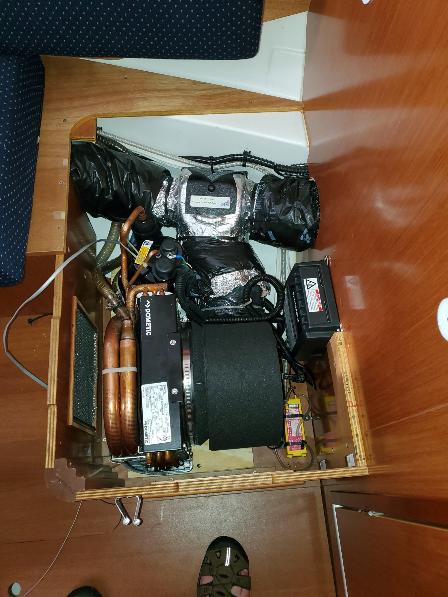

Here are a few pictures of my AC install. The unit is installed under the settee with red and white pillow on it, the vent is just above and to the left.

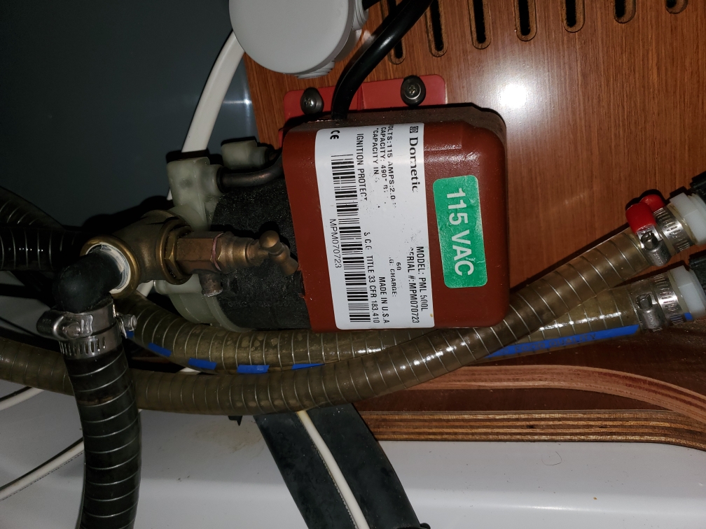

Don't forget the water pump. This one is installed under the galley. On my First 285 the pump was located behind the engine.
Edit, I should have renamed my pix.
Great photos. What is the make of the A/c unit?
Jul 23, 2009
926
It's a Dometic Turbo unit. I purchased it from Wright Marine, great service and the only place I could find one at the time.
There are plenty of other good units out there but I don't have the space for them.

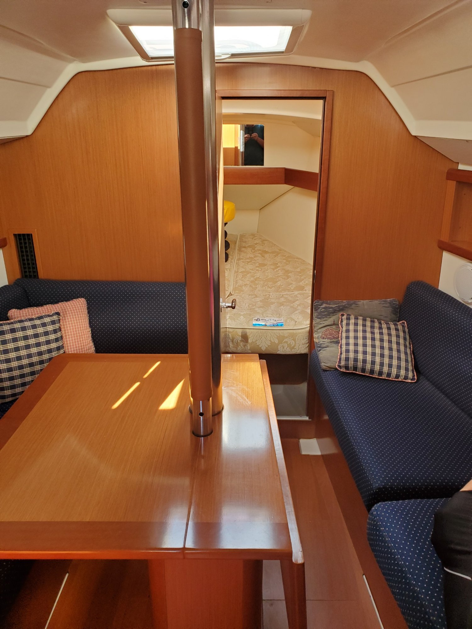

Troy, what is that pole from the table to the overhead, next to the mast. Looks like a beach umbrella, but I can't believe you punched a hole through the deck for it. Or did you?
Jul 23, 2009
926
I think there is a compression post and a hand hold. Maybe twin compression posts. I'll have to take a closer look at it. Its a factory setup.
