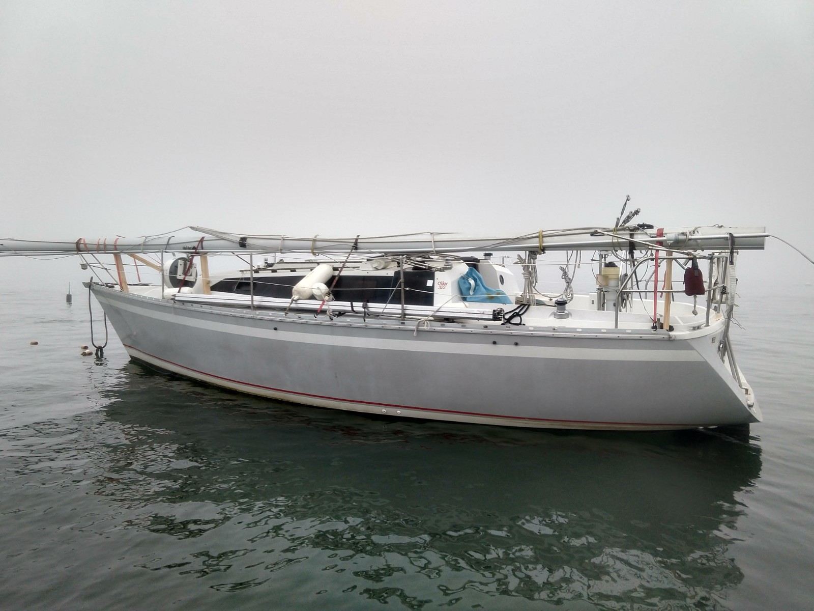

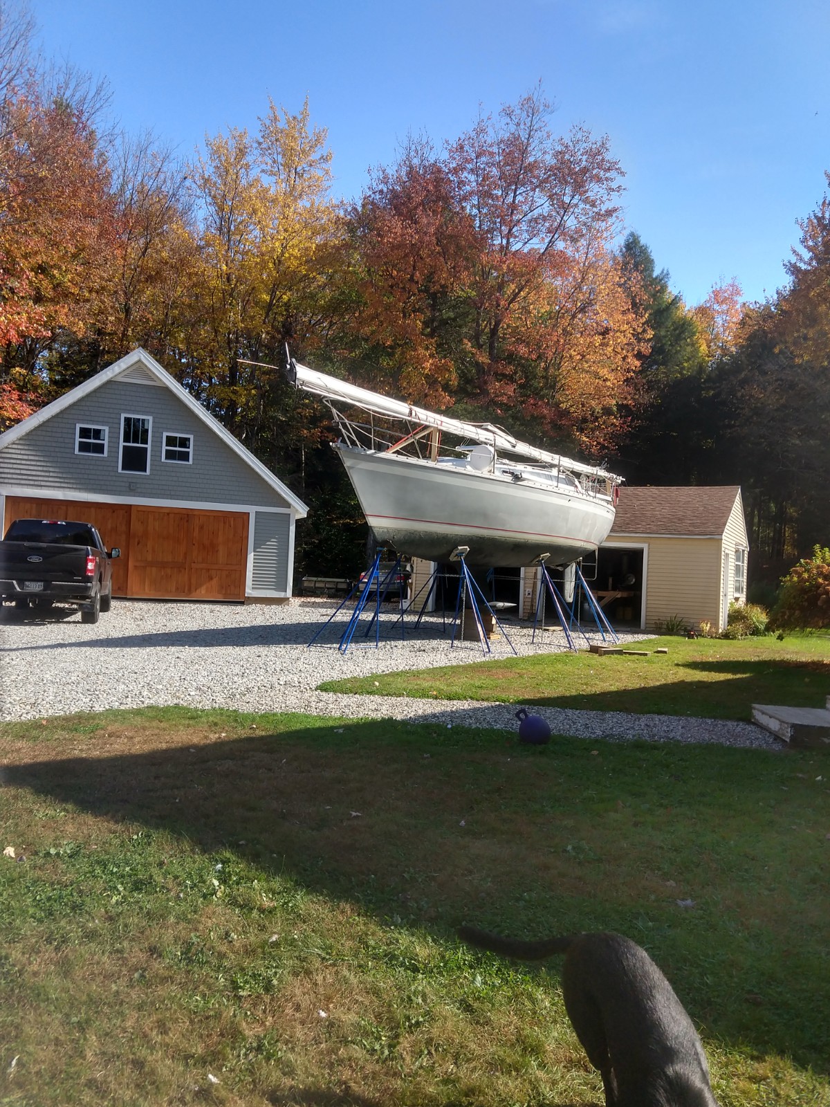

Last week I picked up my 33 year old O'Day 322 in Buzzards Bay, MA and brought it home to Casco Bay, ME. I was going to stop in Gloucester, MA for an overnight, but the weather was perfect so I just sailed through the night and made it in about 28 hours total. The last 12 there was thick fog and no wind so the Garmin Radar and little Yanmar got a workout. I forgot how much I love these little diesels. About 14 hours of motoring at 2,800 rpms total for the whole trip and I used 1/4 tank of fuel. So about 1/3 GPH, love it! Once I got it to my friends mooring in Freeport I unstepped the mast and had the boat loaded on a hydraulic trailer to bring to my house. Having the boat in my driveway not only saved me quite a bit of storage money, but it also will be very convenient to have the boat at home and 8' from my garage full of tools. Once the hauler left I got to work making some a-frames for the mast to rest on, lifted it up off the deck, and then did a little budget shrink wrap job with a weed torch. I gave myself enough room with the mast to get to everything on the deck and it has enough height that the snow should shed off the shrink wrap pretty nicely.
This will actually be the second 1987 322 I'll own. Back when I lived in Maryland for a few years I had one on the Chesapeake bay and did a few years of bay cruising and one long trip to Martha's Vineyard (hitting all the stops along the way). The shoal draft wing keel and the well designed interior were big reasons I bought the last boat as well as this one... When I decided I wanted another sailboat a few months ago (had just sold my powerboat) I was looking for something in the 34-36' range but this 322 came along at a price I couldn't pass up and offered a similar interior layout to the 34' boats I was looking at with much less draft.
I plan to do some east coast cruising with this boat and possibly some time in the Bahamas over the next few years, this coming summer I'll be staying local in Maine to work out all the bugs and hopefully head south about this time next year. So I'll be doing some appropriate upgrades over the winter to make it more comfortable for my plans.
In addition to the radar, autopilot, and dodger/bimini that are all in good working order. This boat also had all new standing rigging and brand new roller fuller last year. Big $$ items that will be very nice to have considering my plans for the boat. Now, with any old boat acquired for a relatively low price, there are a long list of projects that need attention and of course another long list of upgrades and things that I'll be doing along the way to make myself feel better and to reduce the chance of problems when I don't want them.

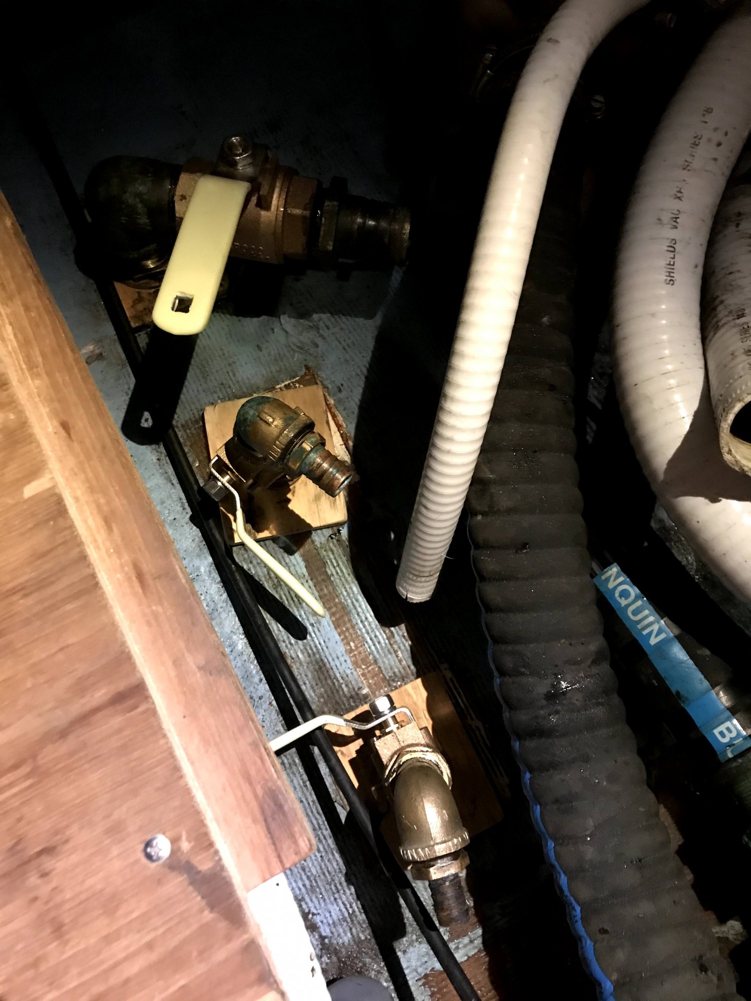

--replace all thru-hull and seacocks: I'm sure all of these are original so for a few hundred $$ I'll sleep better at night knowing they are in good condition.

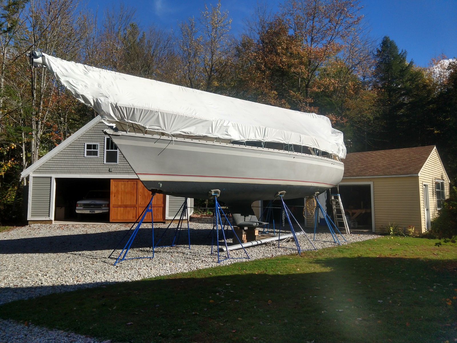

I'll be updating with some pictures and progress from time to time as slowly chip away at it. I'll be focusing on the bigger exterior projects before the cold weather hits then I'll get a heating system installed and move on to interior projects/ upgrades.
A few pictures to prove it happened!
Sep 12, 2020
15
N/A n/a Casco Bay, Maine

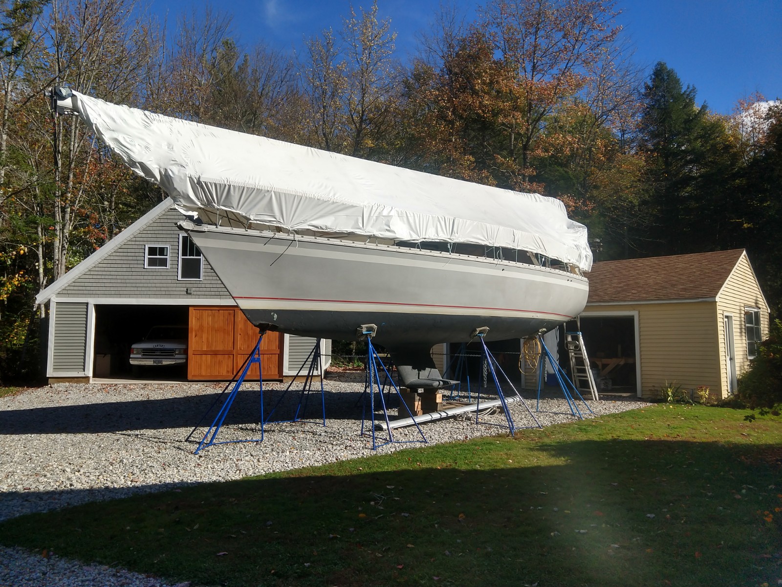

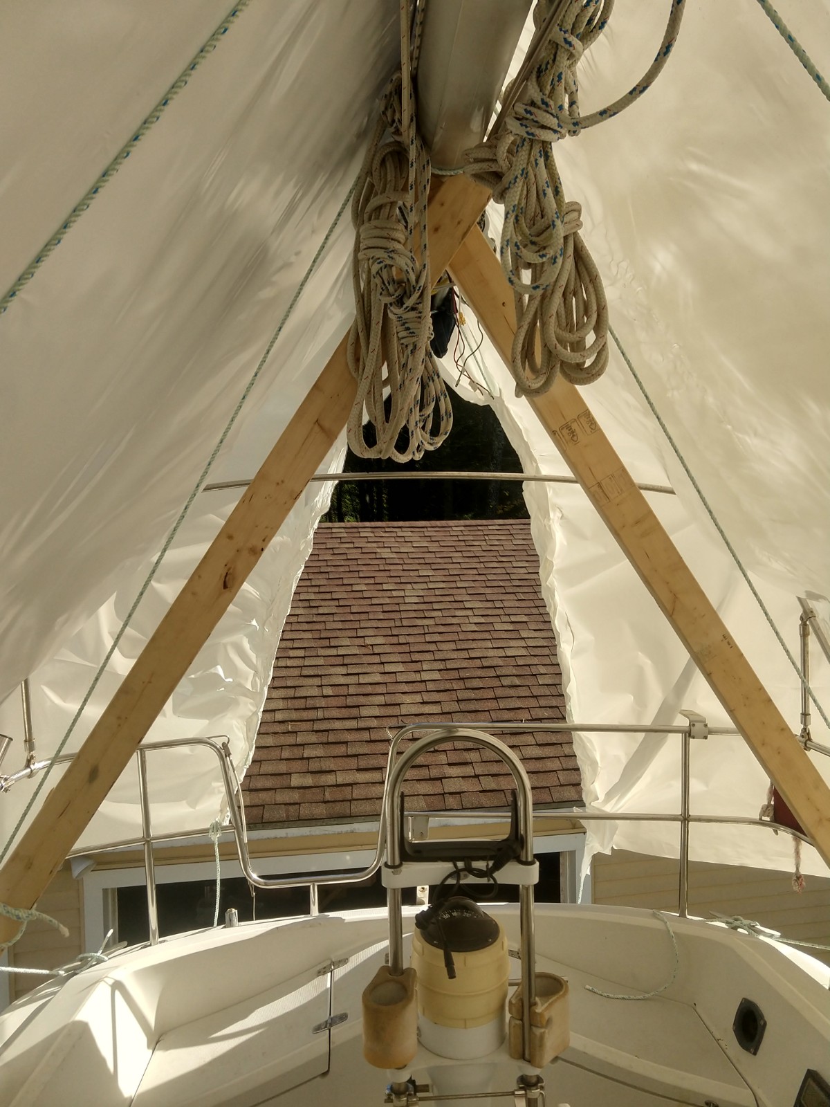

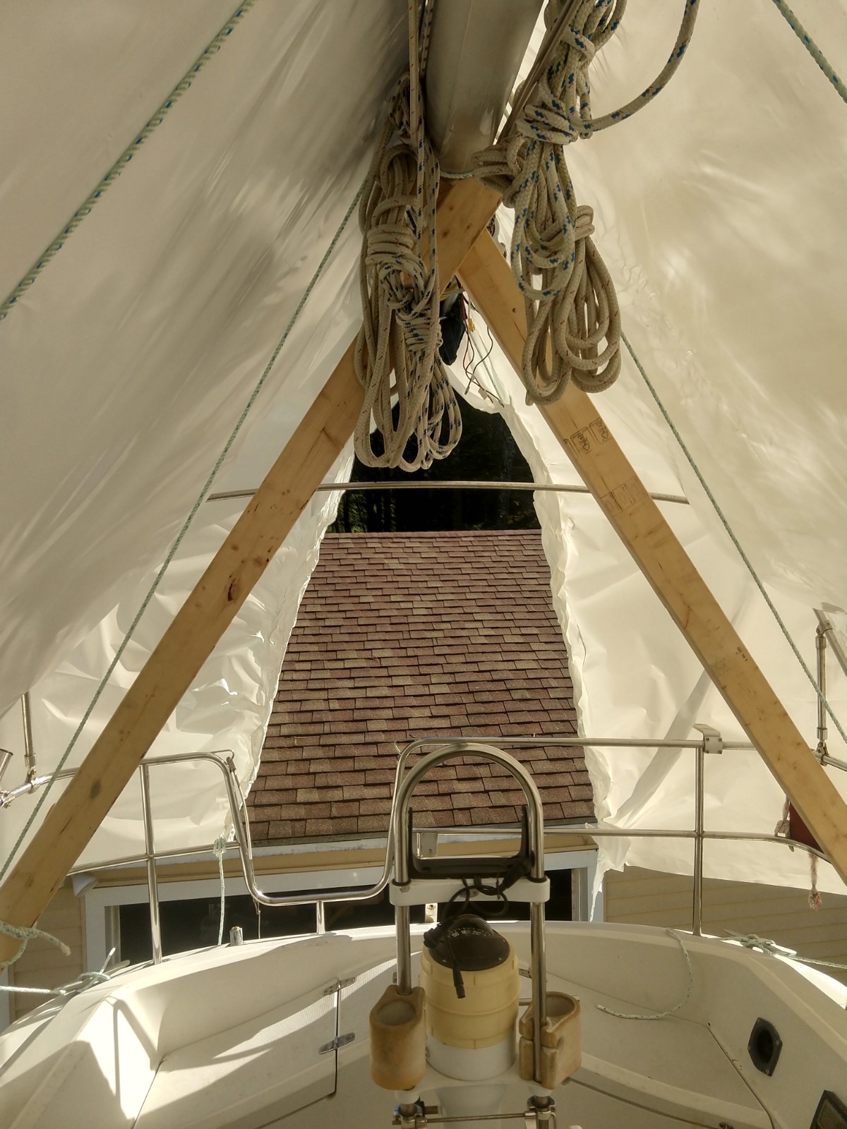

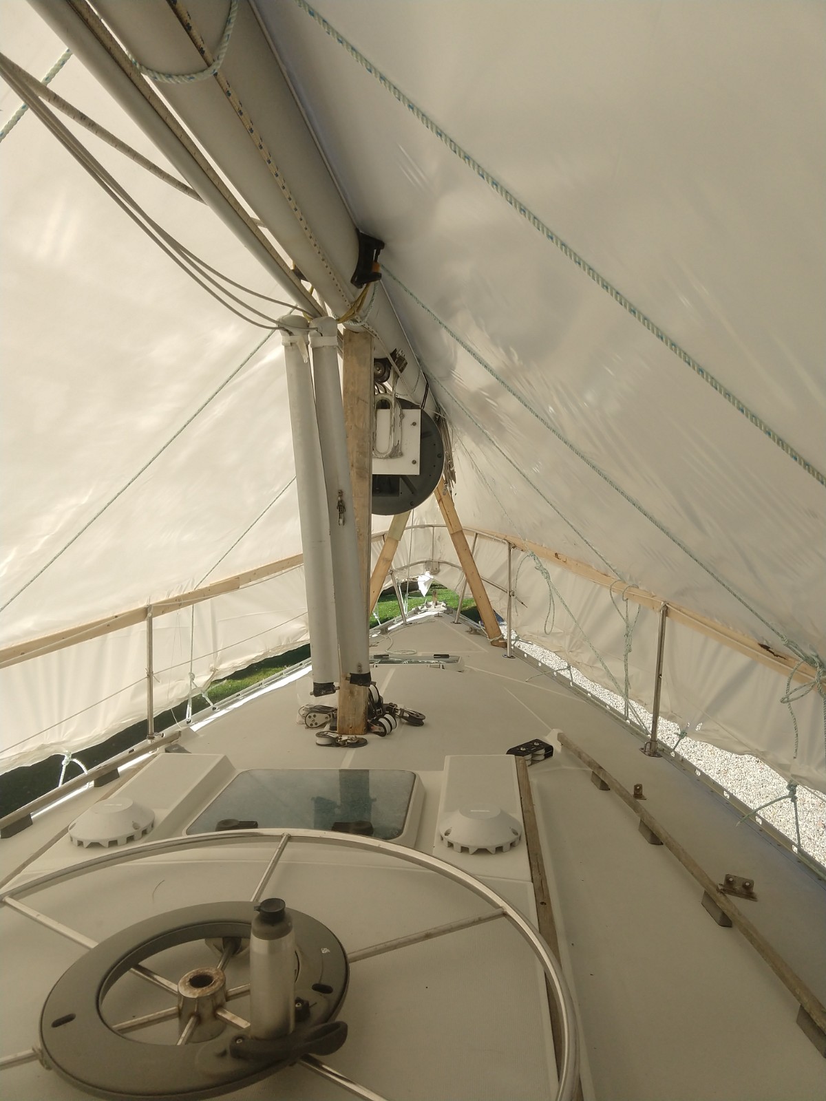

And here are a few interior pictures of the shrink wrap. Before heavy snow comes I plan to add some "crossmembers" going between each set of stanchions so there is no inward force on the posts from the snow. In the meantime it will be nice to be able to work on deck without anything in the way.

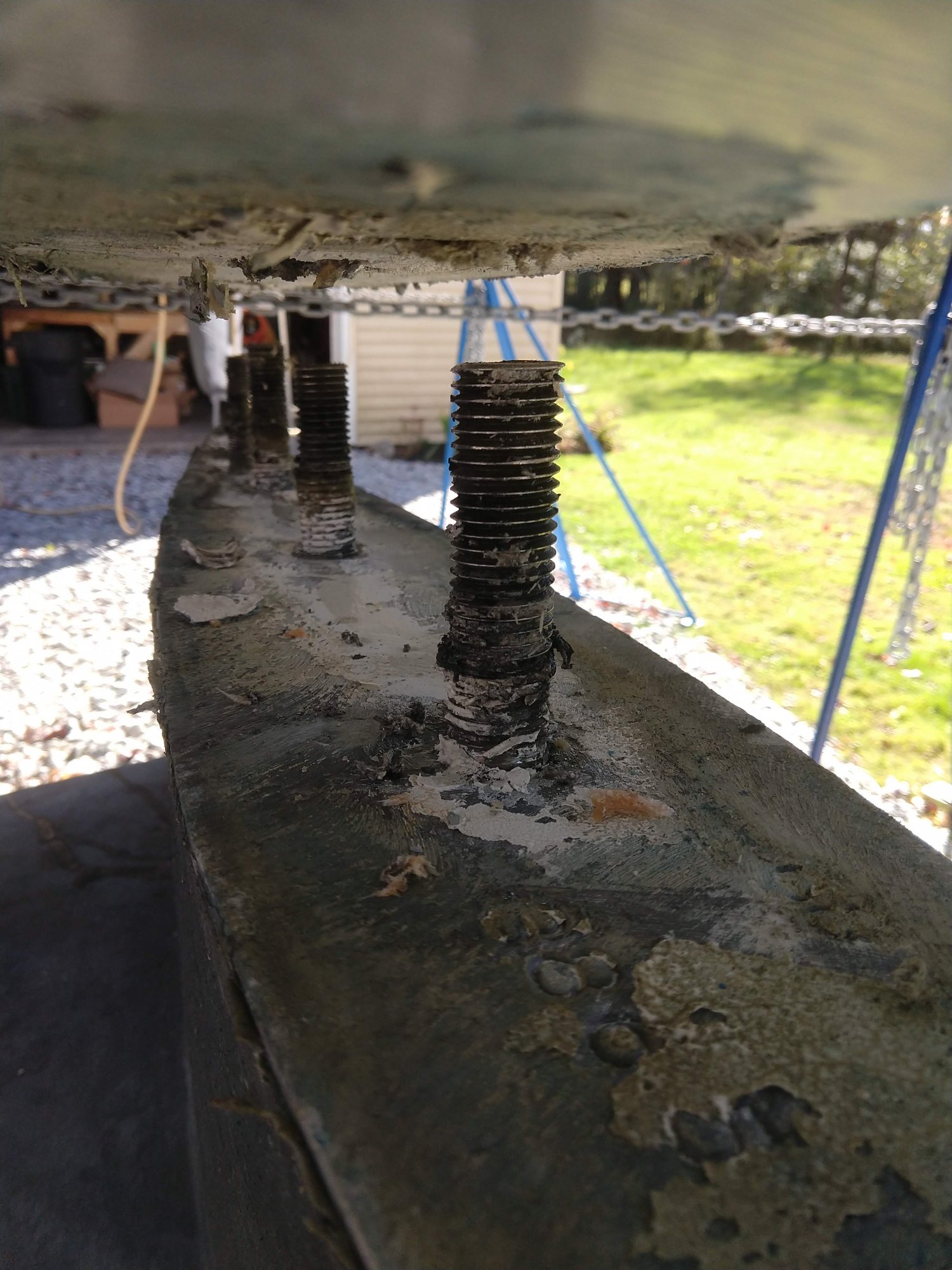

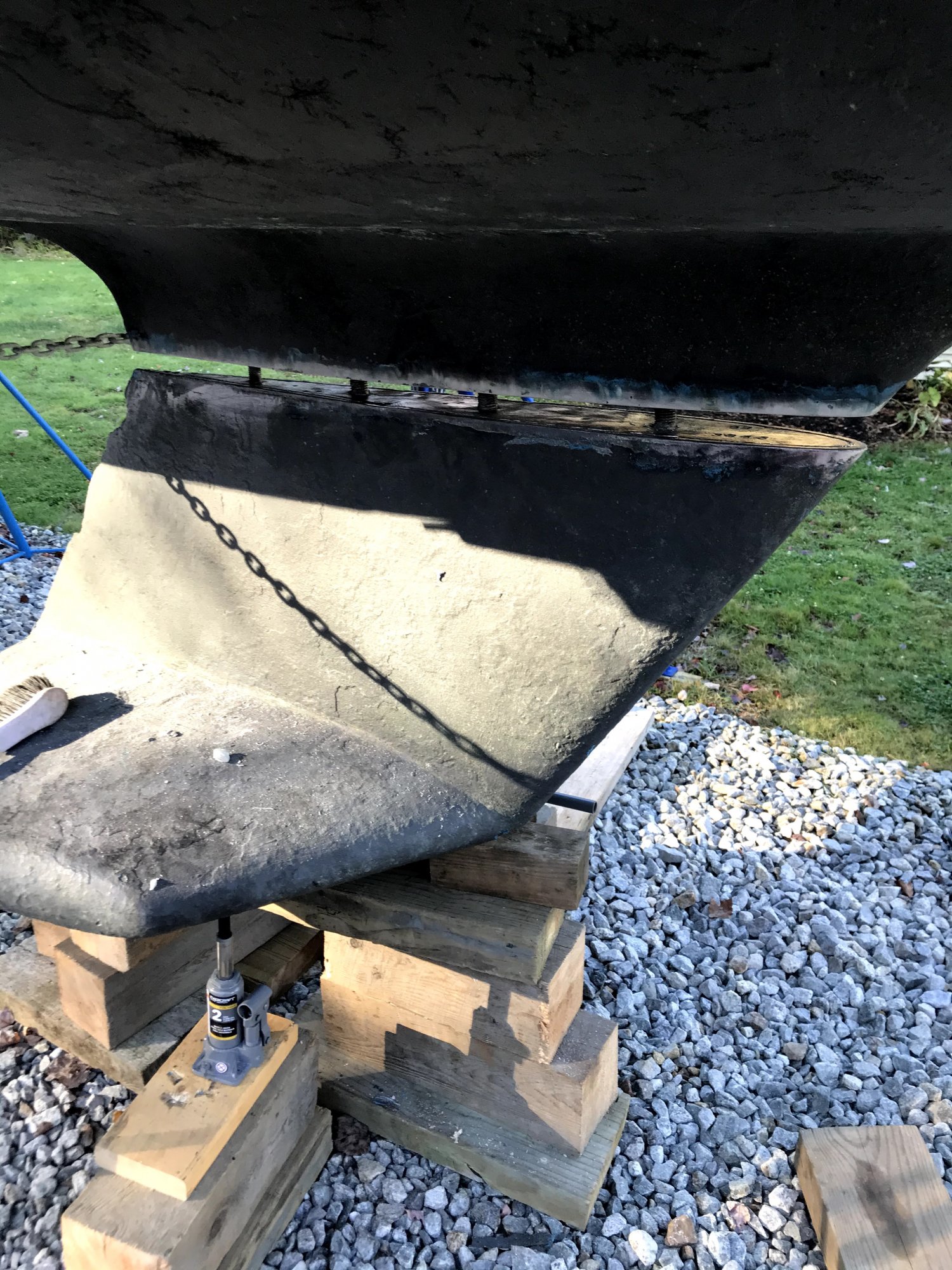

I had a pretty productive week, got the keel project finished, and got a few thru-hulls replaced as well as some deck fittings re-bedded.
Let's talk about the keel first:

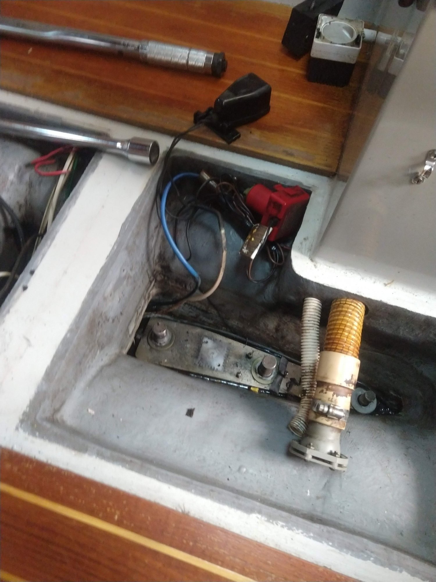

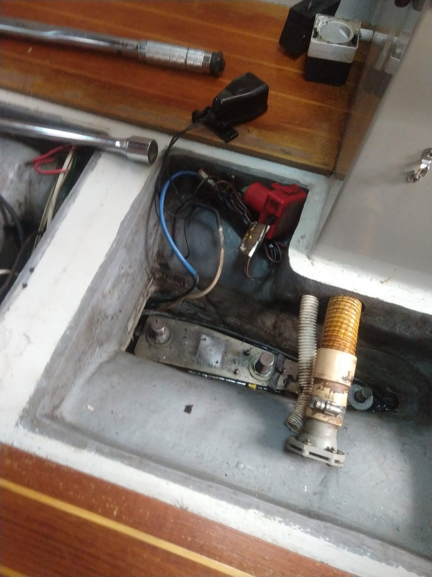

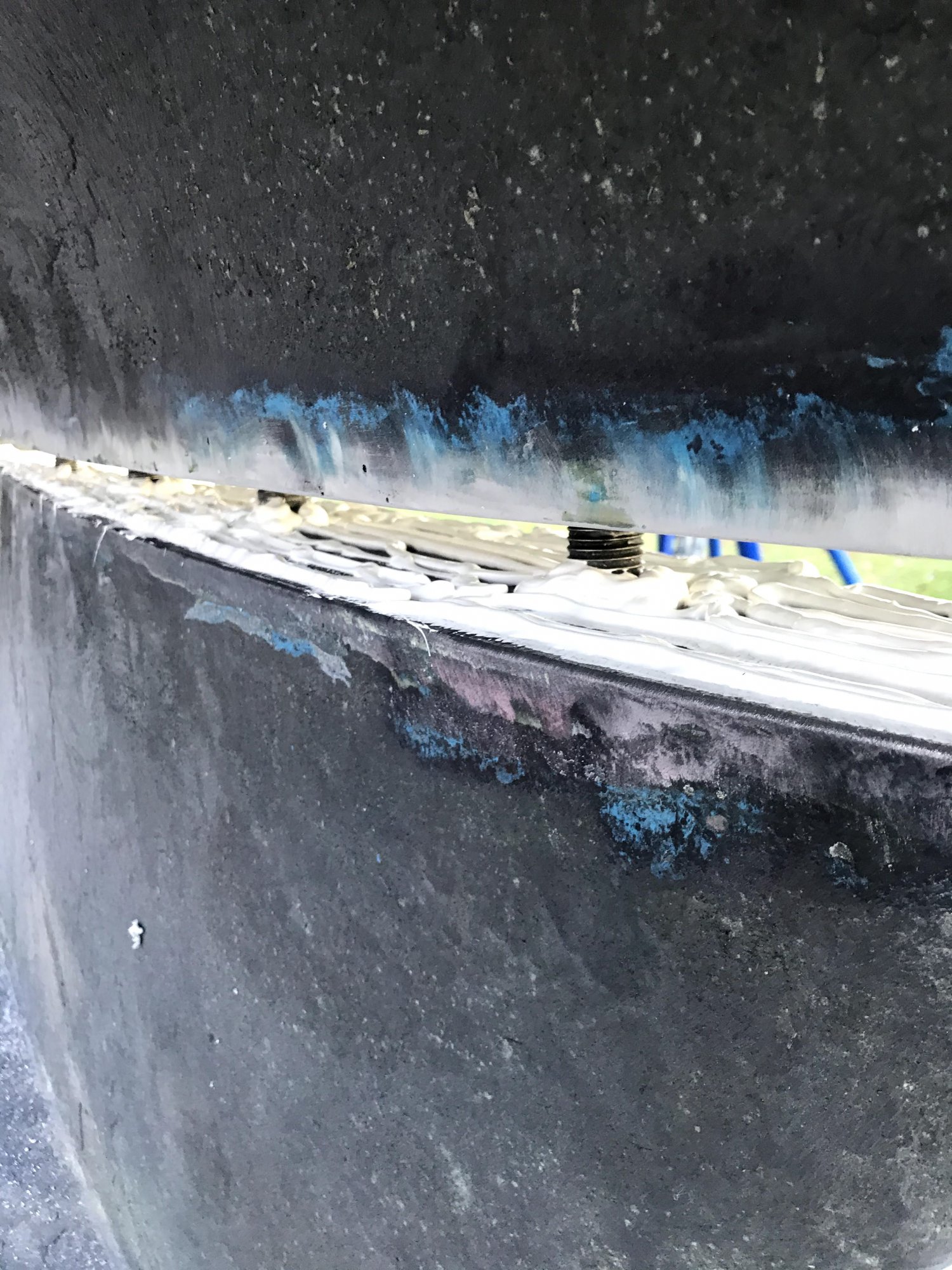

This is what I started with, the P.O. had installed this 1/2" thick backing plate under the 3 aft bolts, which I saw no reason not to re-use when I put it all back together.
Nuts off, ready to drop the keel.

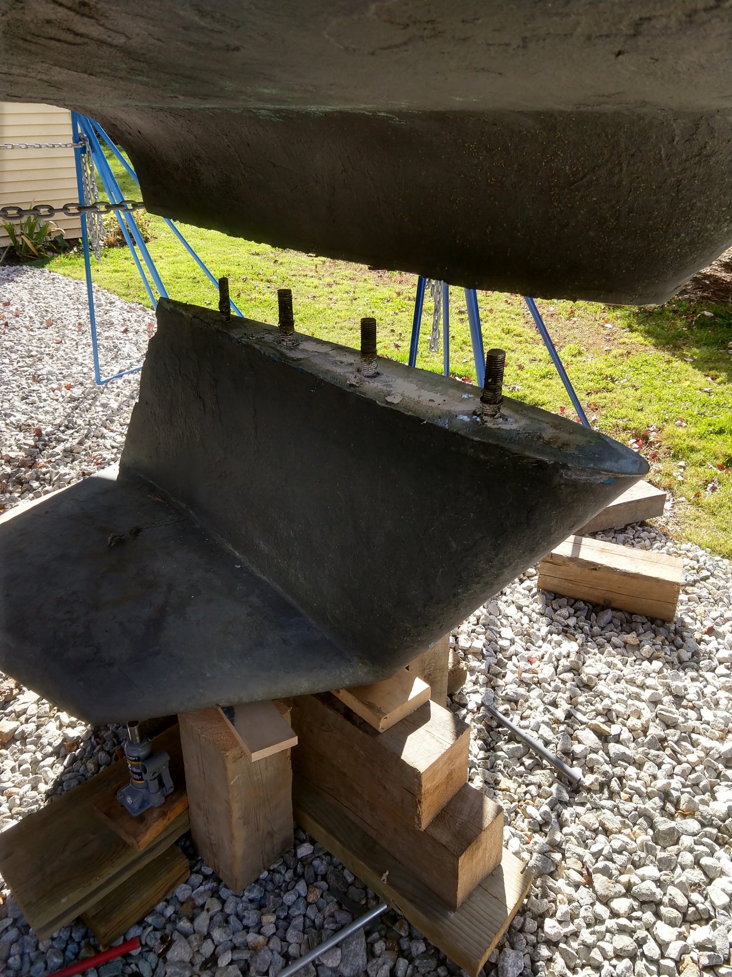

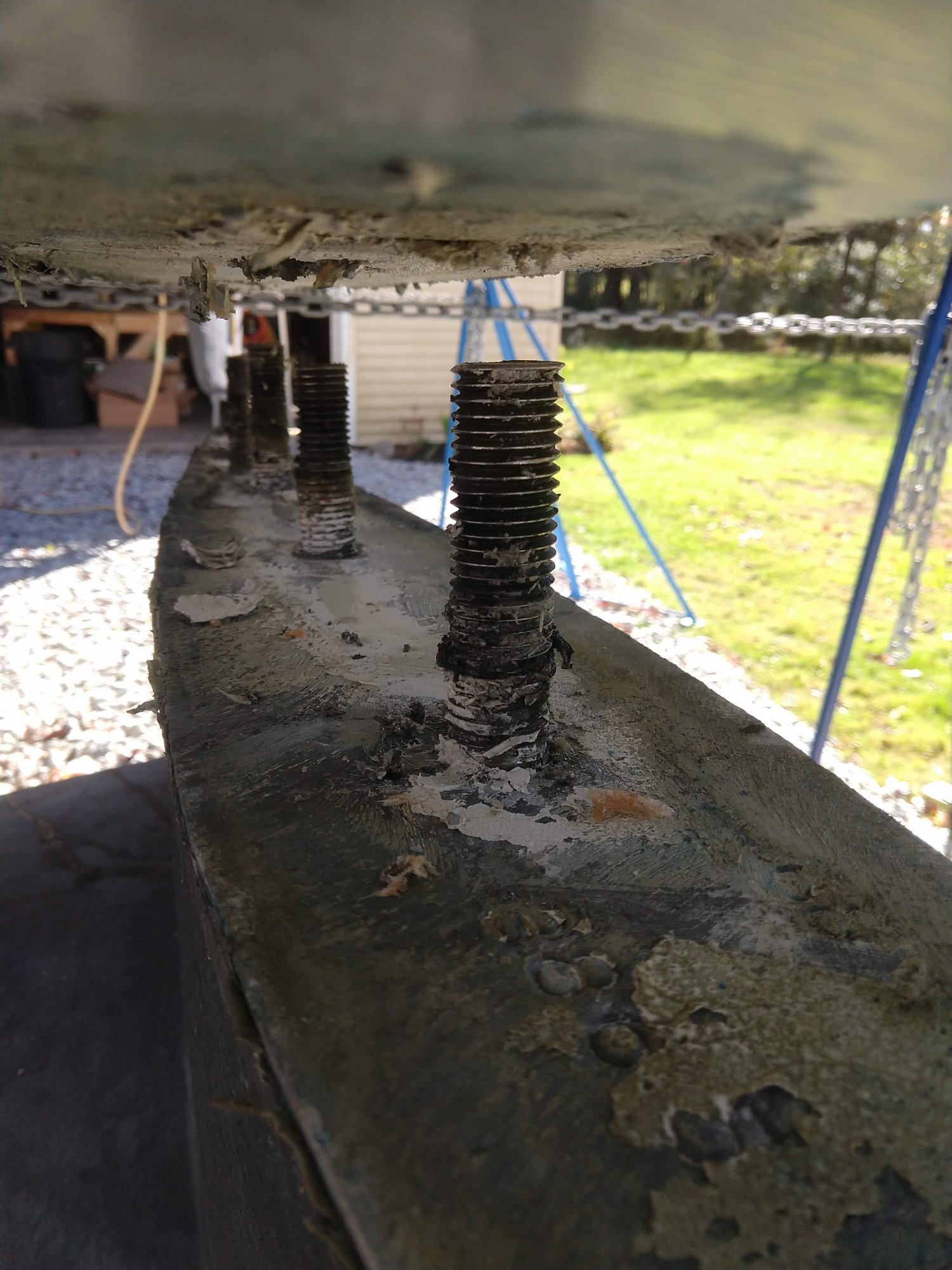

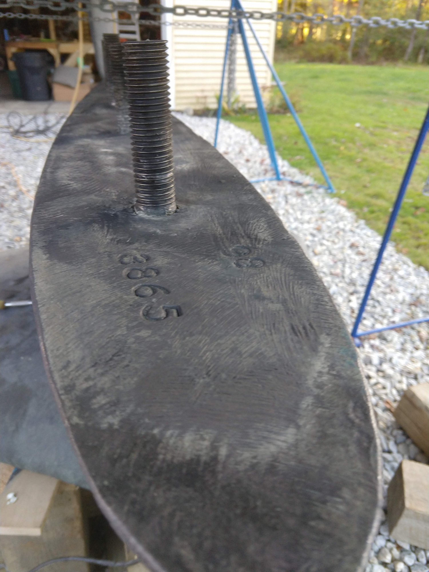

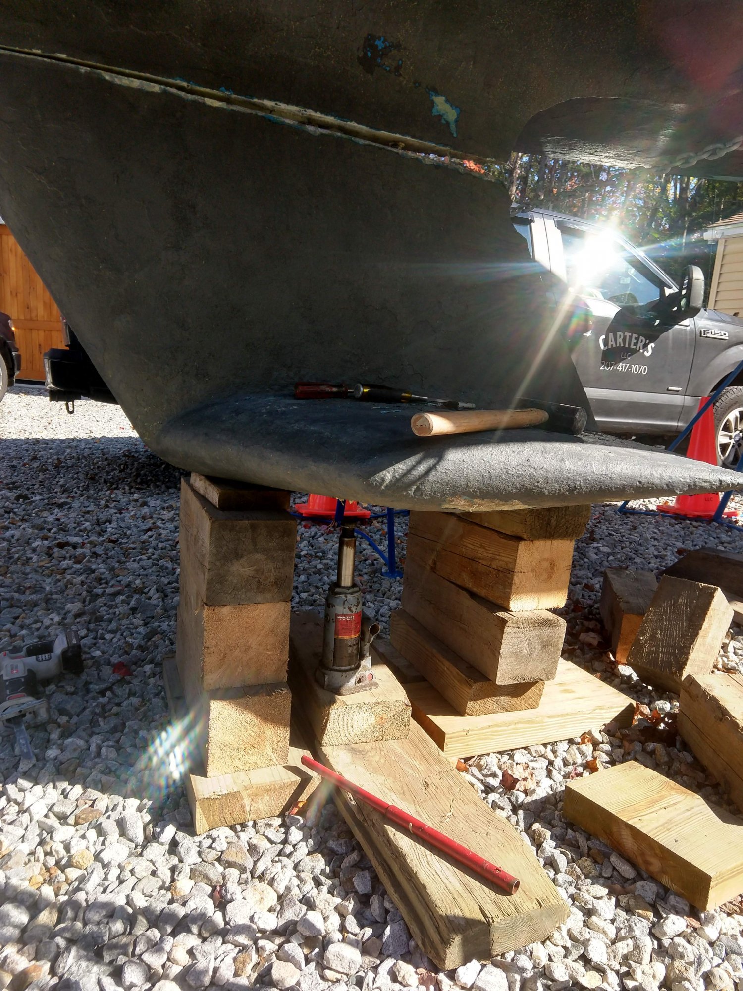

This was the fun part! Having a nice wide wing keel made lowering it with three bottle jacks a pretty painless process. I always kept the blocks within an inch of the keel, that way if something happened it didn't have far to go. I used one bottle jack at first (pretty much centered) and when the studs got close to coming out of the hull I switched over to 3 jacks, one on either side forward and a single jack centered in the back. This allowed me to lower it in a controlled fashion.

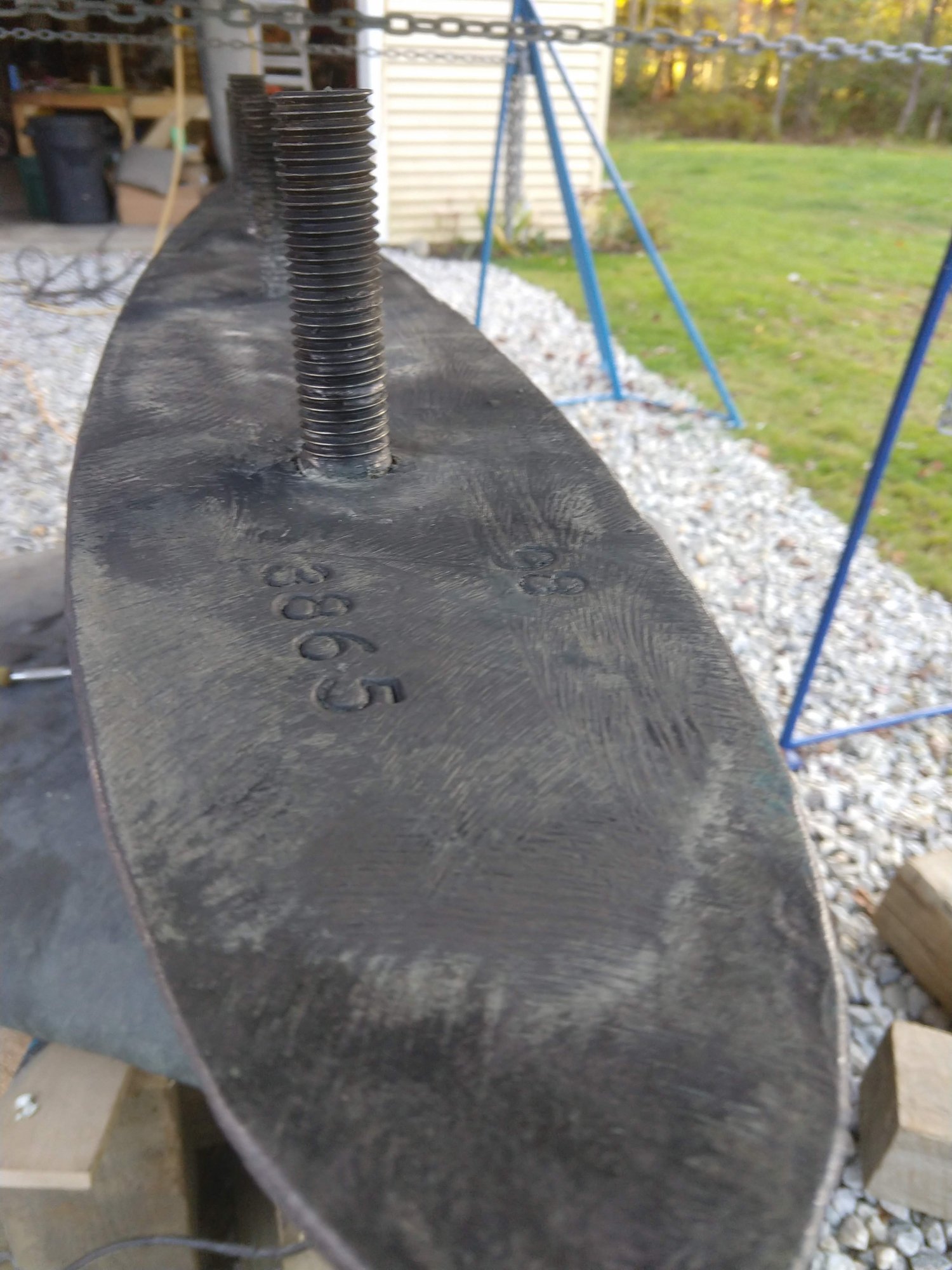

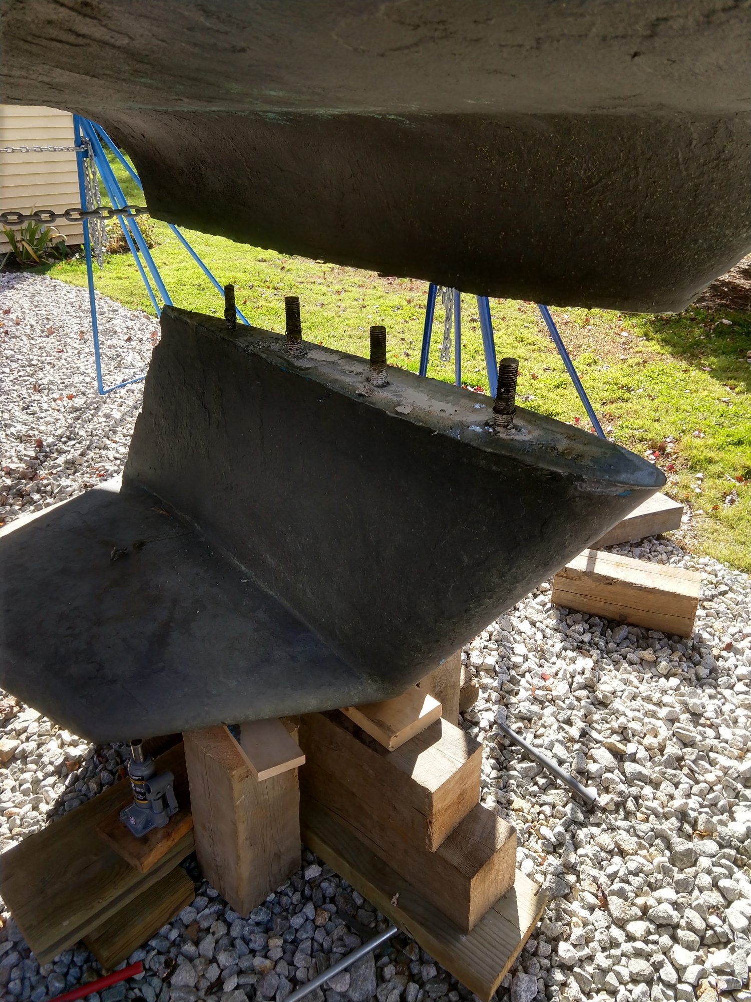

Studs are in good shape!

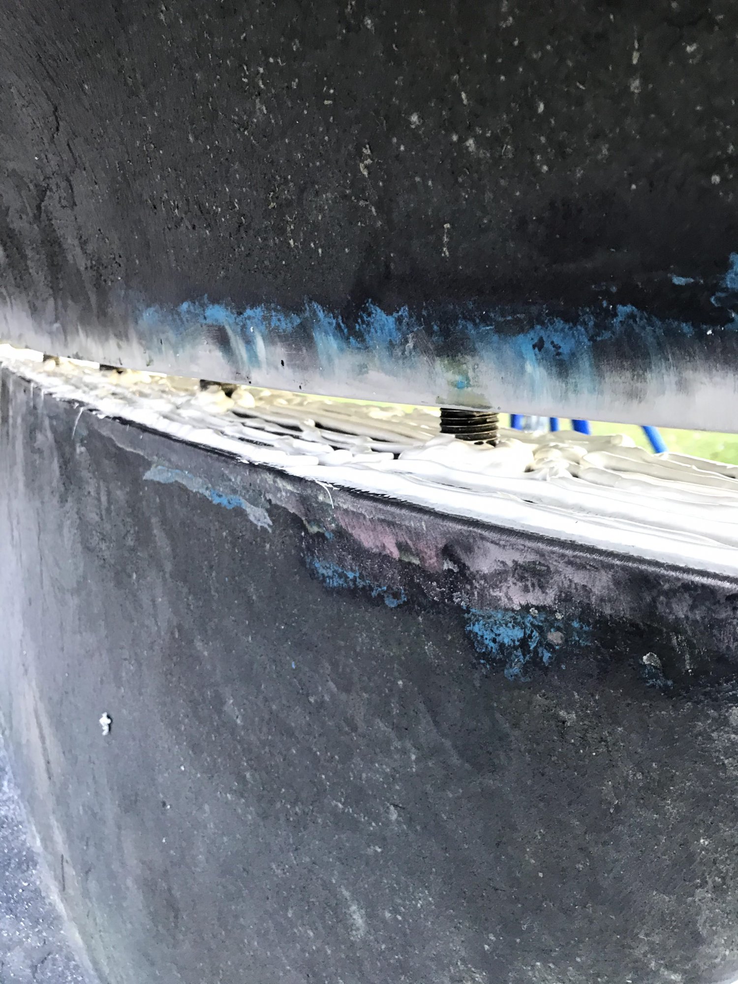

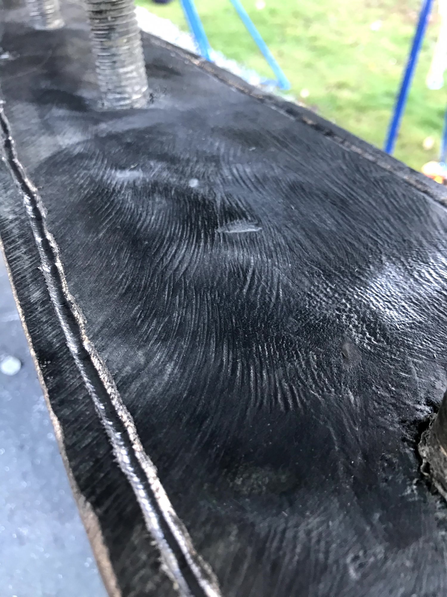

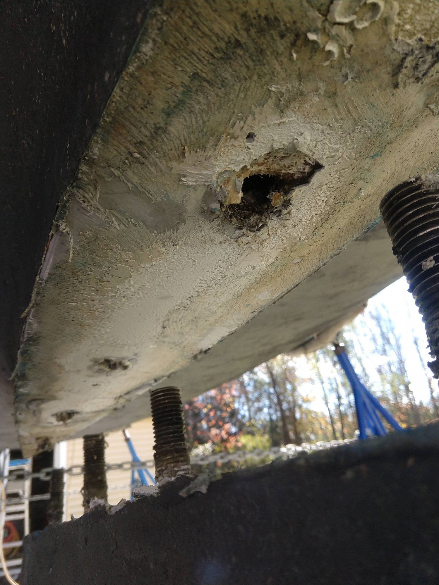

So, this is pretty interesting, if you look closely you can see that the bed of 5200 is lighter colored on the inside and darker on the outside. The darker colored stuff on the outside wasn't doing anything, no adhesion or sealing left. When I jacked the boat up off the blocks and let the jack down the keel did not want to release, it took quite a bit of motivation, wiggling, and a sawzaw blade to get it to separate, that 2" wide by 3' long bed of 5200 in the center was happily holding the 3500 lb keel and took a lot of work to get it to release. That's why I love 5200!
Lowered far enough to work and blocked well for a few days!

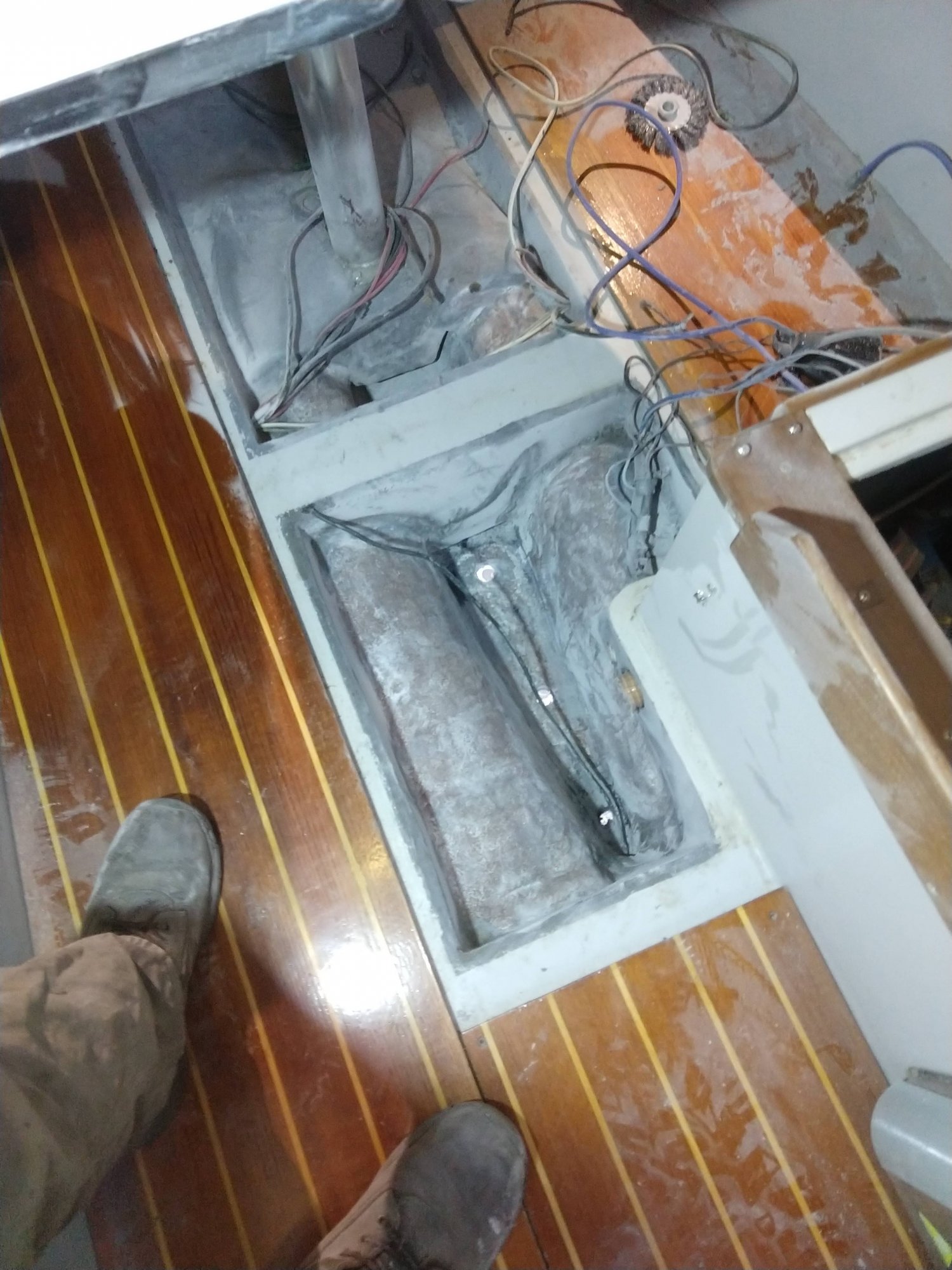

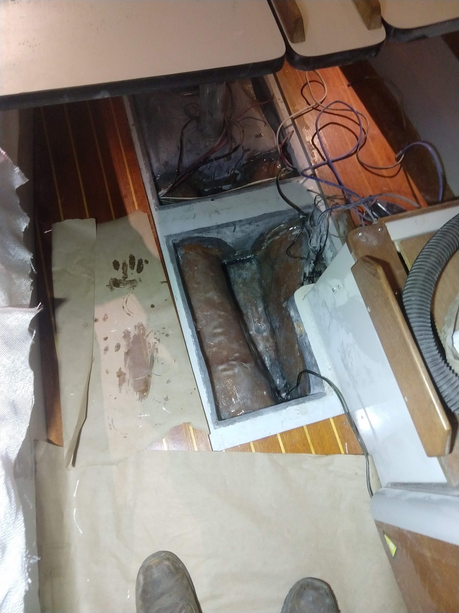

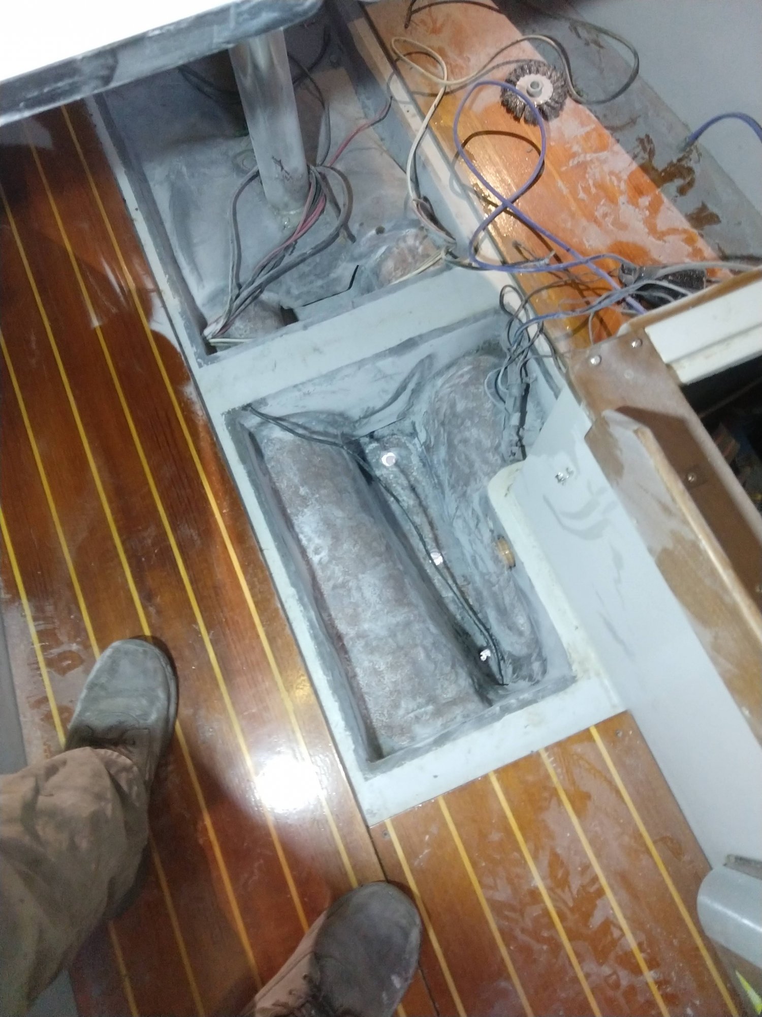

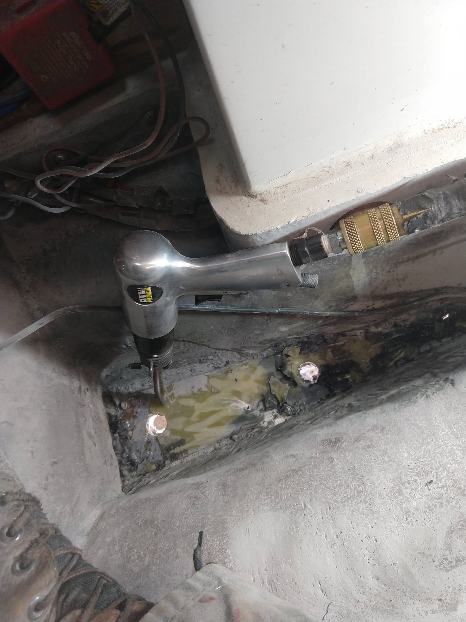

Now it was time to get to work inside. Under the 1/2" plate, the P.O. had put a nice thick bed of epoxy so that the plate was evenly distributing it's pressure. While this was a good idea, (I did the same thing upon re-installation) it was quite a pain to get all that stuff out of there.

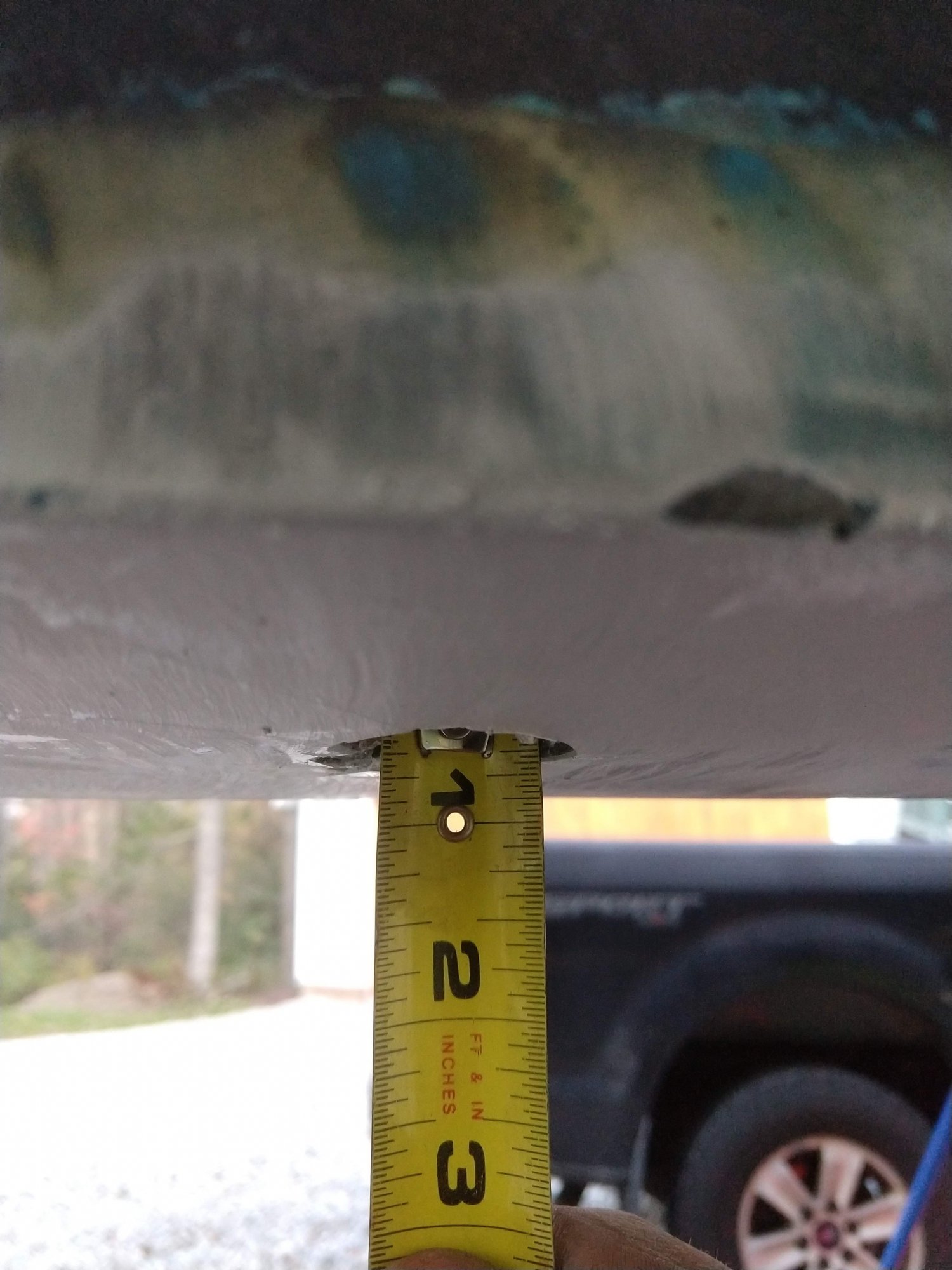

So, the big question! How thick was my keel sump? Just under 3/4". I think it's safe to say that this wasn't a "bad one", but for $100 worth of materials I decided it was worth adding a few layers of glass inside. My theory was that it was easy and cheap enough, so why not. In case anyone is wondering this boat is hull #100

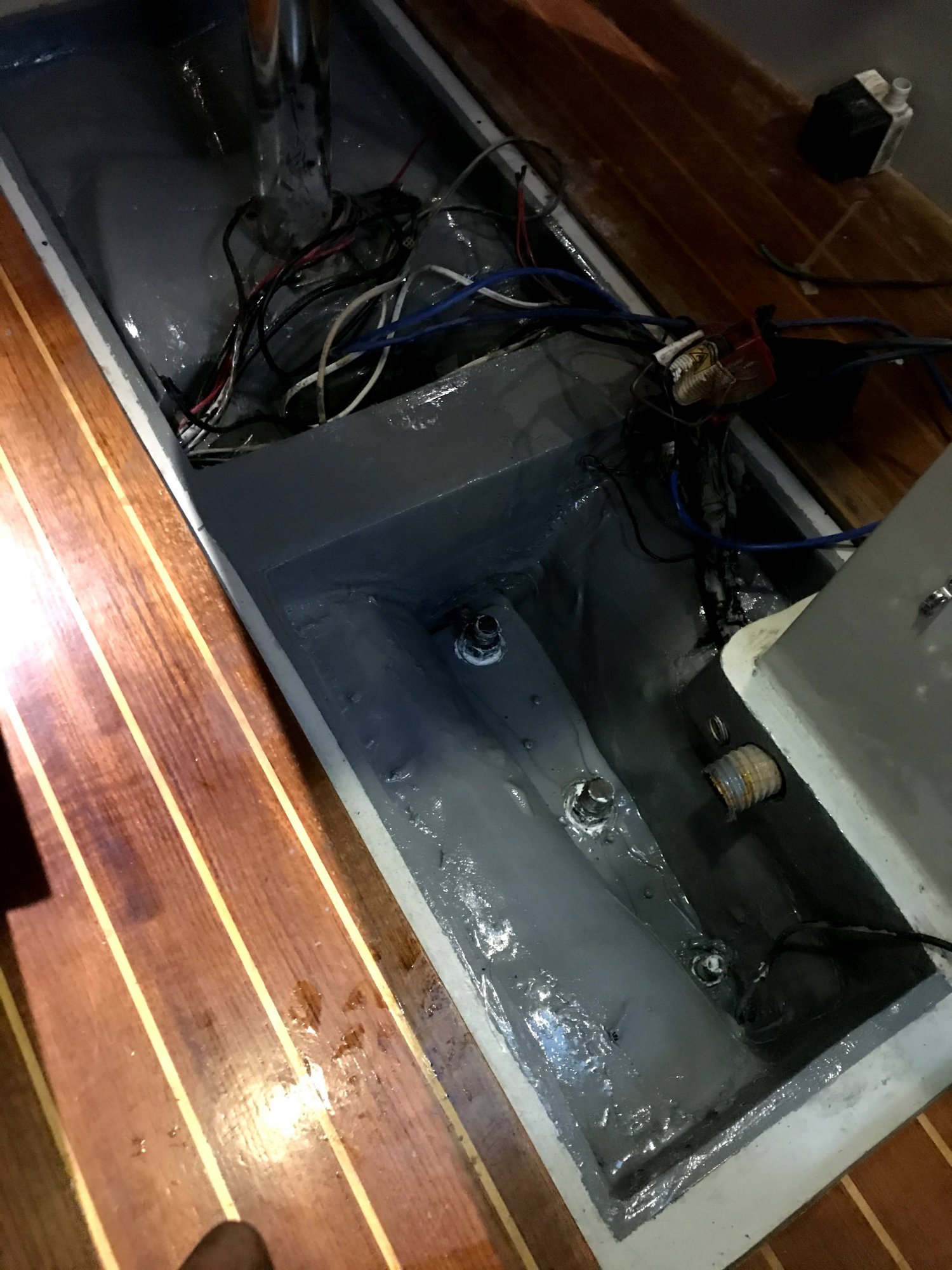

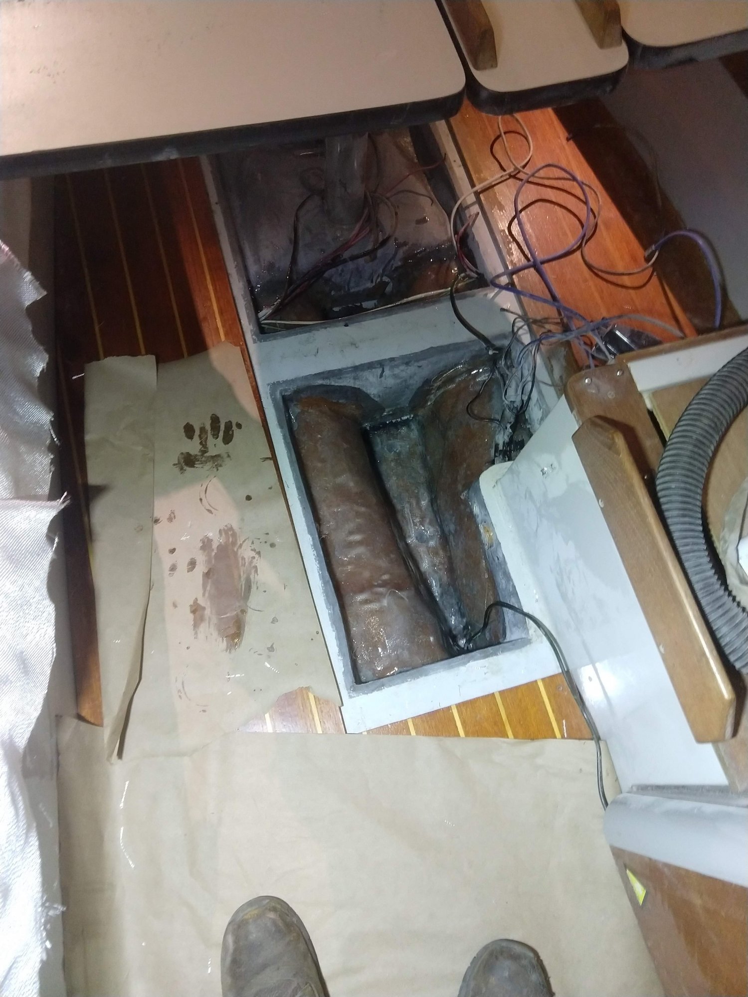

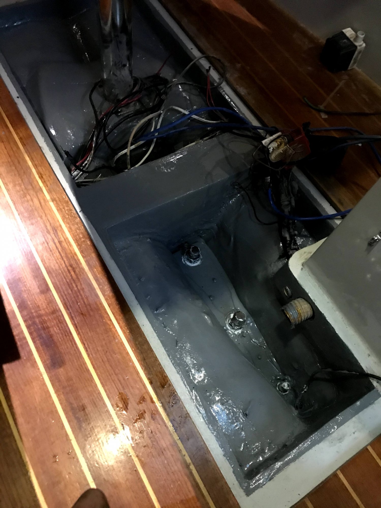

Prepped for the glass.
Keel cleaned up.
Sep 12, 2020
15
I did 4 layers of glass total. The first layer was the full width of the sump and I progressively made them smaller until the 4th layer which was about half the width. Not my prettiest glass work (didn't spend much time on trimming the glass), but it's a bilge... I didn't get any good pictures, but I also did the same thing for the forward bolt, in front of the crossmember.
I took about 10 minutes of extra time to dremel a little grove near the outside of the keel seam. I figured that this would give a good place for the 5200 to form a gasket with a little more stretch. If it doesn't work then it certainly didn't do much damage.
Going back up.
A whole tube of 5200 seemed like the perfect amount.
Bolts torqued to spec and a little grey paint to make things look somewhat presentable. The mess of wires will be dealt with later :)

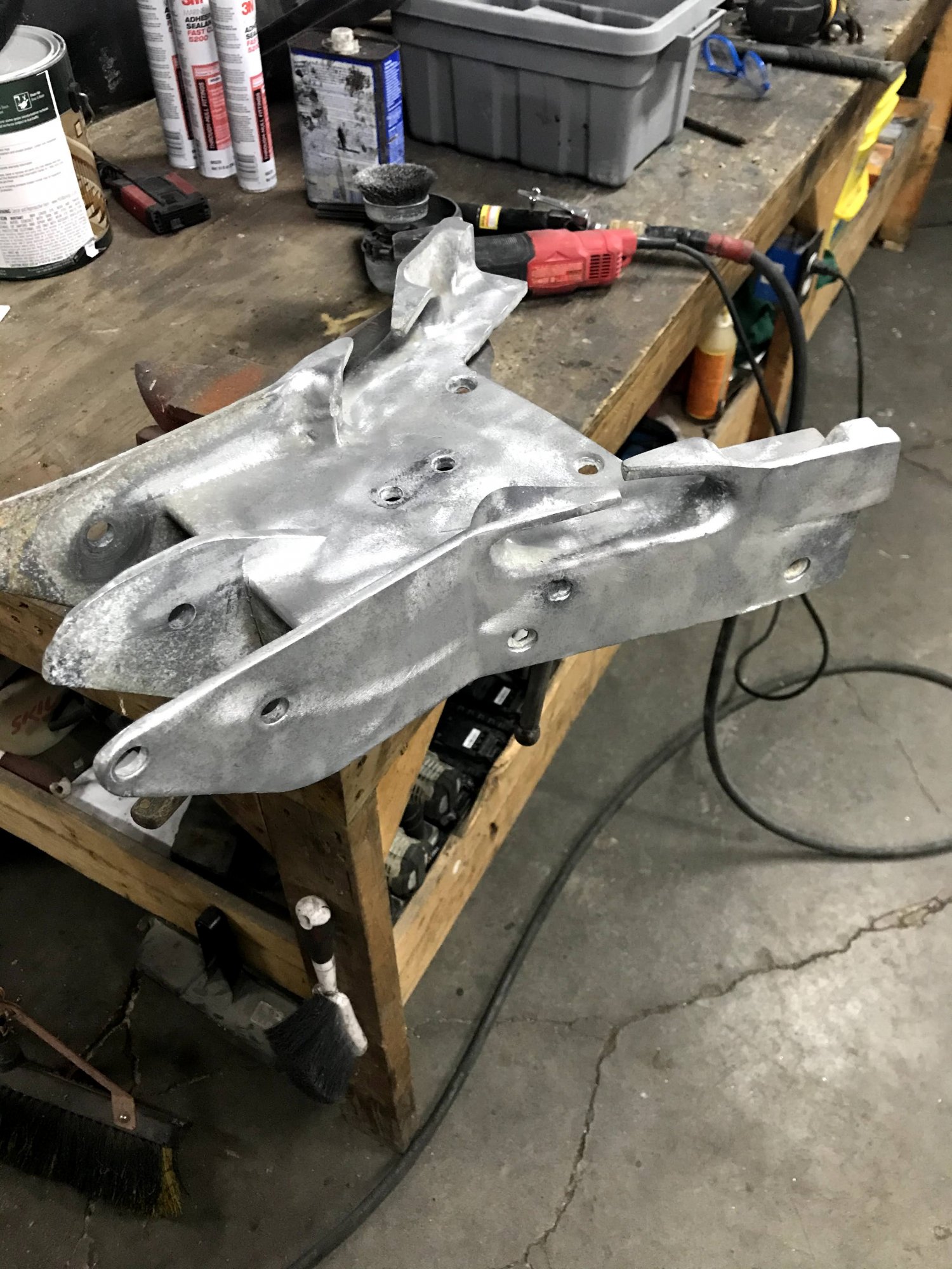

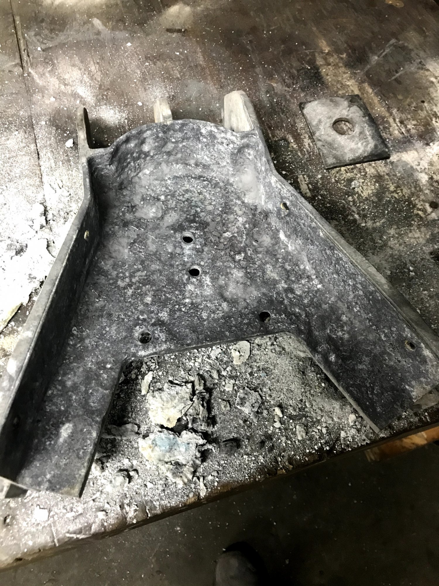

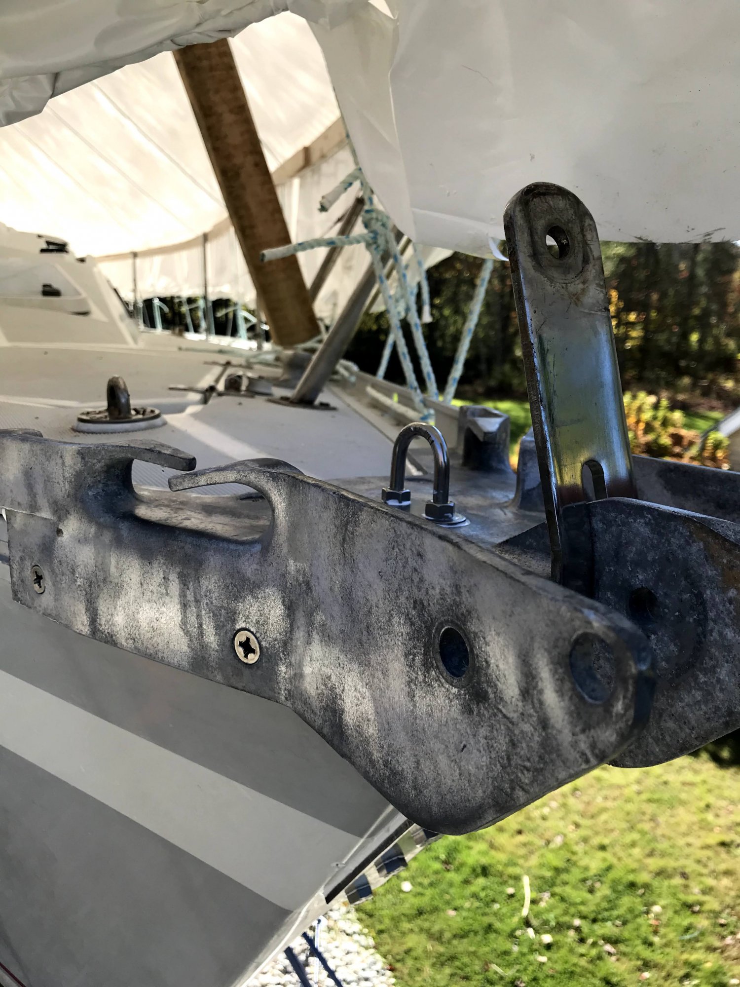

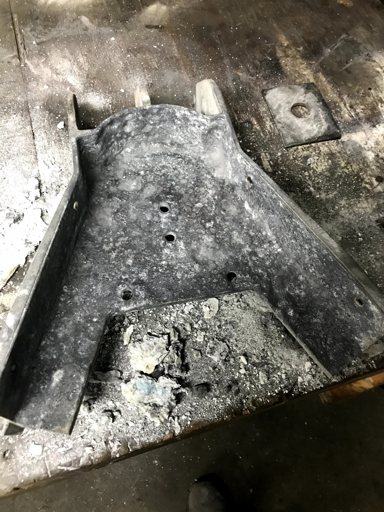

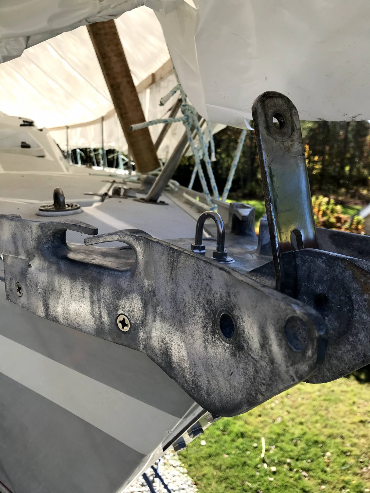

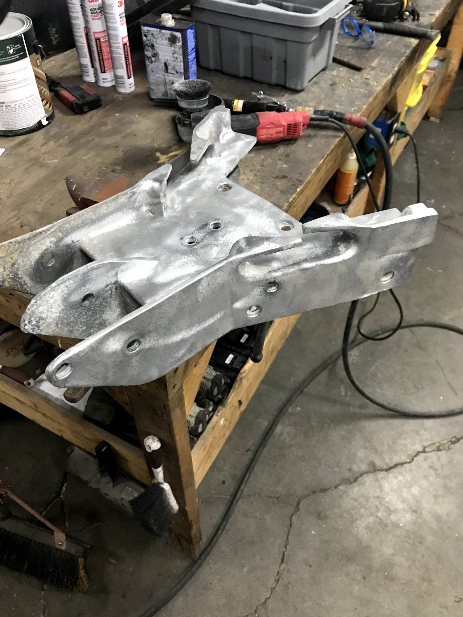

A few other projects I got done. Rebedded the bow pulpit, anchor locker hinges, and the bow roller housing.

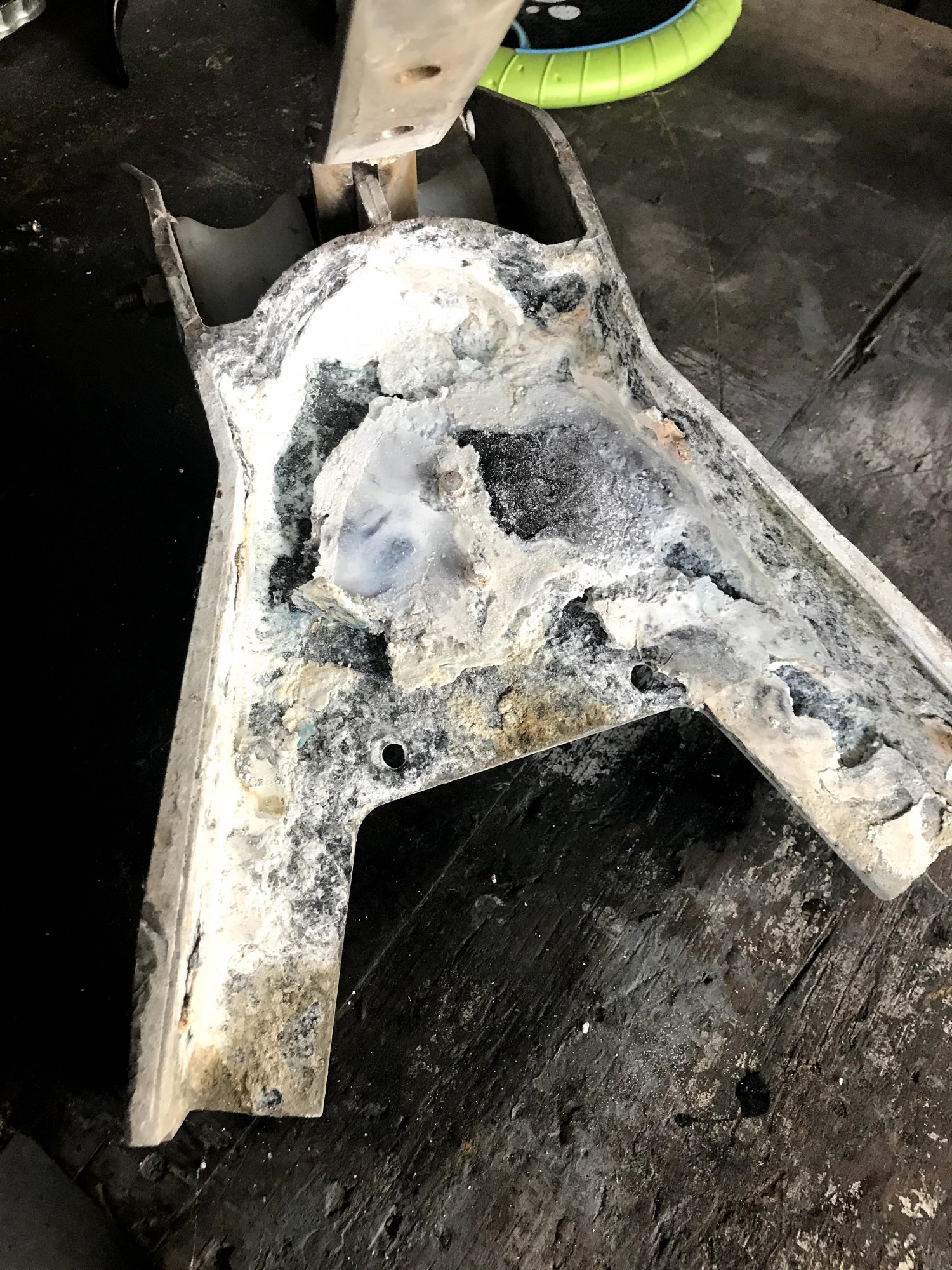

Talk about some serious corrosion! I'm not sure if this was a sub-par grade of aluminum or just a poor job sealing it but it was pretty bad. A little work with a needle scaler and it cleaned up pretty good. Seemed like there was still plenty of material left to be fine, it's also not really a structural item so I'm not too concerned.
Good as new! Well, maybe not, but it will work...
And back on. I also rebedded the chainplate while I was there with some new bolts. I'm glad I won't be doing this again any time soon (or ever) as these were some seriously difficult to reach bolts on the inside.

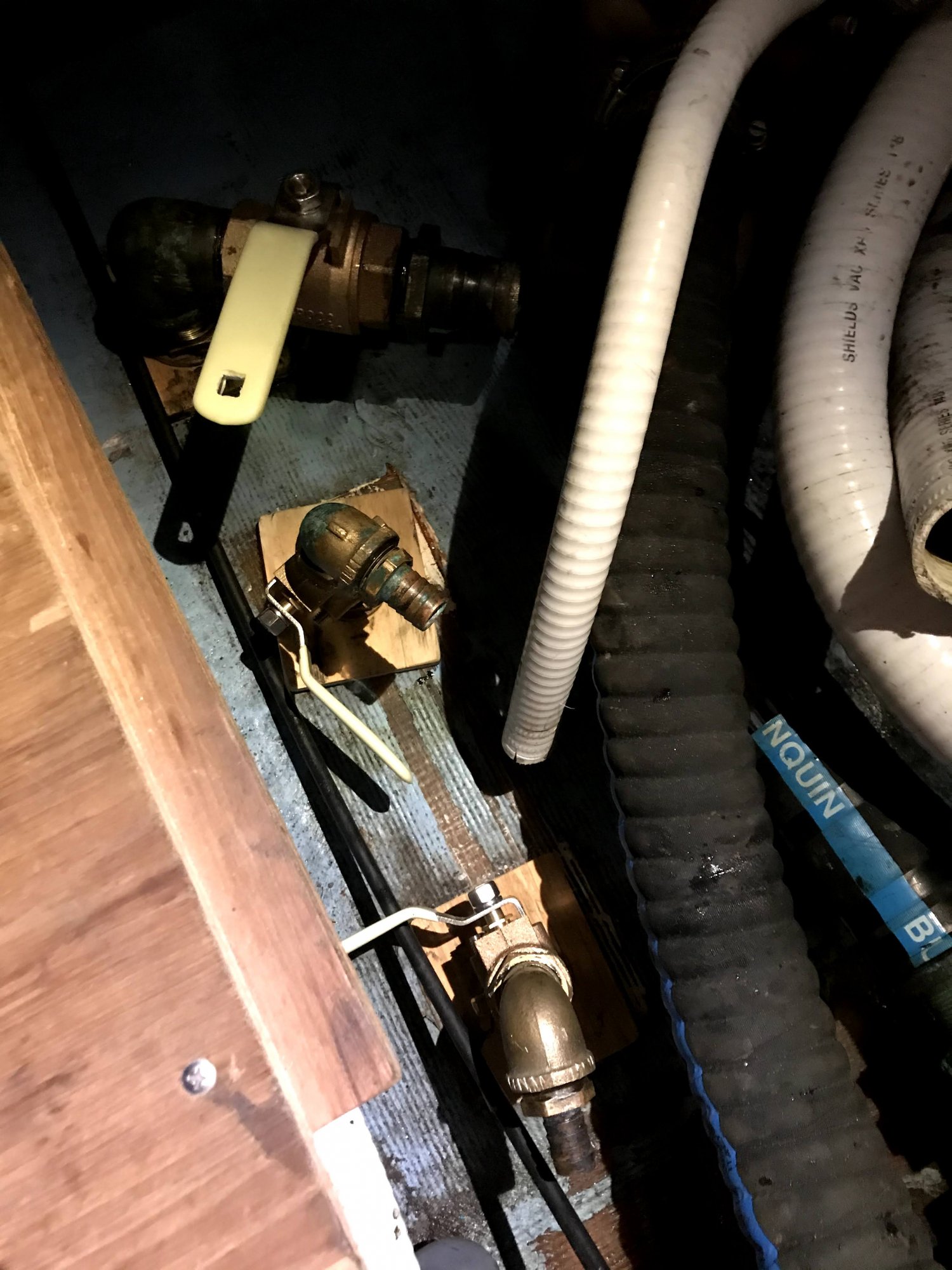

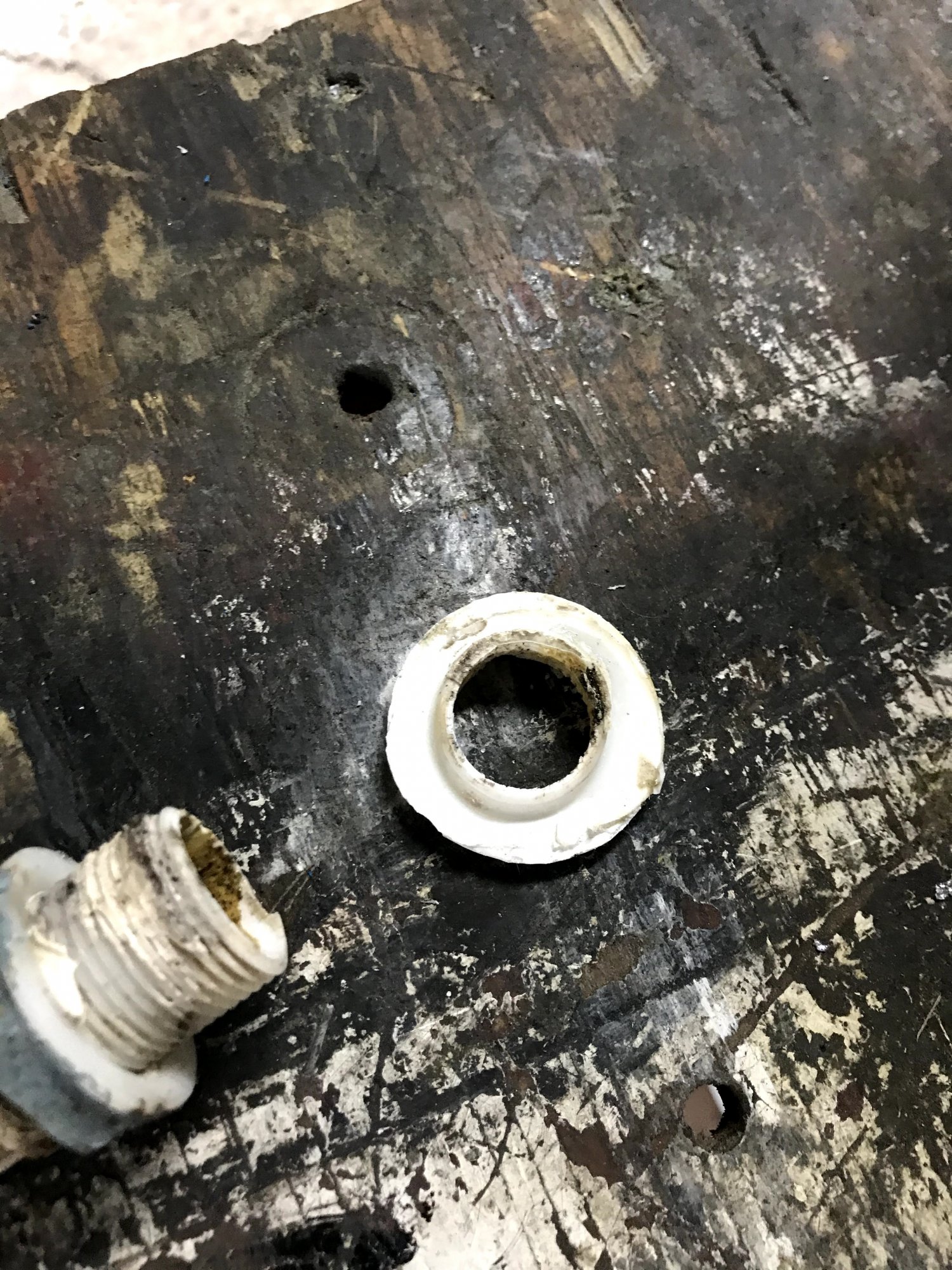

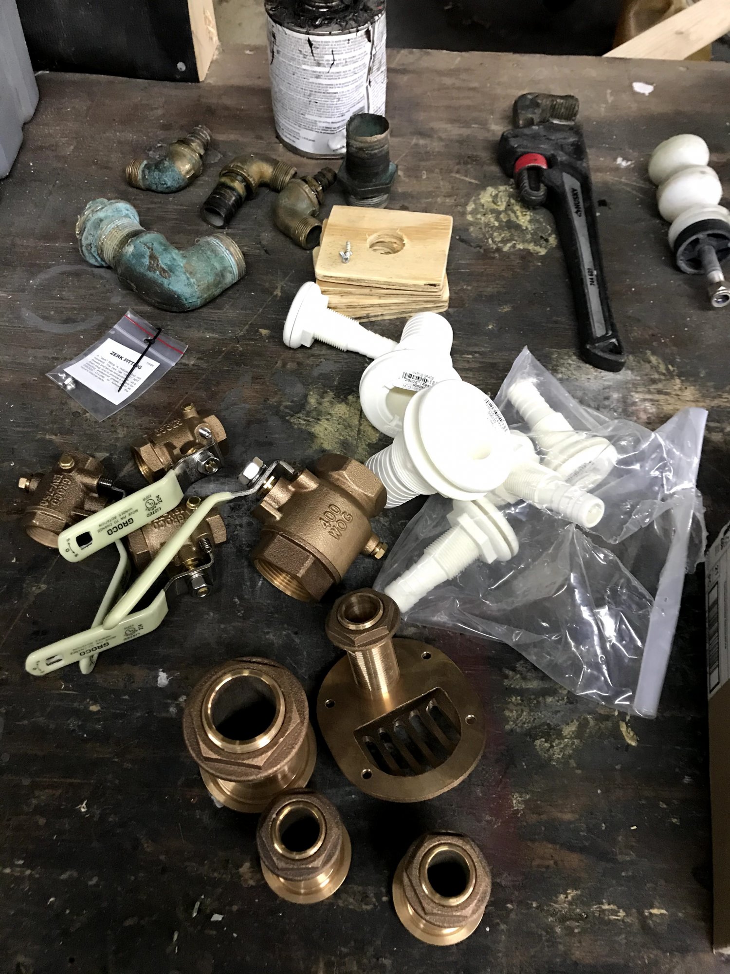

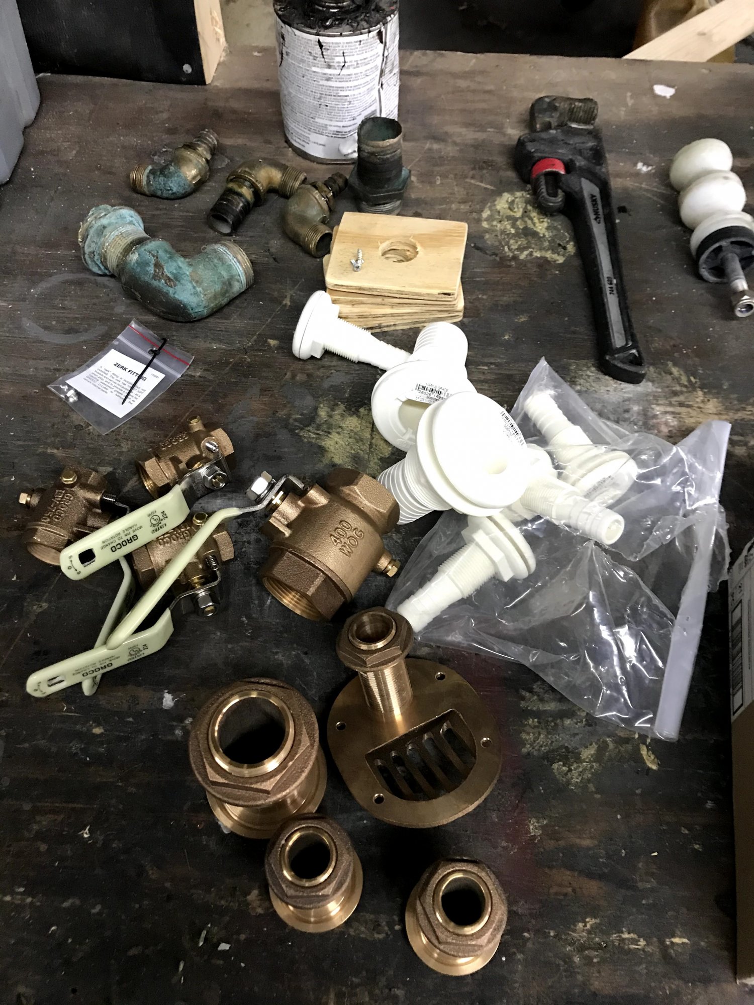

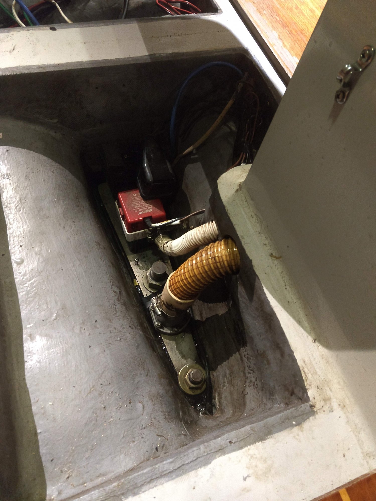

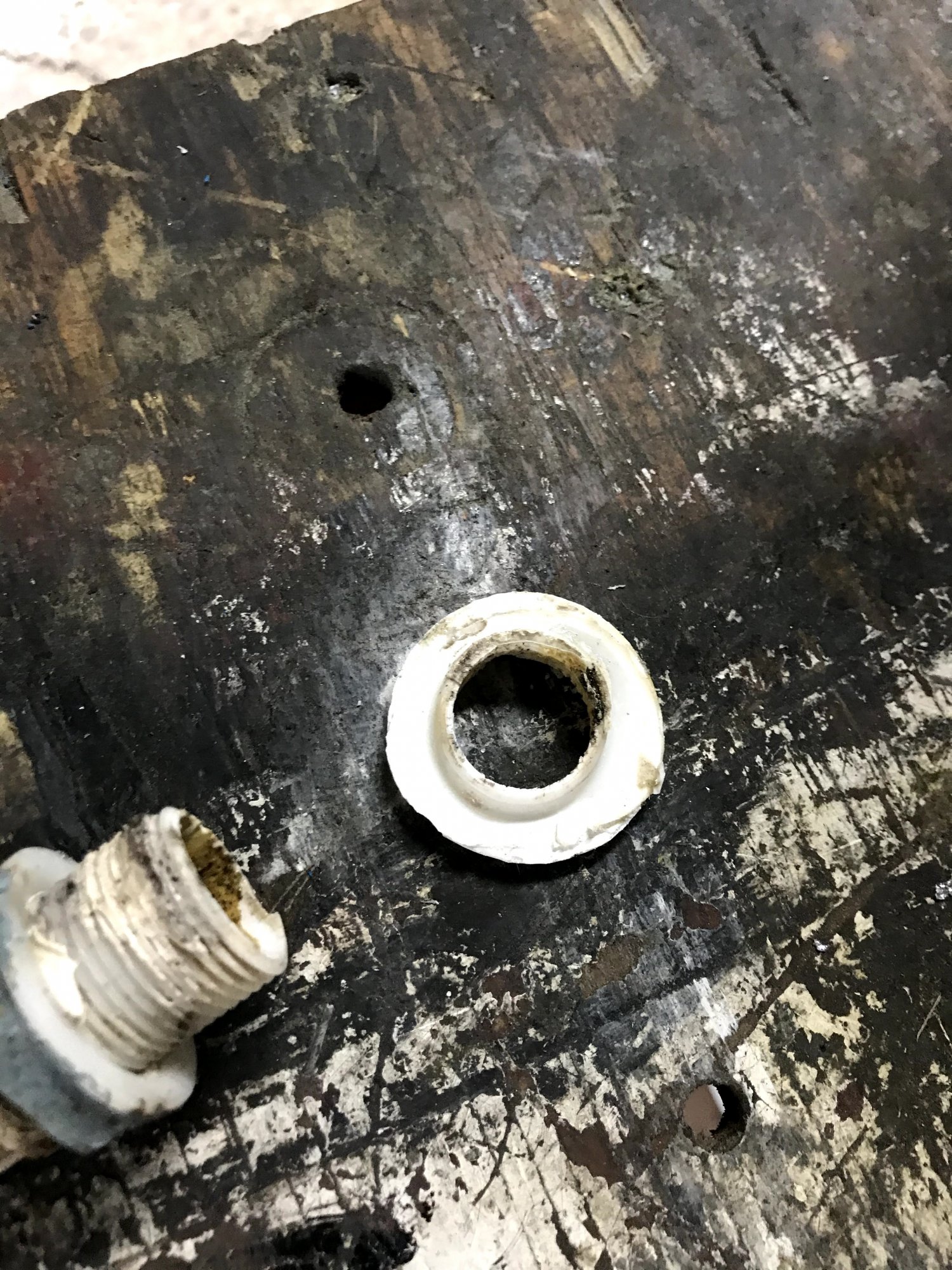

I also got all of my below-the-water thru-hulls replaced and did most of the above-the-water ones. Still have the 3x 5/8" to do because my supplier was out of stock. Groco bronze thru-hull and valves below the water and marlon above the waterline. I have no reason to believe any of these weren't original. All 4 of the below waterline bronze thru-hull were in perfect condition and probably would have lasted another 30+ years without issues. However the plastic thru-hulls above the water, especially the ones that get a lot of sun were in pretty bad shape and took very little effort to break off.
The scariest one was the bilge pump, which if your familiar with the 322, is mounted on the transom and gets the most sun. When I stuck the drill on the hose clamp to remove it, the thru hull just busted off from the inside. The sun had completely deteriorated the outer flange of the thru hull and the sealant was the only thing holding it in. So probably less than 1LB of force broke it off. Pretty scary considering it was for the bilge pump and pretty close to the waterline... Look at the second picture below to see what I'm talking about.

That was a productive week! Nice work on the keel - 3/4" thickness is not one of the bad ones but always good to add more.

Mr Carter,
Thank you so much for your extensive photos on your project. What an excellent job !
It is clear you are a fearless and accomplished DIY'er !
Look at those keel bolts, like brand new! Excellent. That must make you feel good. Obviously that 5200 caulking kept the sea at bay for 32 years. Nice fiberglass enhancement job also. Good for another 32 years.
Yes, my stern bilge through-hull was the same, falling apart from sun damage. only the lifecaulk was holding the tube in place on the hull. Scary. I replaced it with a new plastic one , Good for another 10 years. But - I which i had replaced with a bronze one. Next time.
All my bronze through hulls are also working well after 32 years, but I do lube them annually.
