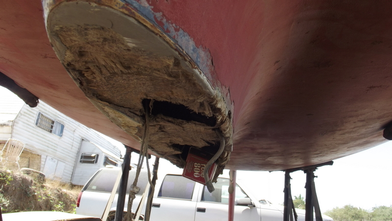

I guess I should of explained a little more. Looking at buying this boat. It's sitting in storage in Mexico. Had a look at it. No hull damage but missing the keel. Sitting at auto dealers lot. was taken in on trade. Unknown where keel ended up. Price seems okay. Motor is very clean looking and interior seems fine, just needs a good cleaning. Thought I'd first check out in keel availability and costs.

I wouldn't take that wreck if it came with a gold plated cadillac for free.

This model was known for dropping it's keel. Happened to someone in my club. I'm sure there's a thread in this forum somewhere @ some time.

I know where you can find one...at the bottom of the ocean wherever that boat last sailed. You need to rebuild the keel stub...it's not supposed to have two gaping holes in it...then find a keel. Shipping a Mars keel from Canada to PVR plus the cost would be prohibitive.
If you are handy (and desperate to try something) you could cast one out of concrete. Build a mold, put some scrap metal in it for increased weight, and stick some keel bolts in the top and viola! In Mexico you likely have some skilled masons around to take advantage of. Do yourself a favor and skip the wings. Just build a fin keel and keep it simple. You will need it to be much thicker in profile as concrete weighs much less than lead. To get an idea of the profile, glue a bunch of styrofoam blocks together and then shape it with a bread knife and one of those bondo graters.

Holy ^%#$&^% That is the same boat as the one Maine took the picture of !!! Look at the holes and the remnants of the bonding/bedding material on the left side of the hole.. The shape of that fracture line is the same !! There is a little distortion because of the camera angle, but that keel attachment failure looks identical.. How did it get to Mexico from Portland?

I don't know if the O'day had a lead keel or not. I am guessing that they did. This may be the reason that it is missing. Scrap lead was selliung for about 50cents a pound no too long ago.
I seriously doubt you could get a keel cast for the value of this boat.

OMG that boat is not just missing a keel! It was ripped off! the 322's had a lead wing keel that was 52" wide. There's one in my YC the owner takes care of it.
