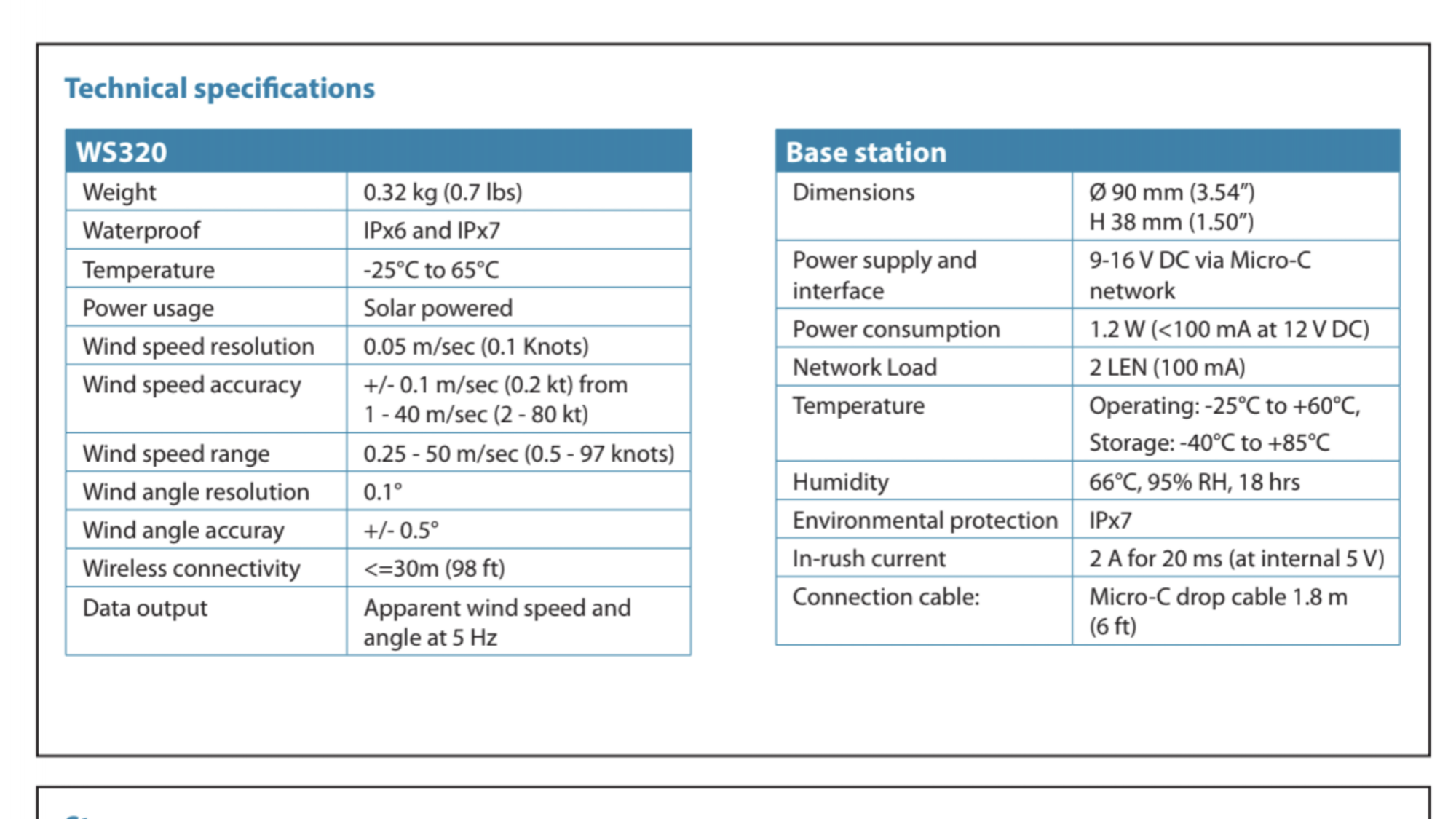

I am assuming you are using BandG - pretty “thin” documentation :) so I can understand your problem.
So in the two page manual it says wireless range is <= 98ft. I assume that’s the best case scenario - pure line of site, no interference, full power etc. Real life it’s likely quite a bit less.
I’m guessing your sensor would be at least 50ft above the deck and placing the Bluetooth device INSIDE the cabin would introduce some further distance and degradation of signal due to having to pass through solid material and being close to other devices that could generate “interference”.
The only way to tell would be to get it paired, mounted on the masthead and have enough of the cable that connects it to your NMEA 2000 backbone to try different locations. No idea if orientation would introduce any loss of signal.
