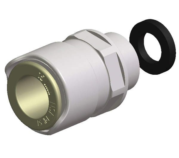

The PEX supply lines are connected to the threaded faucet inlet using an adapter, these PEX connectors come apart by pulling up on the "collet ring" to unlock, the tube can then be removed or inserted into the fitting. If the locking collet ring is not fully seated you get a leak, you may need to remove and reinsert the supply lines.
The pressure relief valve on the water heater is in the same area under the sink, these are almost notorious for early failure and leaking so check it carefully as well. Pretty sure faucet is standard 1/2 inch, relief valve also standard household plumbing part.
