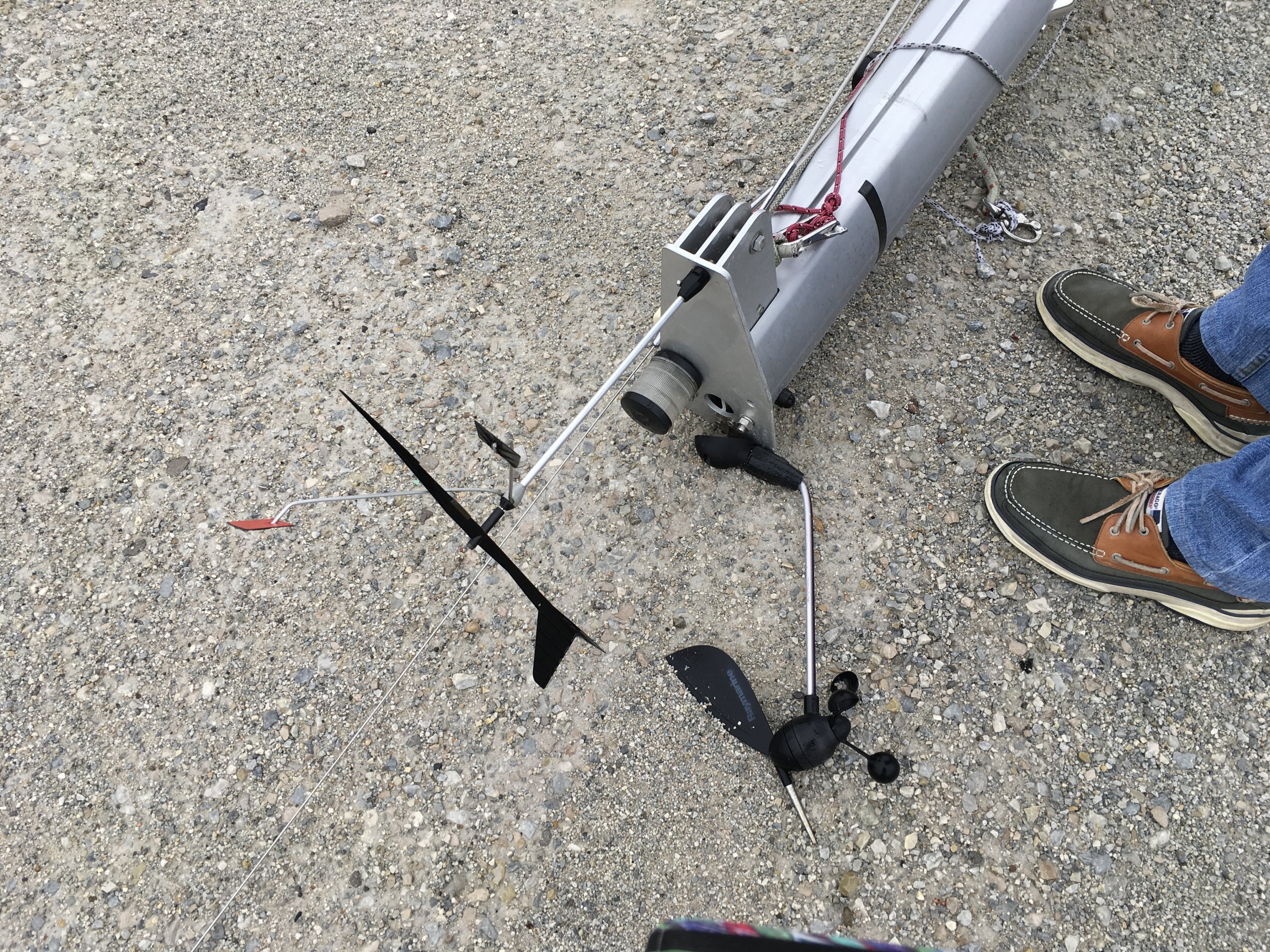

Here is a masthead photo of my old 323 mast, after it blew down. The wind indicator was obviously trashed, and the vhf antenna which mounts on an angle bracket on the port side of the mast is gone in this photo

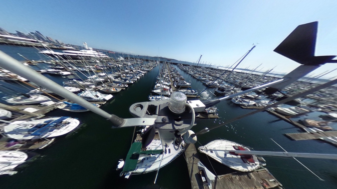

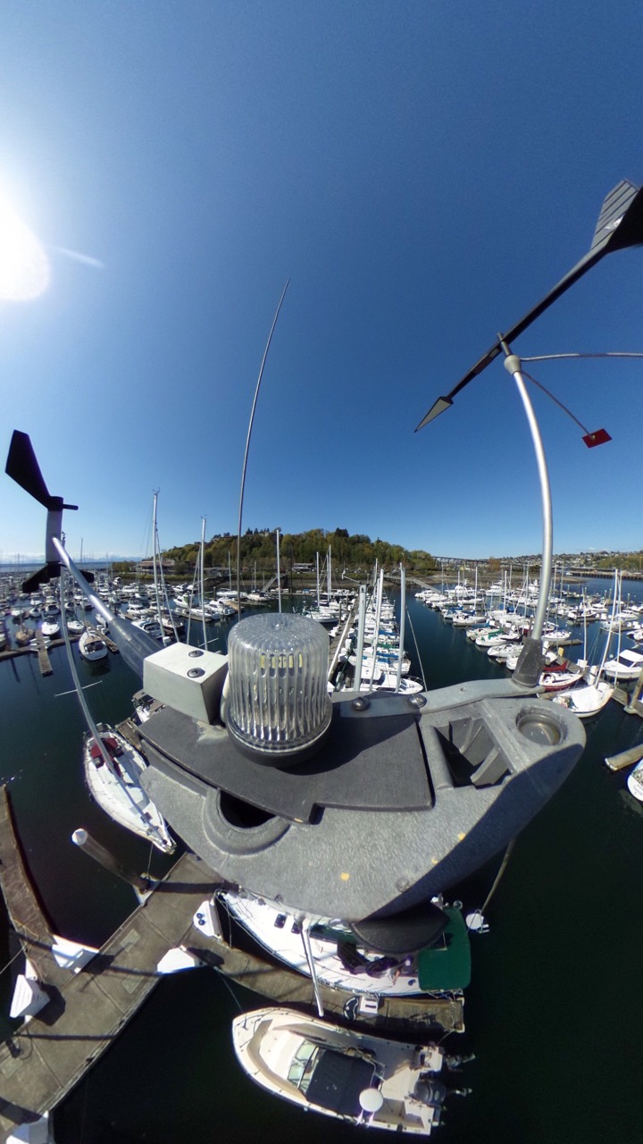

I was able to get a couple of photos of the masthead using a tripod, some rope trickery, and my 360 degree camera:
