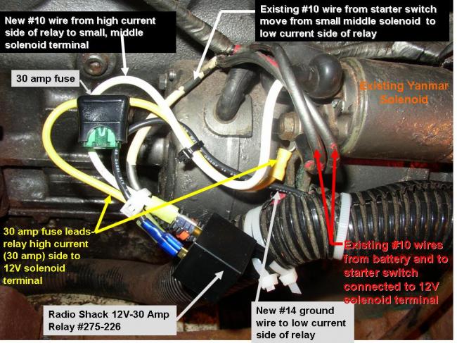

I have an problem getting the starter to connect. The problem happen randomly. I turn the key on and press the start button and nothing happens or there is a slight click. I play around with it for a while and finally get connected. I have replaced the start button and added a relay to boost power to the start. Can anyone give me a suggestion.
