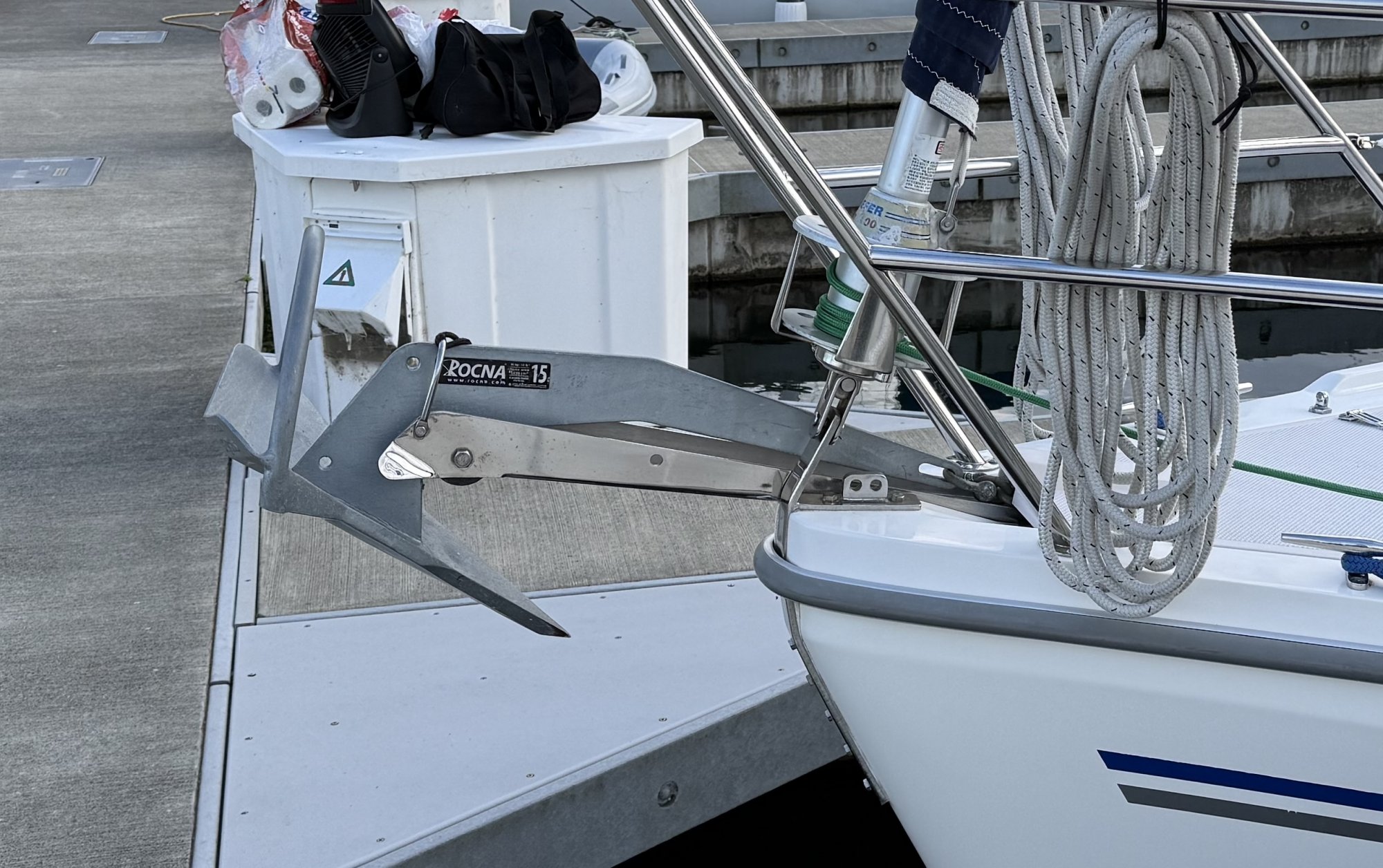

Mine came with a 33lb (15kg) Rocna, which worked well with that roller and is a great anchor with a big fan base (it's a pretty religious topic). It served me well, even in some high-wind and high-current anchoring.
Here's the Rocna:

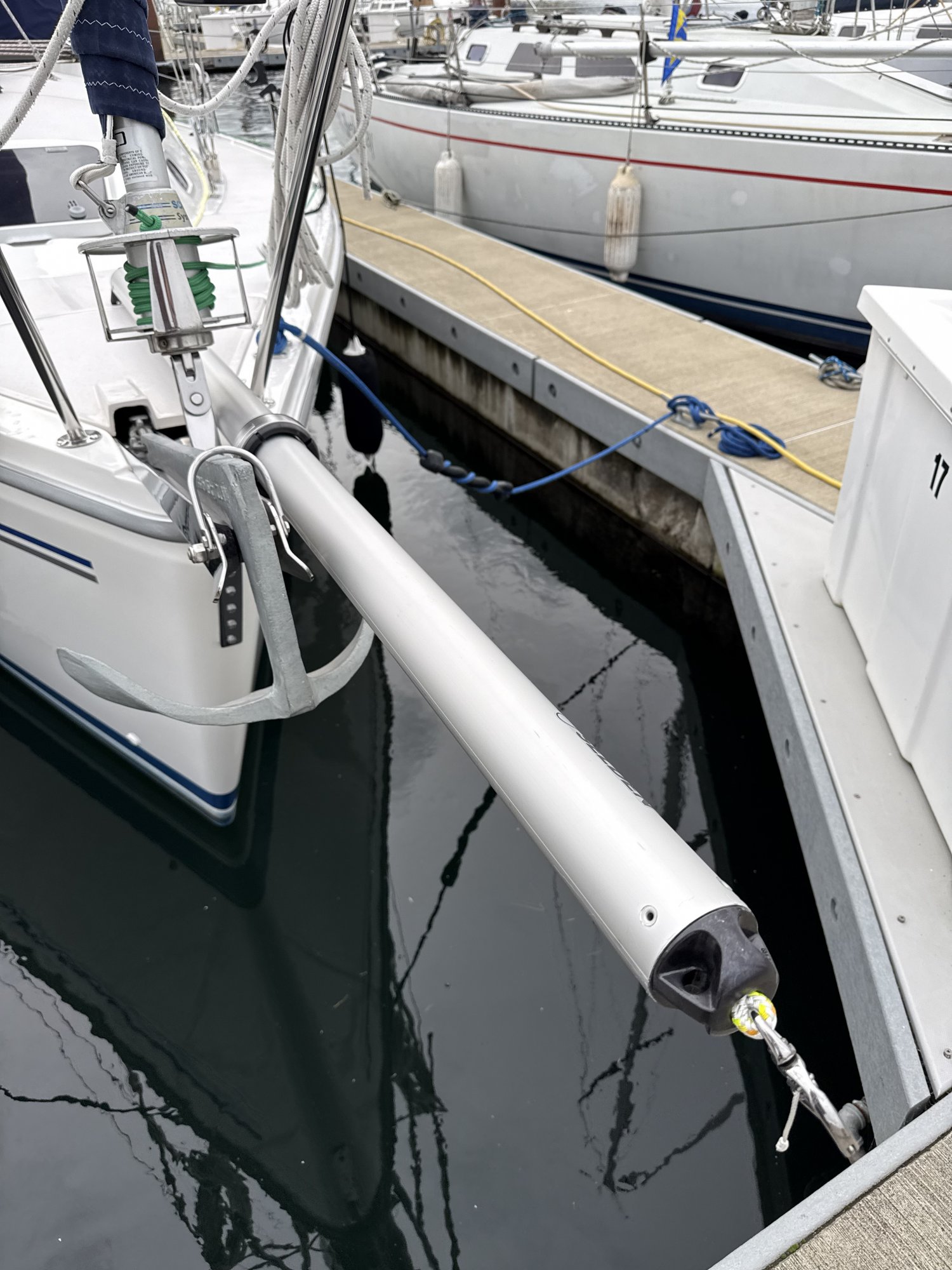

I added a Selden bowsprit to my boat (for flying an asymmetrical spinnaker), that would have interfered with the anchor, so I switched to a Bruce anchor because it nicely tucks downward after the roller and allows the bowsprit to pass next to it.
Here's the new Bruce with the bowsprit:

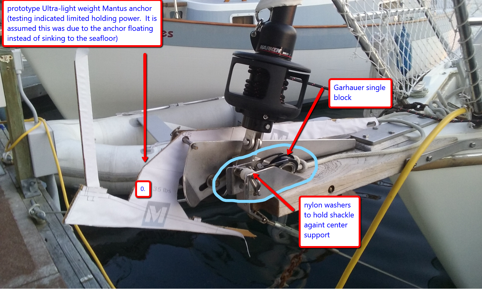

My boat is a C30 not the C310 but it is very close in windage and displacement. I have been using a Mantus 35-lb with 30' of 5/16 chain and 400' of 1/2" nylon an it has never moved an inch. Now that I have a powered windlass, I plan to increase the chain to 120' just to allow deeper anchorages that we can get here in the Pacific NW.

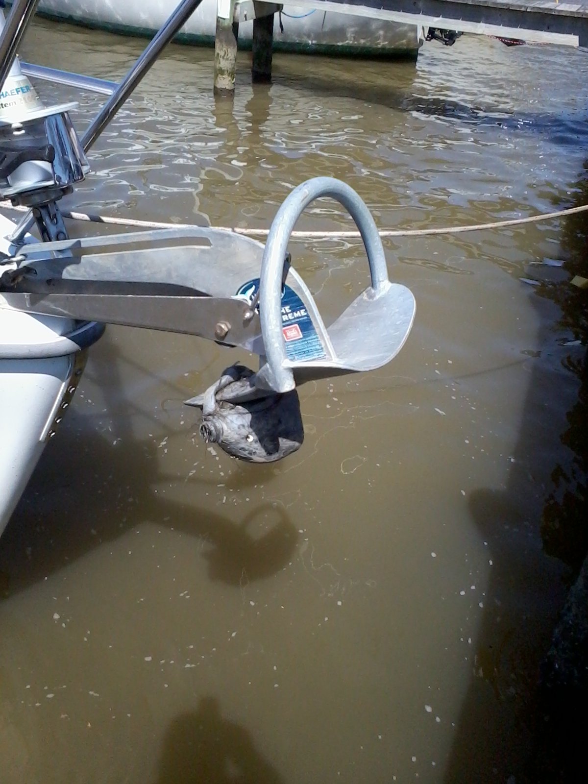

I have the Manson Supreme, I think 15kg. Has served me well. I had a Danforth before that that sometimes dragged in the Potomac River mud, but one time it set so hard it bent the shank so I got the Mason. Mantus, Rocna and Manson are all good. It does depend on where you are and the bottom time.
