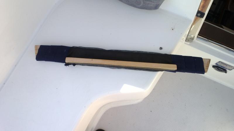

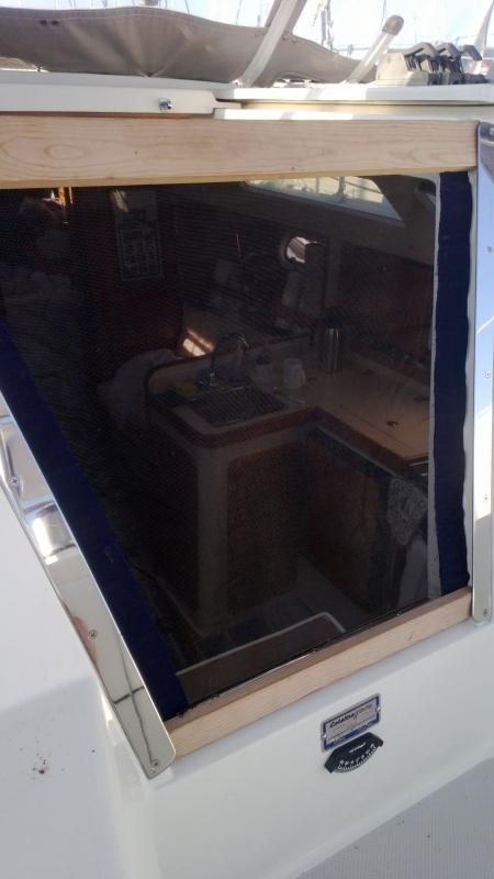

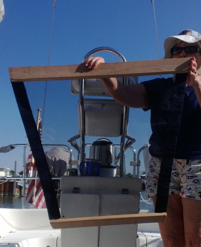

Let me throw out a simple bug screen idea that I useed a few years ago. I bought some screenig material (actually a screen kit from West Marine) and cut out a piece of the screening the same size and shape as the hatch boards - put hatch dboards on top of screen, marked and cut. I then bought a small amout of Sunbrella fabric and glued it to the edges of the screen and then glued the top and bottom edges to 1X3 pine boards that fit in the top and bottom hatch board tracks. The acreen rolls up for storage and is easy to put in and take out. As Paul J says "no good without a picture" so I'll take one this weekend (hopefully) and post next week on this thread.
