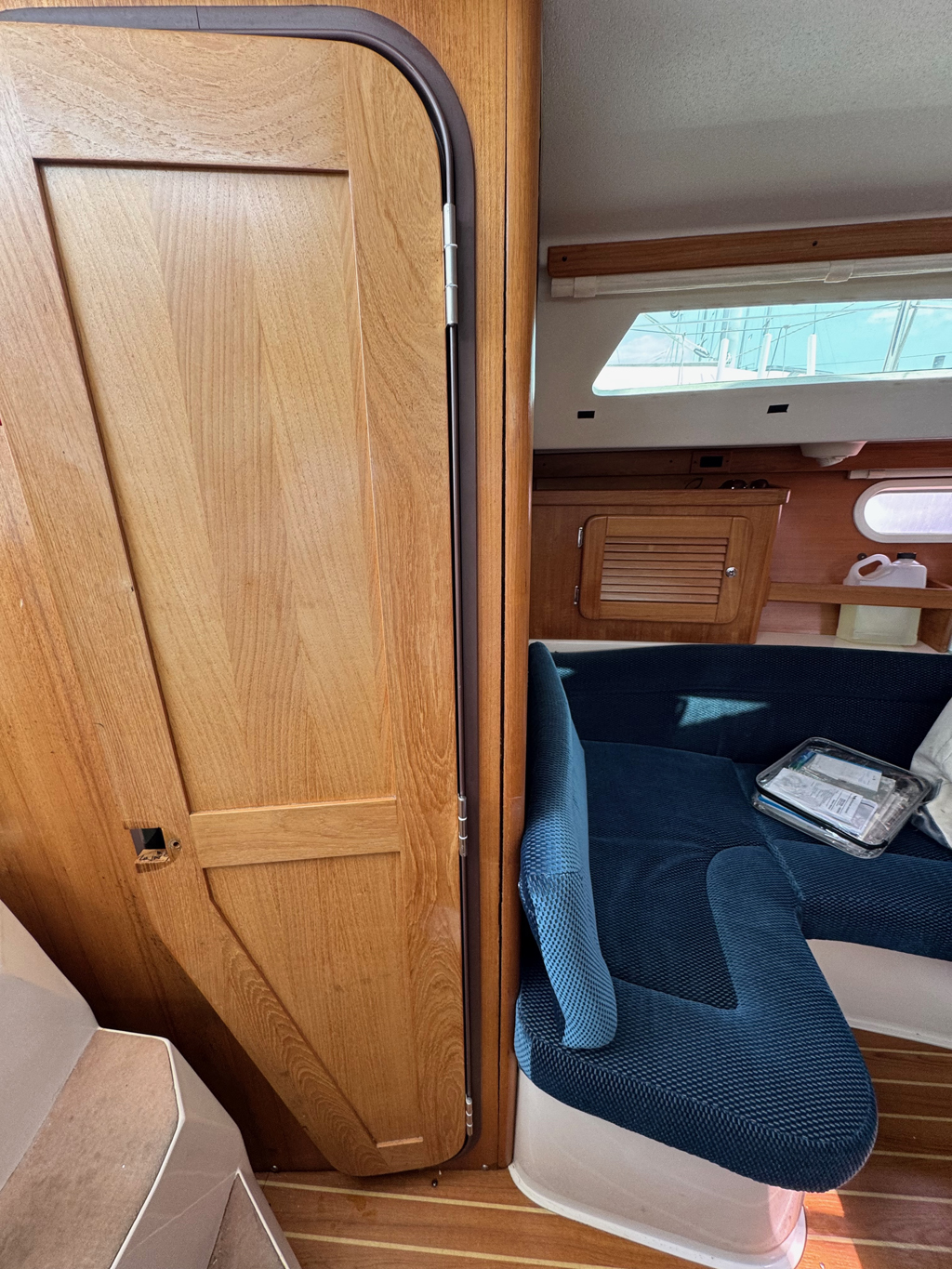

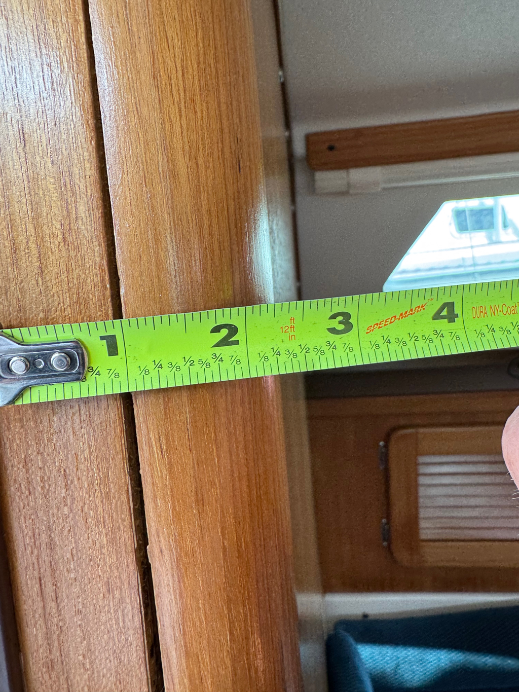

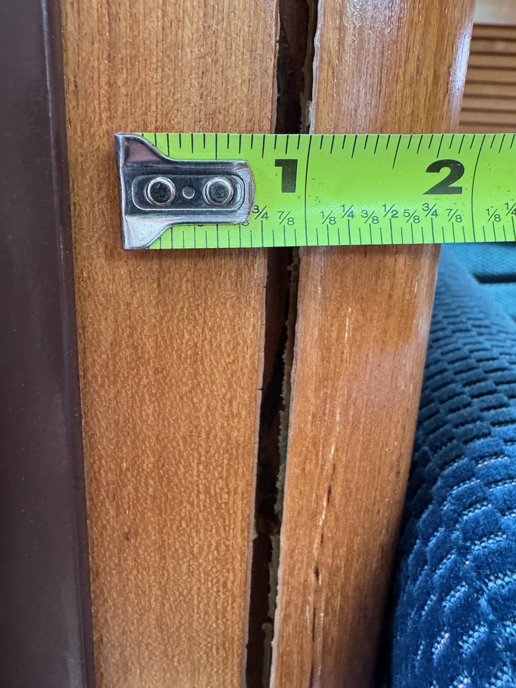

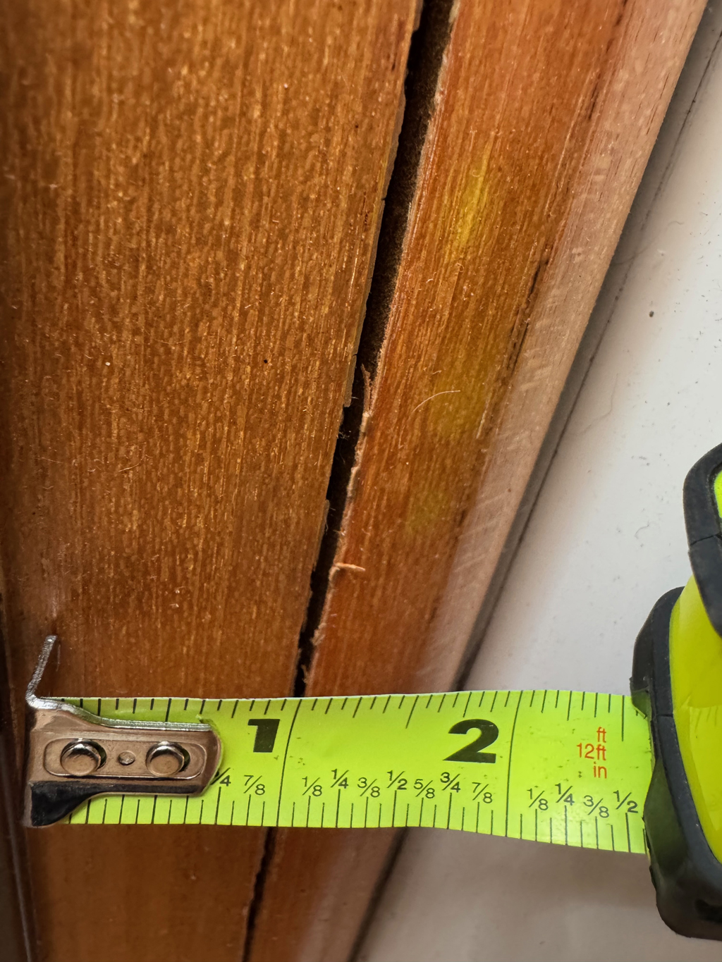

2004 Catalina 310 is showing separation of the rounded corner molding from the bulkhead. This screams "I may have a problem here." New to me boat that was surveyed without mention of this. I didn't initially see it either but noticed it after a 150 mile trip along Long Island sound. Can't believe I would not have seen this till now, but I cannot swear to it. The boat has a clean history with no hard groundings or crashes that I am ware of. There is no sign of water intrusion or soft deck, but it is underneath port hatch cover frame. The crack starts at about 1/16" at top and bottom and opens to about 3/16" in the center. It does not seem to affect opening and closing the head door.
Has anyone seen this or have any suggestions on how to investigate?
Thanks for any input.

I agree with Stu. It’s not structural. The trim is just bowed a little in the middle and the factory glue did not hold it. Maybe the trim was cut a bit long forcing the bow. Can you easily push it back into place? If not you may want to remove it, sand off a smidge of length, then glue it back into.
