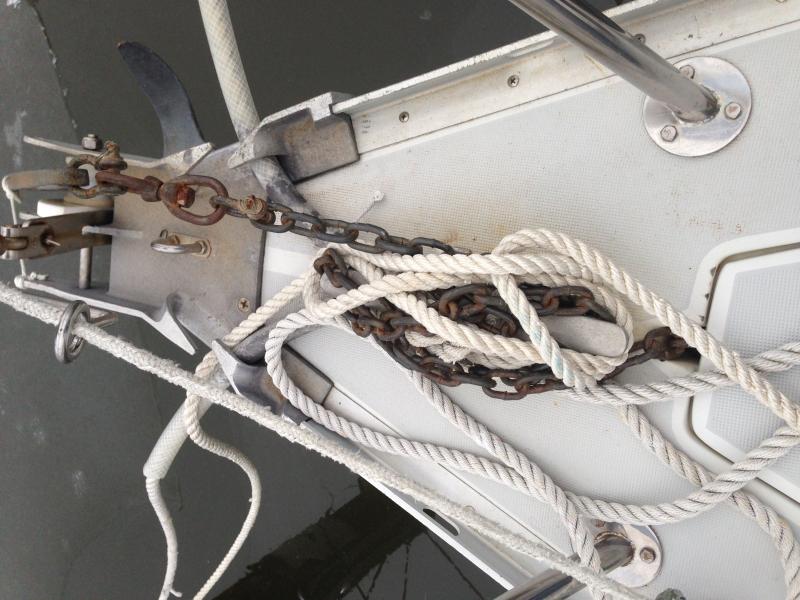

I was wondering what sort of setup you guys use for the anchor while under way or in the slip. Right now (ignoring the mess of the lines), the rode is tied off to the front cleat with another lined tied to the anchor itself, and I'd rather not use the cleat for this.
There has to be a better way.
23,503
There's almost not enough picture to show the whole deal. I assume you mean the single middle cleat, don't know if you have side cleats, too, for the chocks shown. Also don't know if with all that chain you have a windlass or not.
I agree, the cleat is a VERY poor place to hold the chain, and a windlass capstan is even worse.
If you could tell us, better yet show us, more area back from the bow, we'd be able to help some more.
One very obvious thing: ditch the swivels, right away.
Here's why:

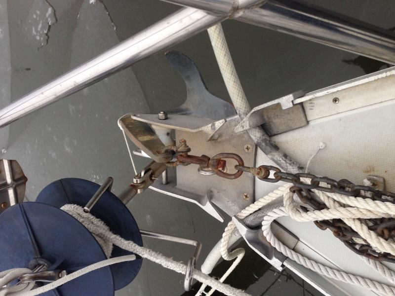

This is the only other picture I have of it right now, and I didn't upload this one before because the bow lines look disgusting. For some reason I decided to take this picture while in the middle of cleaning it all up instead of waiting until I was done.
I only have a center cleat and nothing else. There is no windlass or another cleat. You can see from this picture that the chain locker is right behind the cleat and is holding about 80 feet of chain rode and another 100 feet of nylon rode.
I will get rid of the swivel tomorrow when I go visit the boat. Thanks for that advice.

as Stu said ...ditch the swivel...you can let all the rode and chain down in the locker and secure the anchor (still attached to the chain via shackle) with a lashing/lanyard and/ or snap hook to that u bolt/pad eye on your deck in order to be safe while underway......

after looking at your pics again it appears to me that your anchor is not all the way up in the bow roller...if that is the case does the eye of the anchor stem come further back than the u bolt when in the resting position...if so make a lanyard with a snap hook on one end and a eye splice on the other end to secure to that cleat and hook he snap shackle to the anchor leaving only enough slack to use the snap shackle and so as not to let the anchor slide forward.....or look for another u bolt in your anchor locker to attach the lanyard........ to hope this helps
23,503
woody's right, that's one way to do it. Sometimes you'll find that if/when you pull the anchor as far back as it will go, it will balance much better on the bow roller and the weight of the chain going down into the locker will keep the anchor on the roller without assistance, except of course in boisterous conditions where you'll want to tie it off.
