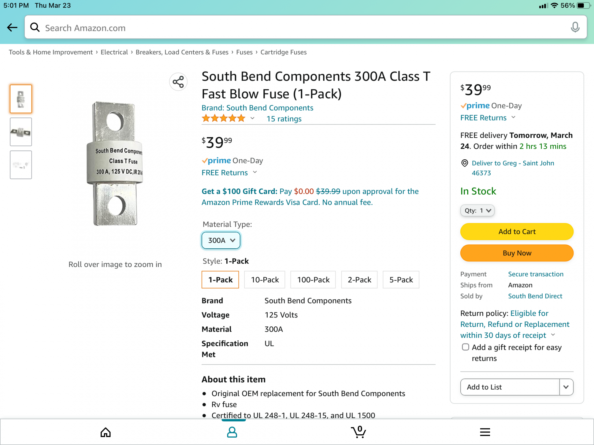

Did you check Amazon…I don’t know what a T fuse looks like, but this popped up when I searched for it…

I did look on Amazon. The one you posted is 125v. The ones I saw were on back order. Grainger might have some, $180. At WM they were $45 with a procard.

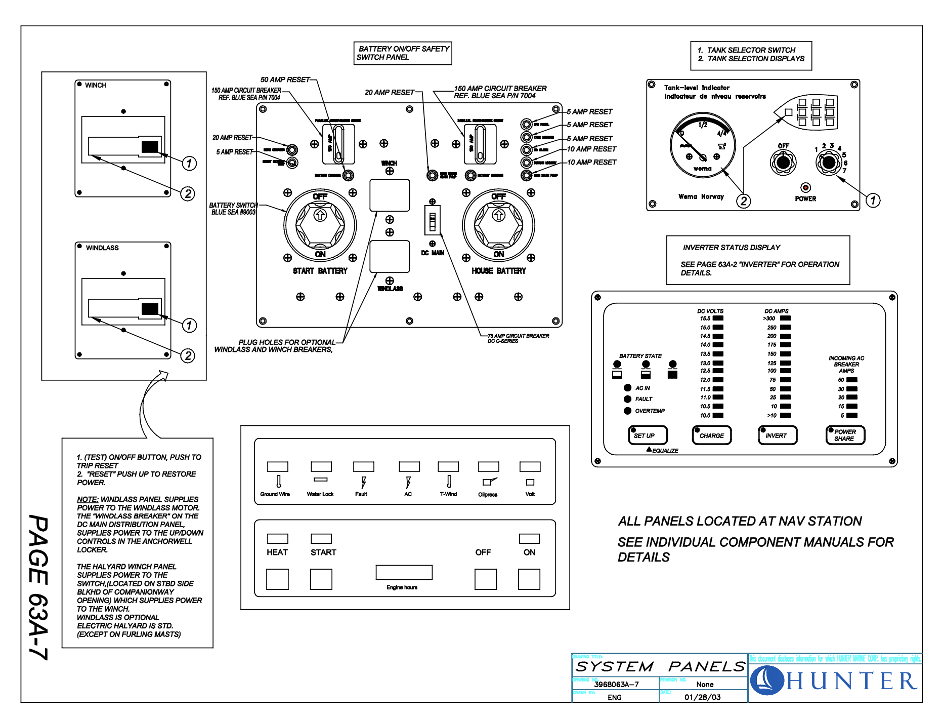

Per that manual 300A fuse is on the House Batteries cables. [like mine too]
His Panel.
Simple check for 300Amp fuse with a DVM.
