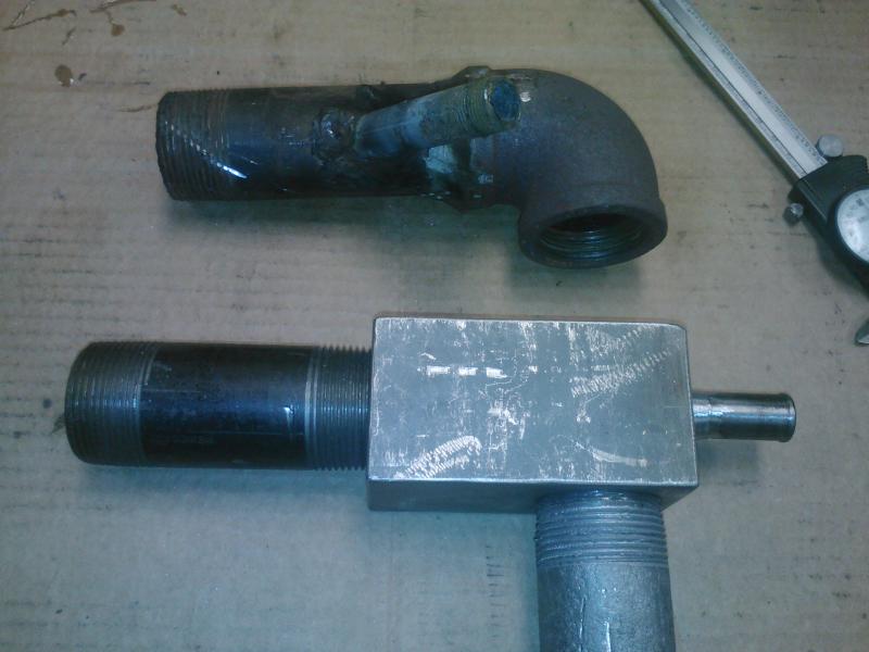

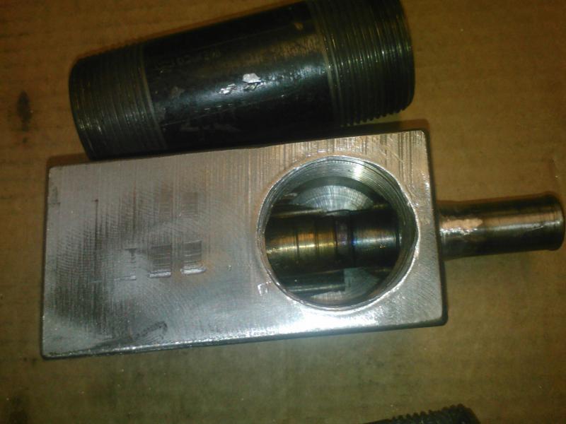

Anyone know what the original exhaust looked like on a 30 O'Day? What I found must of been made in a weld shop. Specifically the mixing tube, where water is added. It is just black pipe with a smaller pipe welded on a 45 degree angle. I made a new one from a solid block of SS and TIG welded in the water tube from the top.exhaust2.jpgexhaust.jpg

Looks like you did a good job. What Engine? If it's a Universal (Westerbeke)The "original" is probably cast iron pipe from a hardware store.

It is the Universal. The 16HP motor, I can't believe that is the factory fitting!! I test fitted the rebuilt unit today, looks good. I will have all the joints brazed prior to finalizing it.

There are no factory exhaust fittings on a Universal. They were all plumbed with build in place hardware store pipe fittings, and the systems work just as well as any other. Cheap and easy to build, easy to clean out. What you have there looks like it should work fine.
