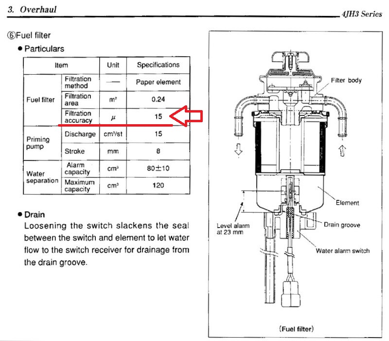

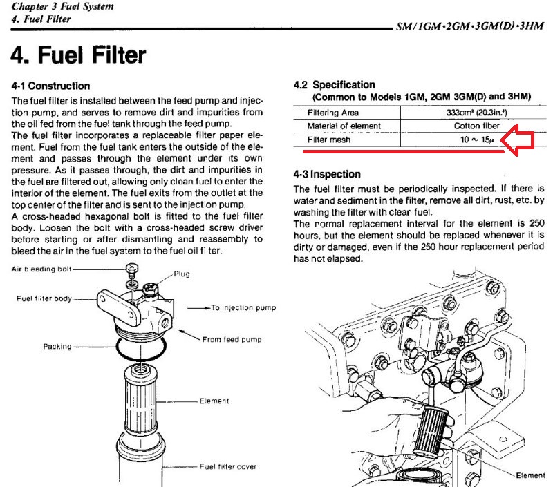

Guys,
There are no on-engine/secondary Yanmar or Westerbeke / Universal filters that are 2 or 3µM. Universal (Kubota engines) spin on filters are 25µM rated. Westerbeke cartridge filters (Mitsubishi etc. engines) are 15-17µM. Yanmar on-engine/secondary filters are 10-15µM or 15µM... (note none of these are "absolute" ratings)
A 10µM filters is fine, but will plug faster than a 30µM.. None of these engines makers wants you to use a 2µM as a primary.
