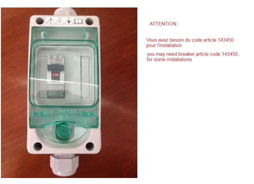

I'm having a problem which may be related. I have two of these breakers, as Newport Bob provided the link for:
http://spareparts.beneteauusa.com/controleur.php?action=catasys/photo&Rep=usa&CodeArticle=058509 (picture attached)
One seems to be for the air conditioner power inlet, and works ok, and the other seems to be for everything else, including the battery charger and wall outlets, and that's the one that doesn't work.
My air conditioner circuit works, but I get no alternating current for anything else. I've reset both these breakers and it doesn't resolve my problem.

I also have AC in the 373. I have two 30 amp shore power inlets on the stern, each with a breaker as shown. (Mirror images port and stbd) Two totally separate circuits. Hooking up a single shore power cord does not provide power to both. So the "solution" might be you also have another connector.

View attachment 117287 I'm having a problem which may be related. I have two of these breakers, as Newport Bob provided the link for:
Davidasailor26 wrote "Our 2014 37 has one breaker box where he describes, under the starboard settee, but also another in the starboard aft lazarette within 10' of the sockets."
I'm not at the boat now to check, but does anyone know what the "one under the starboard settee" that he describes controls?

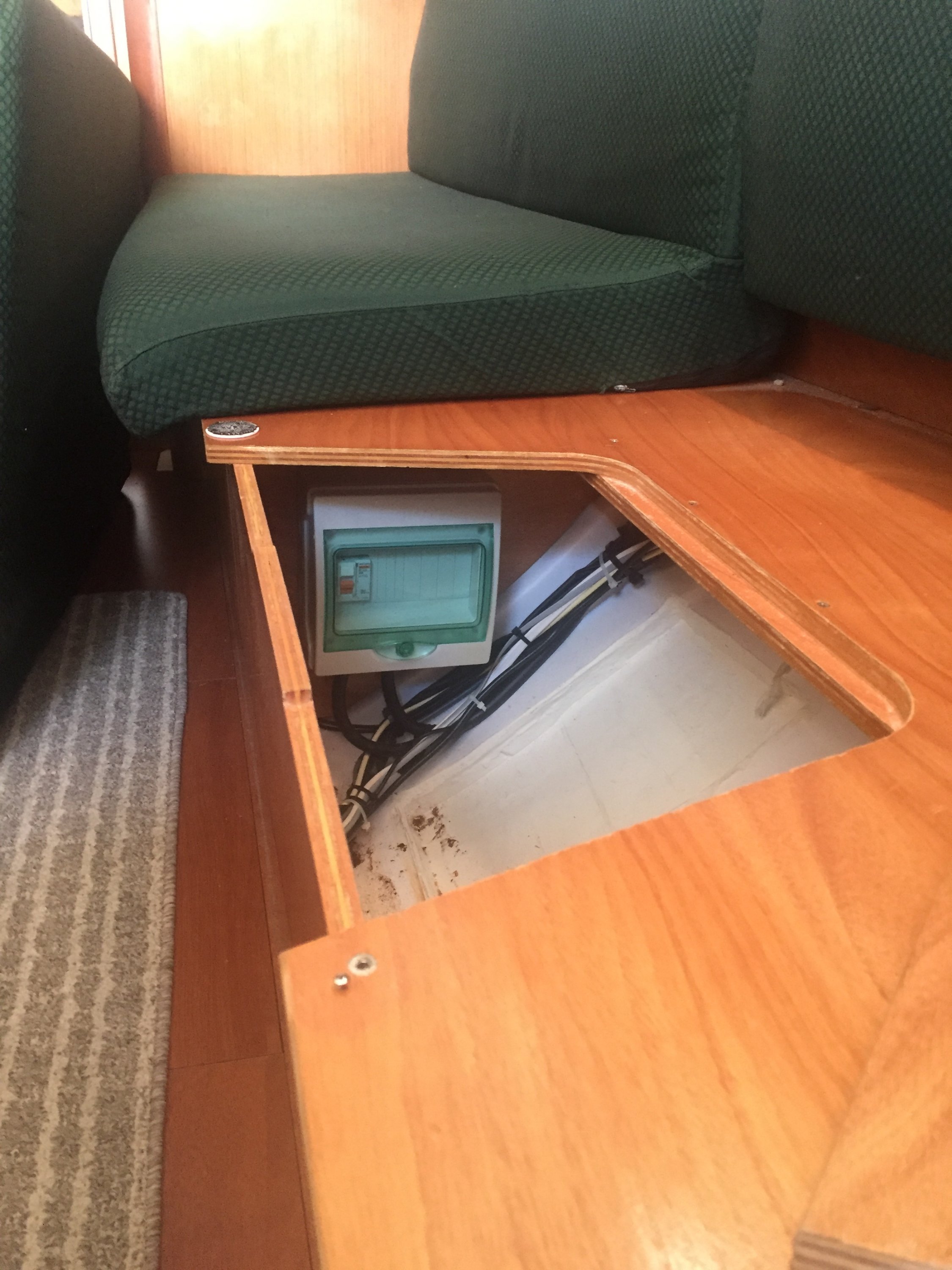

I'm also not at the boat to confirm, but from what I remember there are two breakers under the settee, one for each circuit. So it's possible that the one there for the main circuit has popped.

Thank you all! It turns out it was the pictured breaker under the starboard settee.
I don't remember ever seeing it there in the 6 months I've owned the boat.
