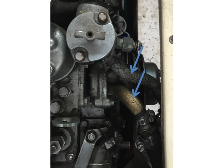

My M25-XP has two short lengths of 3/8" hose running from the thermostat housing to brass adapters where it transitions to 5/8" hose.
Time to change out these hoses.

I looked at the hoses again. One is flexible and has a braided covering. That one is painted silver so may be original. The other does look to be a formed hose. It is painted copper so not original.

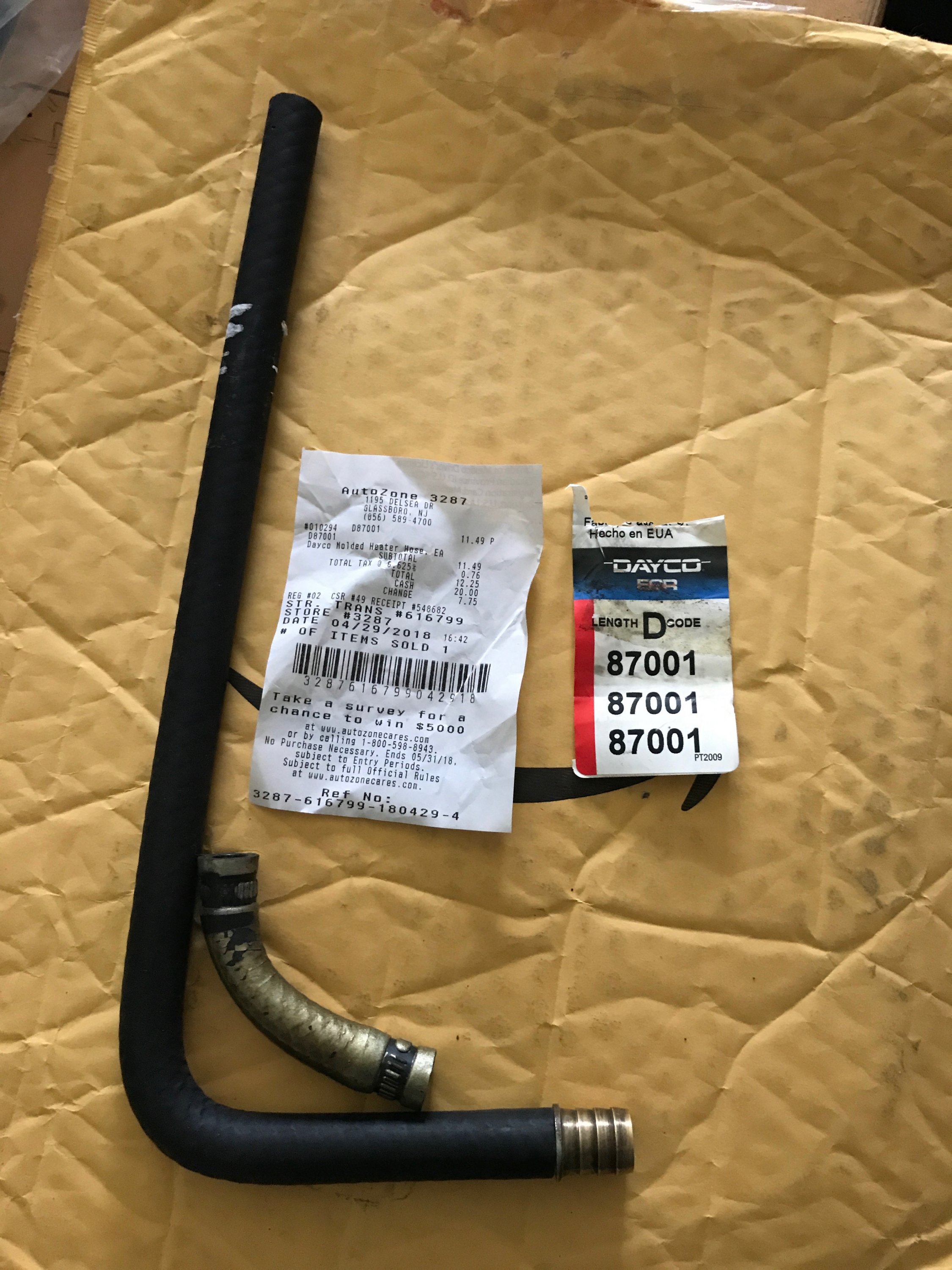

Found a hose that will work at the local AutoZone. I had to look through their formed coolant hose rack to find it.
Dayco 87001 is a 3/8" ID Formed Coolant Hose about 14" long with a 90 Deg bend at one end. It will give me the 3/8" 90 Deg formed hose I need as well as the 3/8" straight hose.
Hope someone else can use this info.

Perhaps I'm seeing things wrong, and if I am I apologize, but it looks as though you have two hoses hose clamped inside another hose to go from one size to another. This is a sure fire recipe for disaster. I would replace whatever fitting wherever it is (sea strainer?) with the proper size nipple and run the correct size hose directly to the pump or at least use a reducing nipple at this point and get rid of the mickymouse connections in the picture.
Ward H
Nov 7, 2011
3,843
@capta Yep, looks are deceiving.

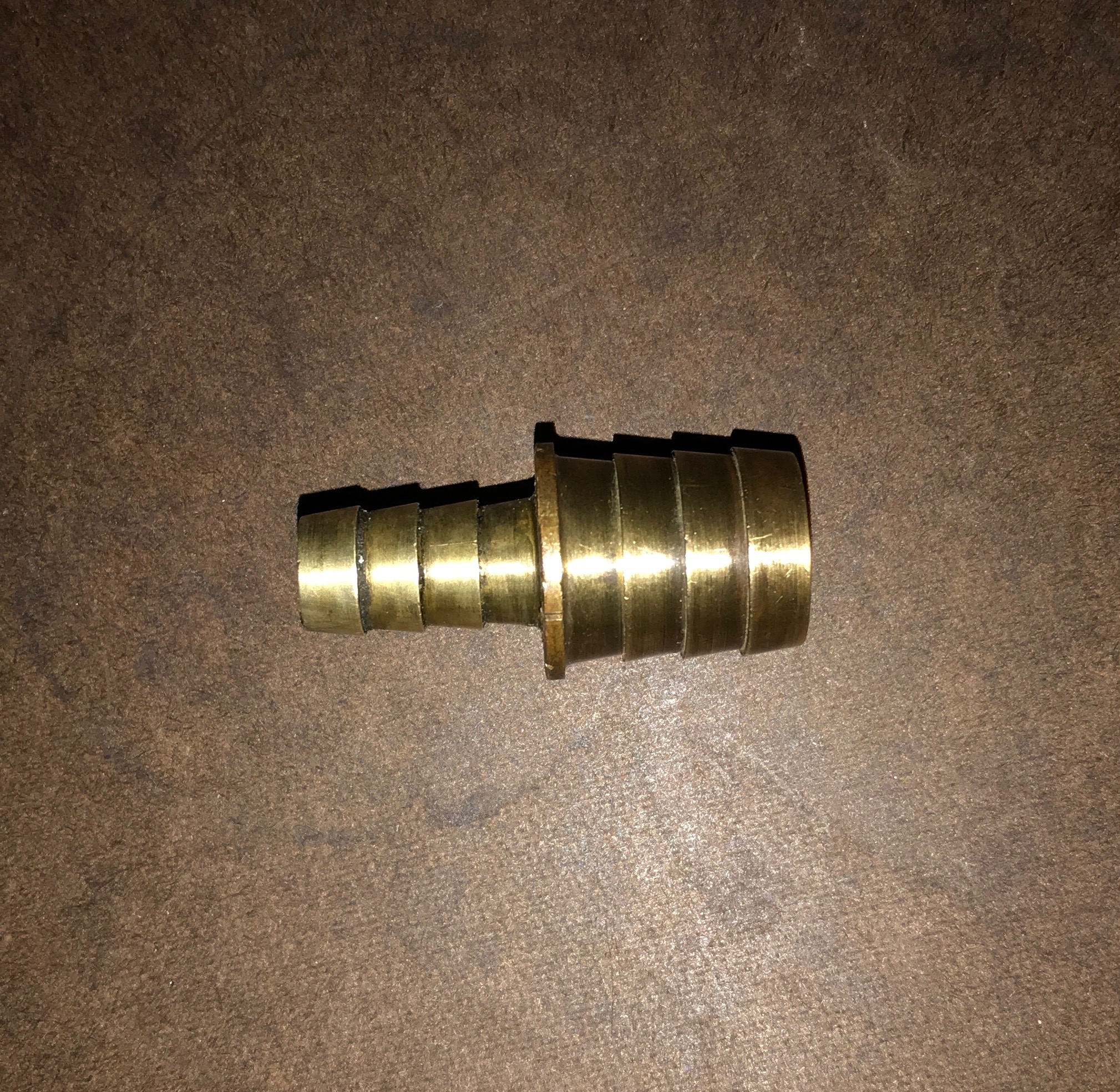

After a little more research I discovered one nipple is on the T Stat and the other on the water pump. A single 3/8" hose connected them to become the T Stat by pass connection.
To supply hot coolant to the water heater Catalina inserted brass 5/8" to 3/8" reducers into the by pass hose to reduce the 5/8" heater hose to 3/8".
Heres a pic of the reducer.
