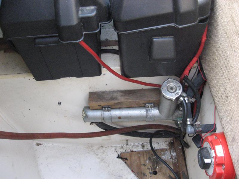

Was your external heat exchanger placed in the port lazarette? Here is a picture of mine as it looks now. The red 1/2/Off switch shunts to my emergency start battery. For ever day power on/off I use the 1/2/Off switch at the nav station.

Here is the photo. The heat exchanger is a Send-dure 2550. When I bought the boat, the baffle plates on each side of pipe had some holes, letting anti-freeze and raw water to interact. The tubes themselves however were in very good shape. A local radiator man that also does heat exchangers packed the holes with a thick layer of solder. All been working fine now for 5 years.
