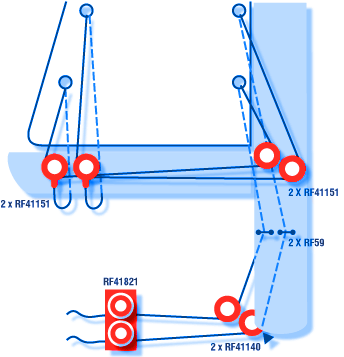

Sorry if I'm hijacking this thread, but what I have has been mentioned, and I'm curious on how to fix it to have BOTH front and rear single line reefing.
I photoshop'd an image to show what I currently have. I only have the rear point going all the way to the cockpit, and the front is just dangling with a tie down. Whats the correct way to do single line front/rear reefing?

jonelli, you have what i have, but it seems boats even later than ours have single line reefing going through the boom like our friction(down) haul does. there is no way to rig our system to single line reefing, but my stakpack eliminates the need for the forward reefing line in all but the heaviest wind. now, if you can figure a way for me to neatly stow the aft line on the boom........

I was imagining something like this. I might have to move the forward block to the other side or just move the reefing line to the other side, or do them separately. I was curious what other people do.

Sorry if I'm hijacking this thread, but what I have has been mentioned, and I'm curious on how to fix it to have BOTH front and rear single line reefing. I photoshop'd an image to show what I currently have. I only have the rear point going all the way to the cockpit, and the front is just dangling with a tie down. Whats the correct way to do single line front/rear reefing?
You could make this single line by running the "red" line up from the forward block on the boom to the cringle, and then down the mast to the existing cleat (eliminate the "green" line). Or you could bypass the cleat and run the line to the cockpit through a deck organizer.
On the aft end of the boom, eliminate the bowline and put a cleat on the opposite side of the boom. You could manage this end of the line from the cockpit.
If you want a 2nd reef, you could duplicate the whole thing on the opposite side of the boom.
