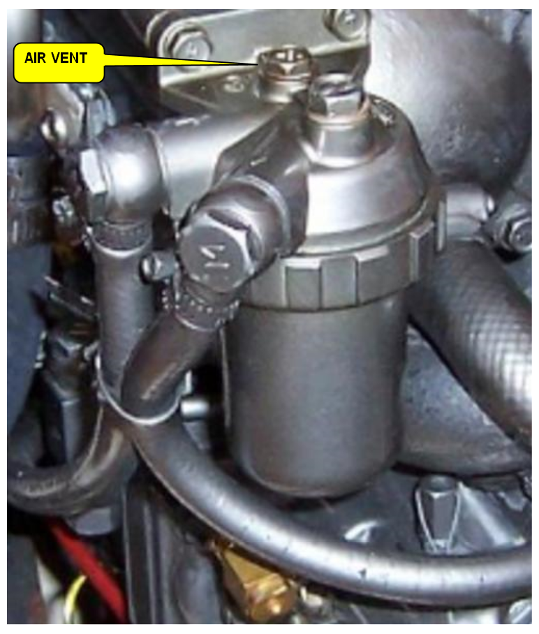

Be sure to vent the secondary and primary filters of all air before starting the engine. You might even keep venting the secondary filter if you're seeing a lot of air when you hand pump the lift pump. You may require a new nylon gasket for the air vent if your current gasket is a copper washer.
Don't try to start the engine until you are sure you have eliminated all air possible using the filter vents.

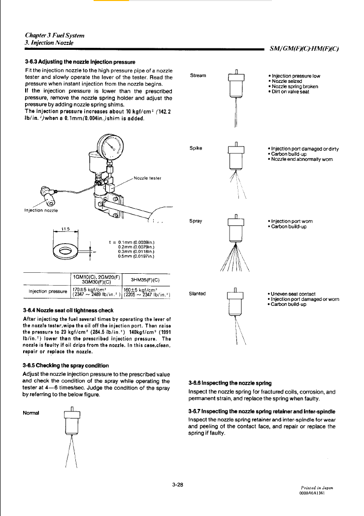

As I am waiting for fuel filters I decided to pull the injectors and inspect and clean them. After getting them out and looking at them, the bottom with the needle sticking out the bottom had a lot of carbon build up. I soaked them in brake cleaner solvent. took them apart, one of the injector needles was stuck, got it loose cleaned the needles so they moved freely. put back together. will install them when I do the filters. The cylinder that the needle slides into is brass with the bottom is a dark blue, looks like they have been very hot. I don't know if that is color they should be. the engine is 1997 yanmar 460 hours.
I would send them to a local shop or UPS them to a shop that specializes in repairing injectors. Proper operation of the injectors to atomize fuel & spray in a specific pattern is critical to the operation of the motor. It is not something that you can calibrate at home. I sent the injectors for my Yamaha outboard a few years ago to a facility in Florida; my recollection is that the rebuild cost, calibration & before / after test report was approximately $35 each.

As @BigEasy shares, fiddling with injectors is filled with problems. Certainly you can await for the filter, replace it, bleed the fuel lines of air and try for a start. If it does then great. Monitor your consumption.
A bad injector can cause excessive fuel consumption, unburnt fuel on the water, black smoke.
Service the injectors. Best practice would be to send to a shop that has the equipment to assure you are getting the proper pattern and amount of fuel sprayed from the injectors. They would also be able to resolve the “blue” metal question.
If I can make a suggestion here : "DON"T TAKE ANYTHING ELSE APART IF YOU WANT THIS ENGINE TO RUN AGAIN"
As has been stated before, "taking your injectors apart is a big NO NO." You don't have the equipment to check the injectors after you've taken them apart :
You are setting up a situation where you have more than one reason for your engine not starting. I would suggest you tackle one item at a time, such as fuel at the injectors and prove that out before moving on to something else. Unless you can approach this in a orderly fashion, you will soon be calling in the high priced help.
With injectors which are likely screwed up at this point, I would suggest sending them off to a shop and having them set up.

If I can make a suggestion here : "DON"T TAKE ANYTHING ELSE APART IF YOU WANT THIS ENGINE TO RUN AGAIN.
Cool thing about the injector shop that I sent my Yamaha (115hp) injectors to. They test the injectors on their computer monitored machinery, before servicing for flow, pressure, spray pattern, etc; approximately 5 parameters. After disassembly and cleaning, the filter, spring, & nozzle are serviced or replaced. After re-assembly, it is rechecked on their test equipment and provide a print out for you to compare before & after results as well as recommendation to purchase a new injector if it the results are not satisfactory.
