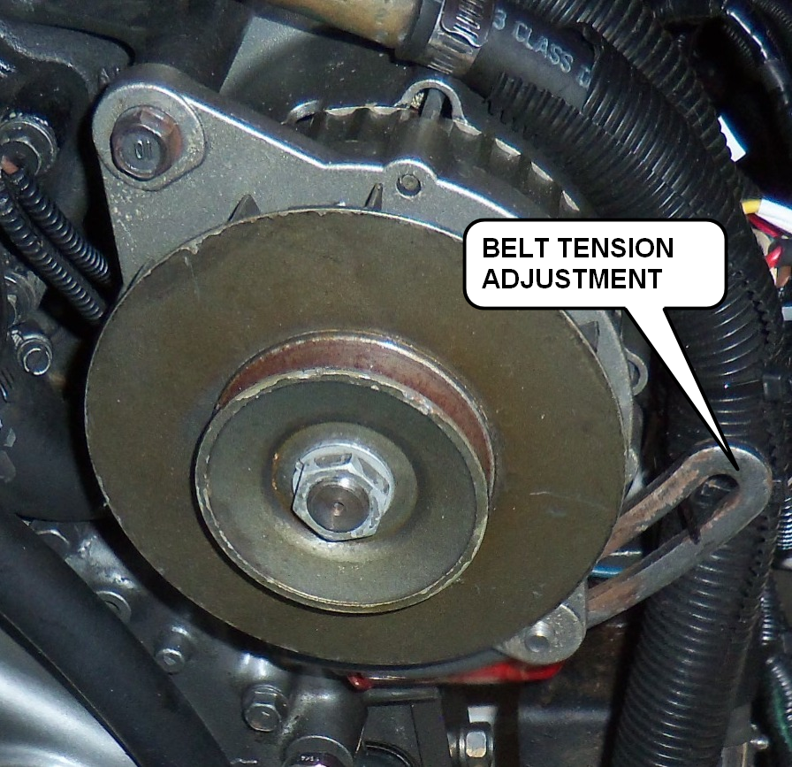

Have you used the alternator bracket to take up or supply slack to the belt you are using ?
I would think the tension adjustment would allow either an A36 or an A37 belt.
Sorry, but cannot remember what size mine is but it's not a Yanmar supplied belt.
