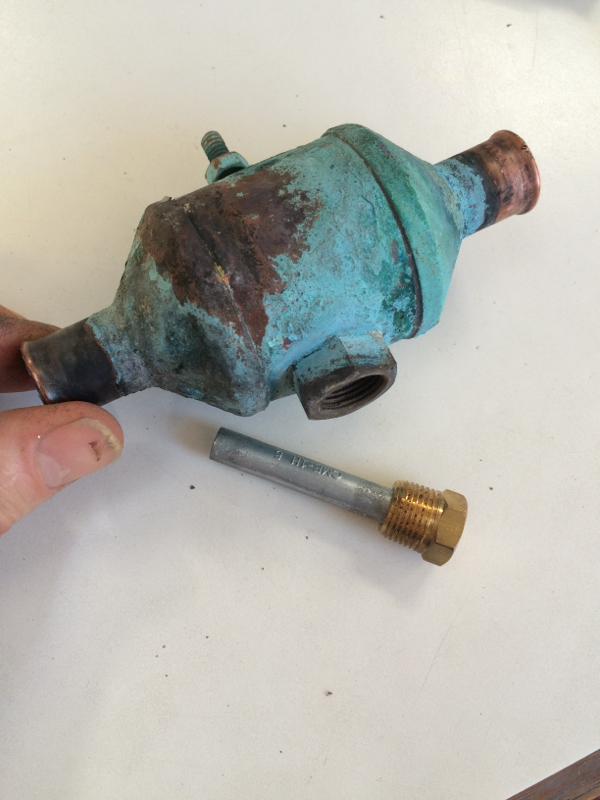

On my Yanmar 2GM20f, I have an online zinc the I regularly replace. The housing for that zinc is old and leaking. Anyone have an idea where I might find a replacement? See attached pic. In advance, thanks for help.

Can you tell the rest of us us where this thing is mounted in your cooling water flow layout? Do you know what it is supposed to do?

There are no zincs on a 2gm20f. I have no idea what your showing as an "online zinc" is.

I would recommend that you check with Yanmar technical support. This looks like a add on that someone other than Yanmar installed.

I have checked with Yanmar and this was an add-on maybe by Hunter. I checked with Hunter and the people I talked to were not even born when this boat was built. The device is inline (sorry about the "online" typo) zinc situated downstream of the sea water intake for yanmar cooling. I am aware that 2gM20 do not have zincs in the engine. The zinc/bronze device is bonded to the engine. I would take it out, but I regularly eat up a pencil zinc every year or so and this would be damage to the engine.

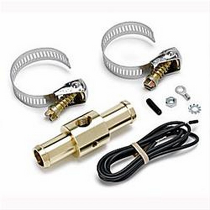

At one time the threaded fitting on the canister was used to install a temperature sensor whereas today you thread in a zinc. The threaded stud/nut (opposite side) was for a ground wire which was fastened to the motor block. The assembly was installed in the outflow of the seawater path and the sensor wired to a temperature gauge. This assembly allowed installation of a separate temperature gauge driven by its own sensor independent from the stock overheat buzzer/lamp.
If the theory is true - then today the unit does nothing and the zinc just protects the do-nothing canister.
Since there is no longer any need for this apparatus you can chuck it and replace the entire section with new hose.

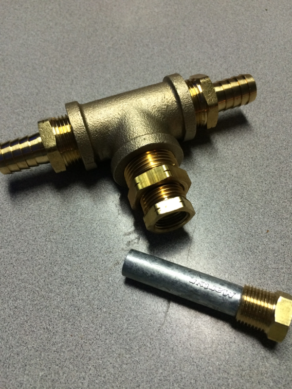

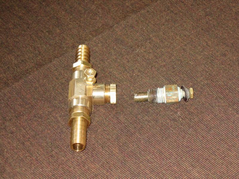

OK - if so then this will work exactly the same as what you have now, it won't cost much, and it won't leak.
Obtain a tee, female threaded fittings, etc., and two hose barbs. Solder on a tab or drill and tap the tee for a machine screw as a ground point. You can use copper, bronze, iron or even stainless. An aluminum one is available from Summit Racing.

I agree you should be able to build your own out of plumbing parts. Now you got me thinking: What is it actually doing for you? And why is the zinc being eaten up? Your system is clearly different than most of us. Is the zinc somehow electroplating onto something else? enclosed like that it can't be from a hot marina. I wonder if your raw water is acidic?

Charles/Ken, Brilliant idea! I was mentally stuck thinking about replacement rather than creating a new part. Your attached picture got me searching the Internet. I found the part you attached. Even better, I found this website brasscraft.com and they have every imaginable fitting.
I don't especially understand the nuances of electrolysis and have always wondered why Yanmar doesn't need zincs. I suspect the part in question was put in for some reason. I definitely will replace this part, even if it isn't doing anything esp since the zincs periodically dissolve. For me, the risk of my engine dissolving to not worth experimentation.
