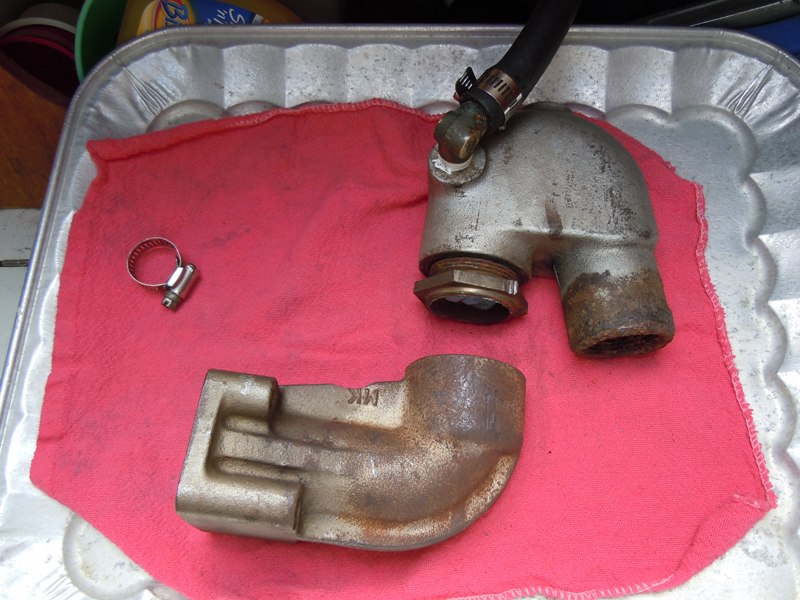

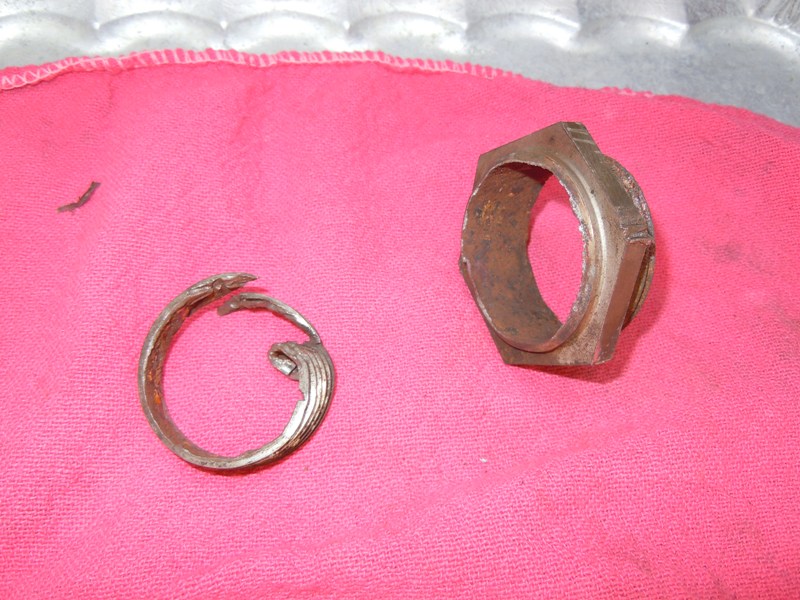

In my case it wasn't the cast iron that failed. It was the stainless steel connector.
Granted that e-bay one looks beefy as it is a cast part. Earlier ones on ebay were thin wall tubing and I wouldn't consider one of those. Time will tell, but keep one of these spares on board. :D

Can't find it either but I think the bad review may have dealt with a 304 SS welded mixing elbow. Not a good idea as chloride stress corrosion is classic in weld stressed stainless. And that one looks like it's well stressed.
I'm still considering purchasing the cast 316 SS elbow as it's pretty much free from internal stress and it's half the price of a cast iron elbow up here.

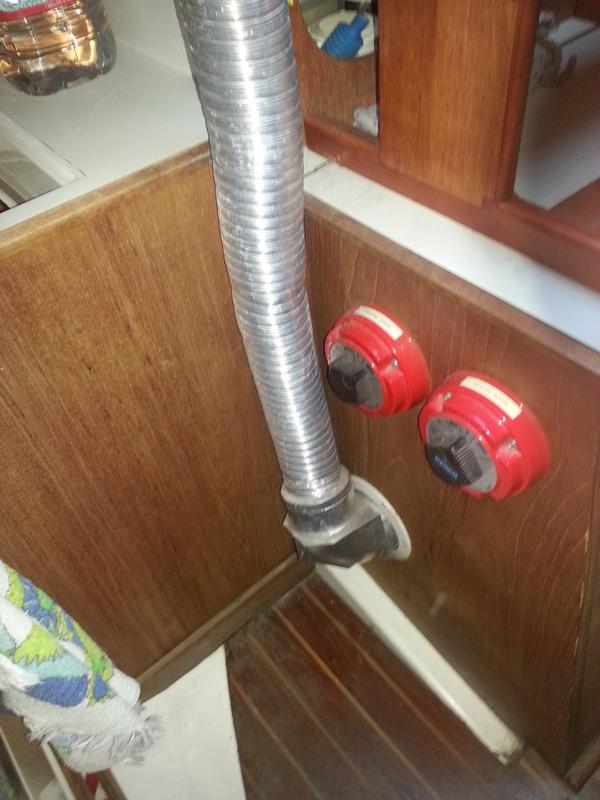

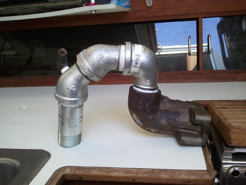

Looking at your last photo, I bet your engine compartment gets REAL hot because of the way you connected your exhaust. Your exhaust goes through two pipe fittings before it is being cooled.
Result: Your new pipe fittings AND your exhaust manifold will get SUPER HOT from the exhaust, which will most likely lead to early failure of components in the area, like the hoses, gaskets, the manifold itself and the back end of the heat exchanger.
I assume that the reason Yanmar designed that riser was to immediately cool the exhaust to keep closed engine compartment as cool as possible.
1,715
Hunter 34 Alameda CA
it is certainly not optimum I will agree. I'm not sure if the engine compartment will be much cooler by mixing the hot water with rapidly moving exhaust gas. I'll have to ponder the thermodynamics of that one. Maybe I could wrap it with insulation up to the water injection. This was the result of a failure 5 minutes into leading a cruise-out for a week from San Francisco Bay to Monterey. We sent the fleet ahead and then since it was the 4th of July and the parts dealer was closed for 4 days, we had to come up with a fast solution. We got it done and caught up with the fleet in Half Moon Bay at midnight! By the next Sunday it was back to original and I keep the parts in case it happens again in 25 more years. I have seen other boats with similar exhausts. My friend's Newport 33 was much like that so I figured it would be okay for a while.
I have a blower on my engine compartment that runs all the time to assist in managing the temperature.
Mar 11, 2015
357
Hunter 33.5 Tacoma, WA
Great on the spot repair. I don't think the insulation would help that much with the heat, but the blower probably helps a LOT. [grin]
I think the original riser design is suppose to act like a heat sink. When I point my laser temp gauge on mine, it's pretty cool (about 80 degrees) which keeps other stuff cool. You may want to consider putting the original back in the future.
