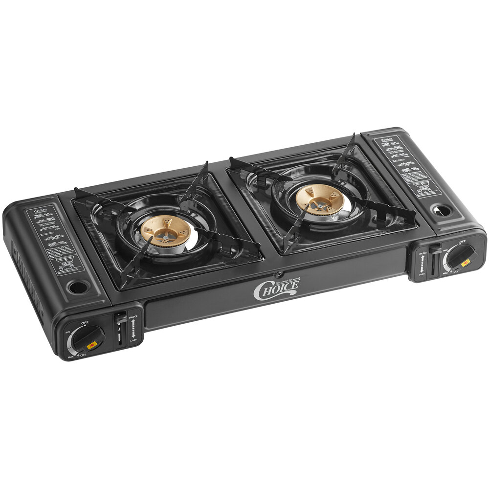

I have a 1996 Hunter 29.5, it has the alcohol 2 burner stove top burner set up. I’d like to replace it with a two burner stove top that I can connect the small camping bottles of propane or propane mix to it when you use it. Looking for advice as to brands and installation.

You can purchase a 2 burner propane or butane stove for ~$45. Just google 2 burner propane or butane stove. I use a butane stove when cooking outside our trailer.
