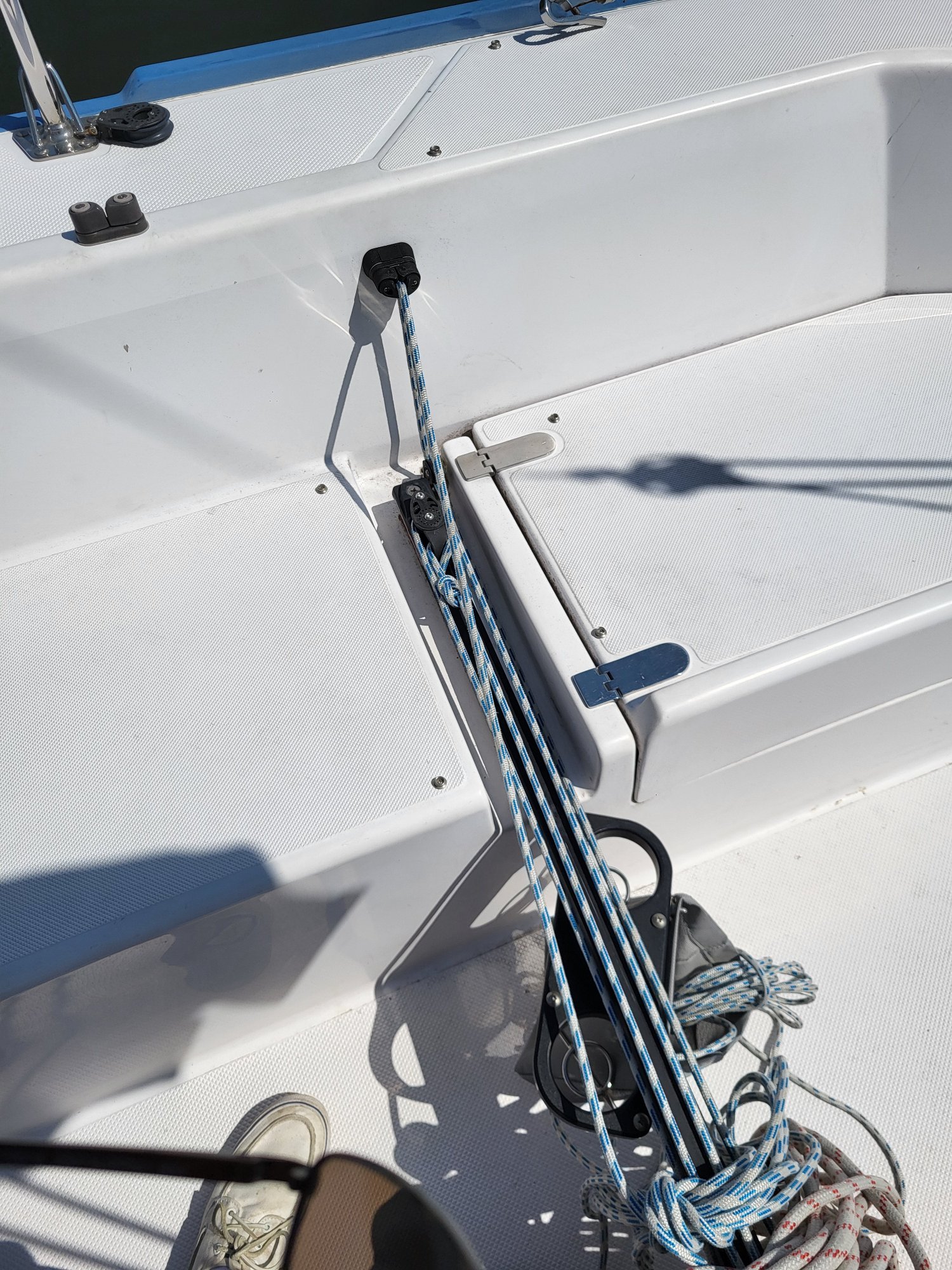

Either way, I probably need to change out my traveler line. It is cut so that the stopper knot is against the jam cleat when at full travel on either side. Whoever cut it didn't leave a tail to grab onto so it's difficult to release. I can try it with one line and then cut it again if I don't like it.

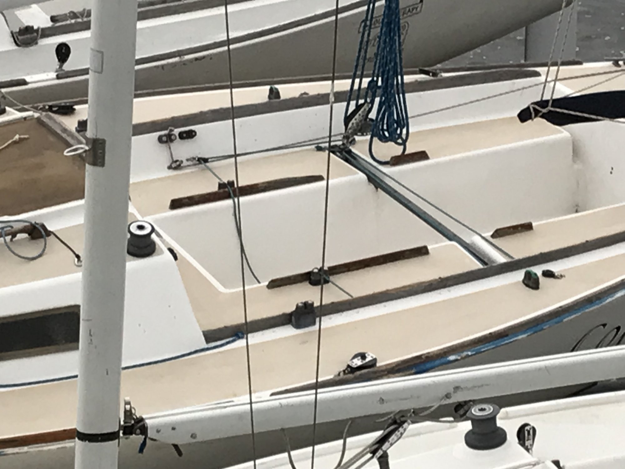

As Codybear notes, whether continuous or separate lines, the real problem with the 275 set up is that you can't easily recleat the leeward side, which as Shemandr notes means sometimes leaning down in unfavorable conditions. I have been thinking about how to reroute the lines to solve this. Ideally I think it would work like the jib sheets on a dinghy, with a cam cleat next to the spinaker cam cleat. This would require block to get the line up and change direction then a cam cleat like the swivel ones on a typical dinghy. But I haven't seen anything that would work because the line has to go behind the cleat. An alternative setup would be like that on the j22 shown here, but I don't love putting cleats on the seat. Anyone else thought about this?
