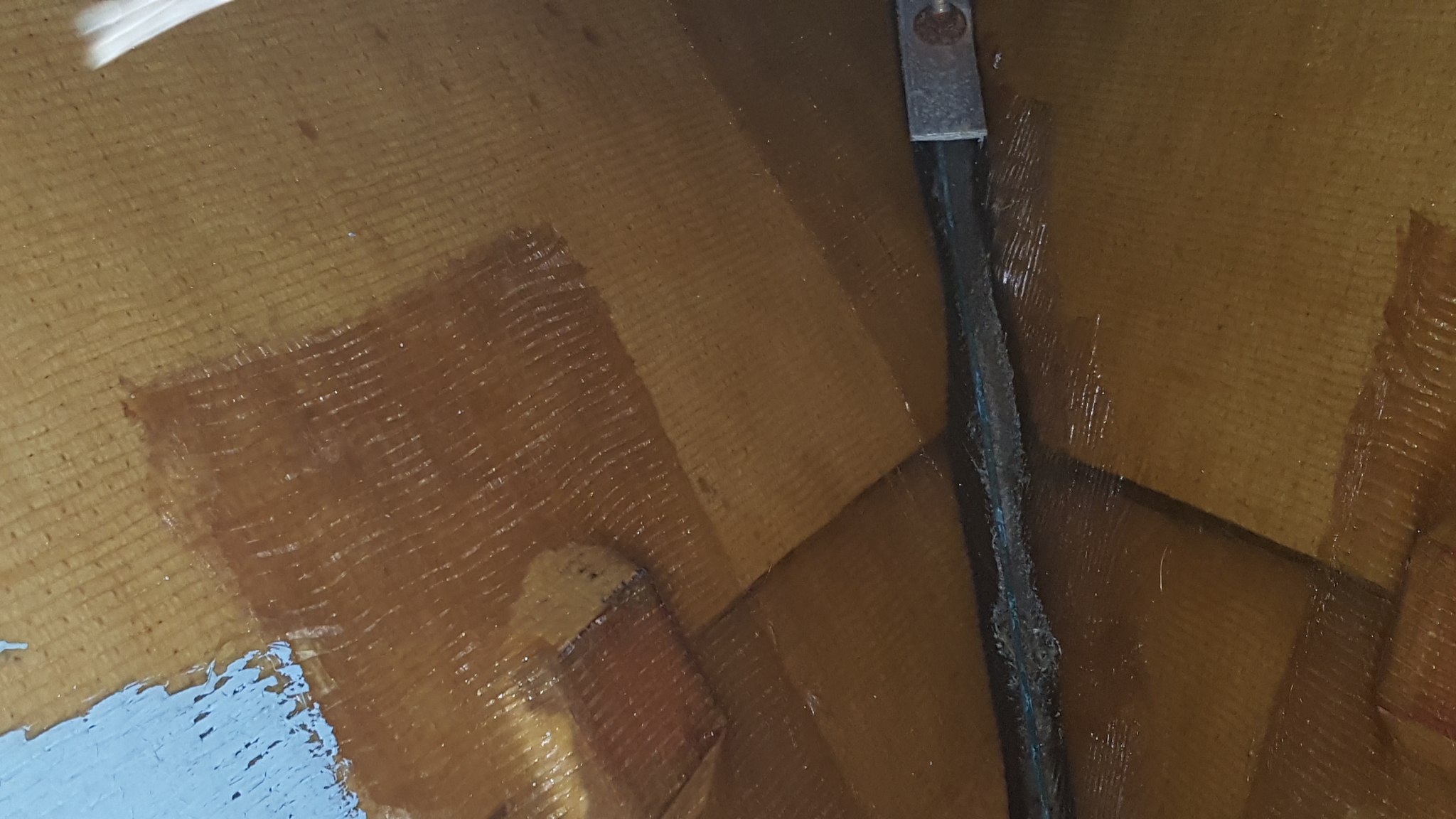

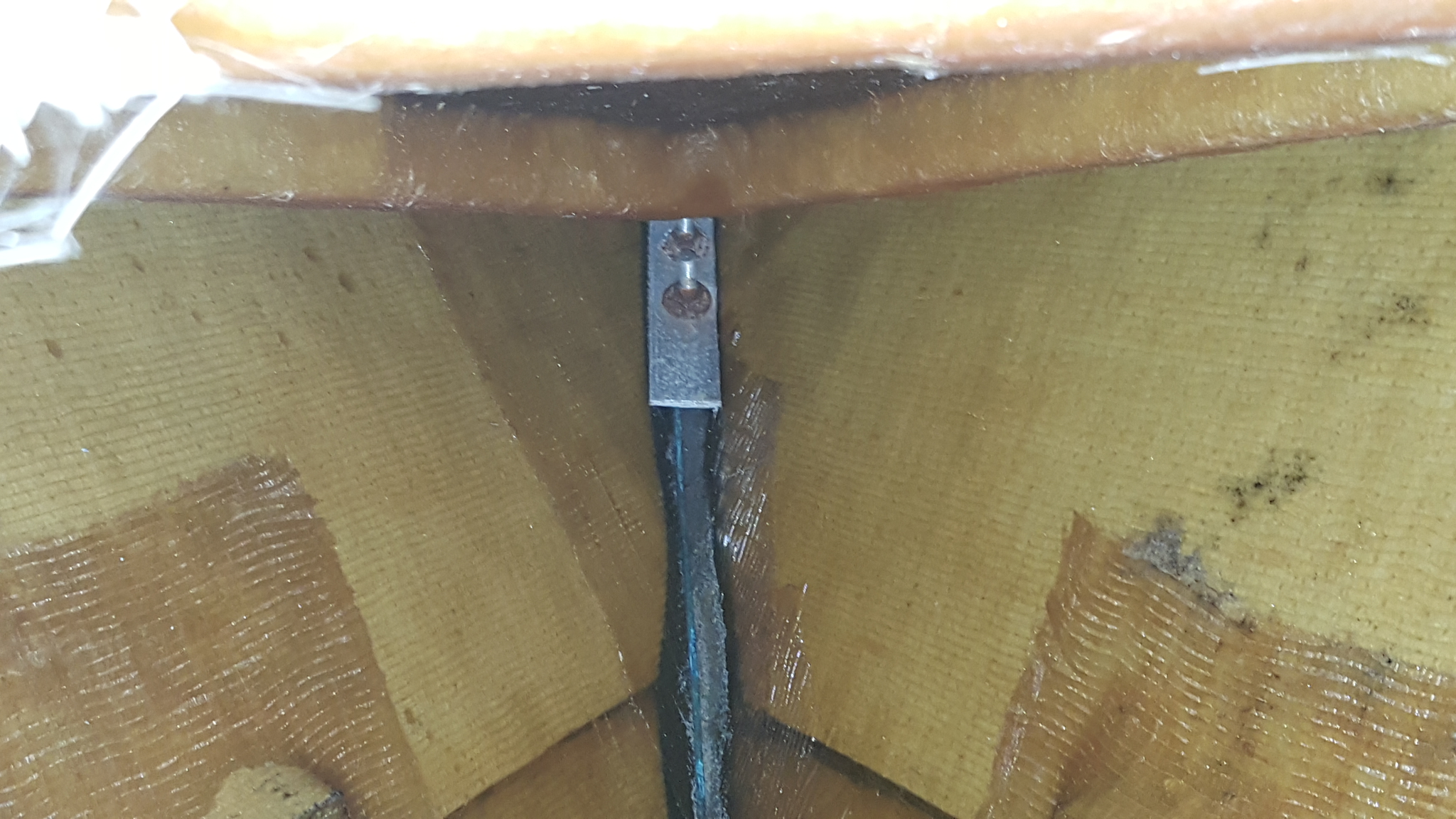

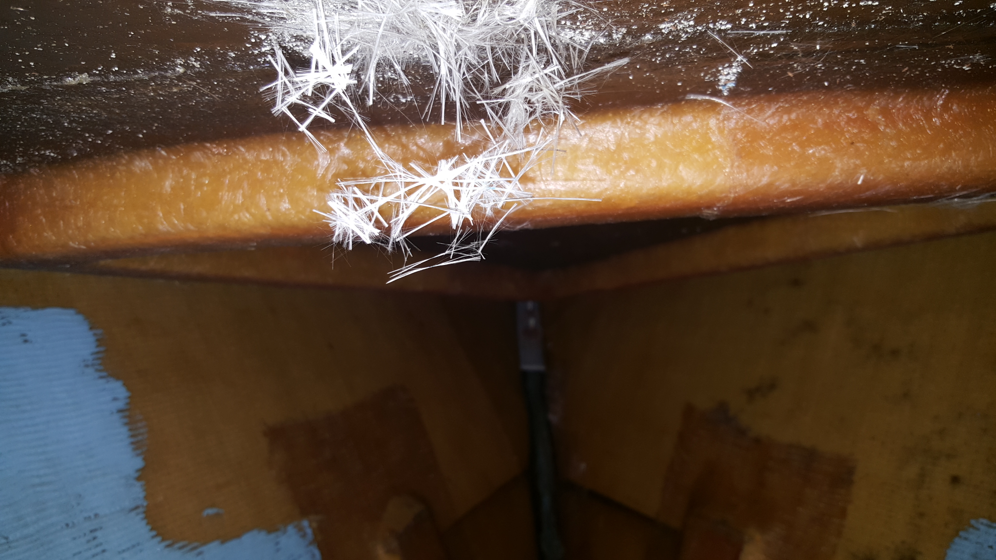

Has anyone ever had water accumulate in this area? No leaks on deck and only one thru hull at galley sink. Replaced every single hose. No water at all when at slip. Appears is happening when sailing. The bulk head is sealed except with access holes on port and starboard side. About 3 feet high from water line. Anchor locker doesnt leak. Slight taste of salt water. Doesn't appear head sink above thru hull has leak. Thought it might be bilge above thru hull taking on water when on excessive heel. Then drains to bilge then when on heel finds its way thru those openings. Perfect storm! In 2 months approximately had about half gallon. Any thoughts? Very little water in bilge just a little wet. Keel bolts perfect no leaks. Diver checked bottom and no issues. Stumped!
