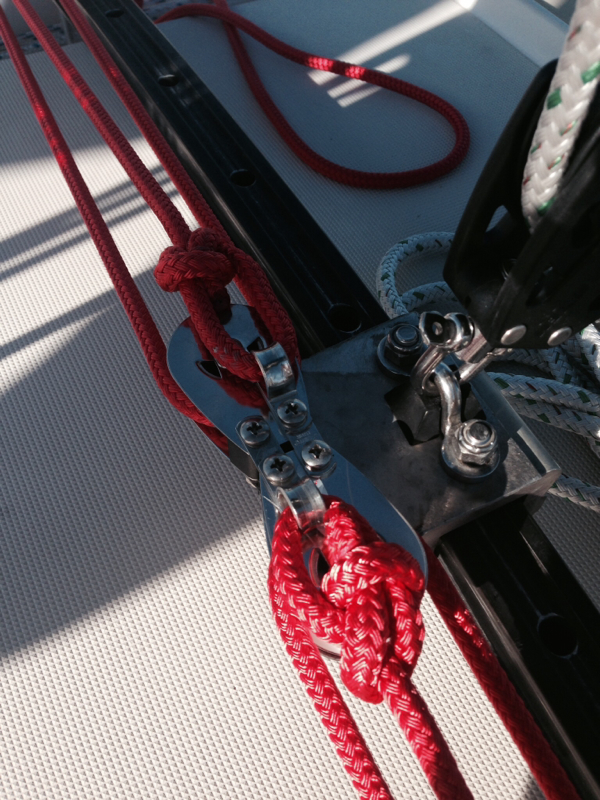

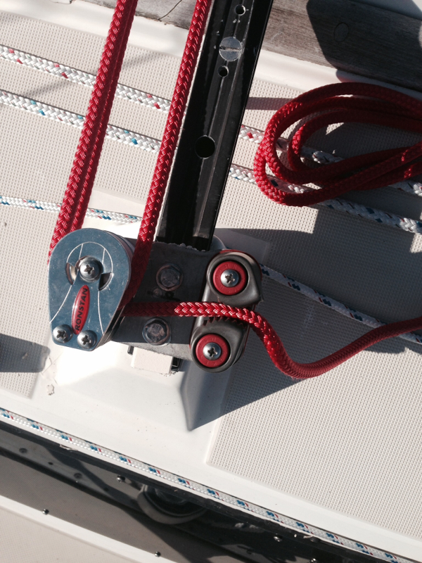

Update on the traveler fix:
Here are pictures.
The first is the end blocks. The second is the traveler car.
It works ok, but... the curved track causes the end blocks to be below the car, so the car gets torqued and binds sometimes. I think I either need to raise the end blocks, or I need to get a straight track. Hmm... That means a new traveler car... which i can get with blocks built-in!
Easing the traveler to leeward prior to tacking works fine. Hauling it to windward AFTER tacking, on a beat, tacking to windward... Doesn't work as well... the car can bind.
I will try raising the end blocks on some Starboard risers first. I have some scrap around, and I will cut it and install it this coming weekend. Let you know how it goes. I ain't got much money in it... Yet! :) huff...
Any ideas are welcome!

how do you like having the two ends for adjustment? I have oth control lines terminating at the traveler car...hate it. Mainly because of the poor working angle in the current setup. My traveler is on the bridgedeck also.

I don't mind having the lines at the ends. It separates them, and it keeps things from getting too messy. I have only used it one time so far, but it seems good. I just gotta fix the angle created by the curved track. It is causing binding when the car is near or past the middle to the far side.
I will post if any problems with the end controls are revealed over the next few weeks.
