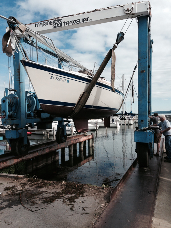

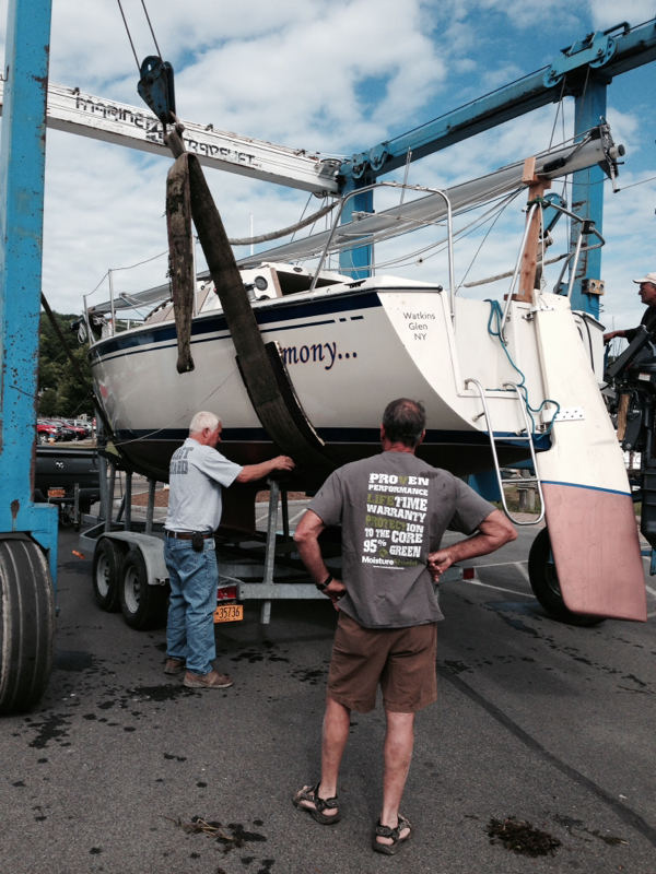

Yes! Ah JOY! We got her launched, the photos are self explanatory. We have a lot of rigging to do today... And hopefully some sailing today or Weds. We need to scrub her down after all our work and so many people walking on her. The launch went without a hitch. I will post more as we get her set up and start sailing. image-22114569.jpg image-1002271082.jpg image-924184397.jpg
As you can see in the last photo, we haven't even pulled the paper off the windows.

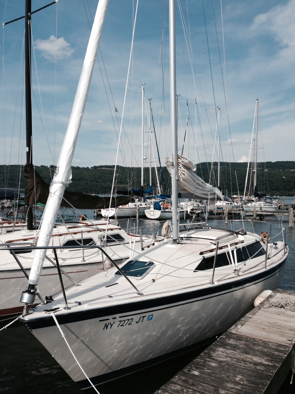

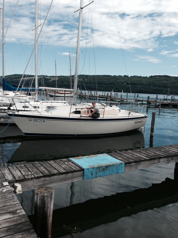

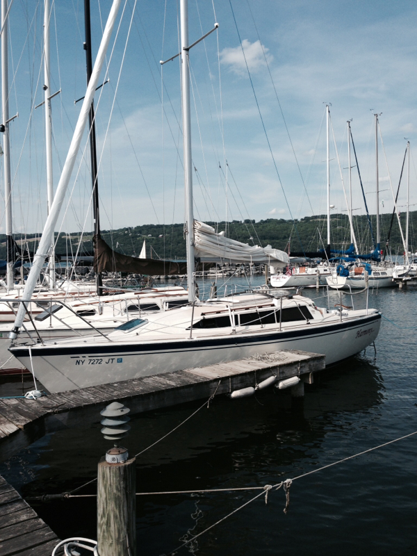

A couple pictures at the dock! You can see our little boat dog peeping out of the cockpit in the first photo.image-227170102.jpg image-2507989790.jpg We had her out sailing today. She seems much faster than our C22 in light air. She handles nicely. We will work on fine tuning all the systems to get her sailing the way we like. Yay! Thanks, Andrew

Andrew did you install the lazy jacks yourself? Oday Break needs them badly ...
No. The blocks are suspended from wire pennants mounted near the spreaders. I just had to put new line around the boom and through the blocks. I think mine are the Harken design.
When you add them, look at some of the ideas people have for deploying / stowing them. Loosen them liberally prior to setting the mainsail. This will keep the leech and battens from catching on them. Tighten them when you are ready to lower the mainsail. Or tighten the topping lift, lower the sail, And then tighten the lazy jacks.

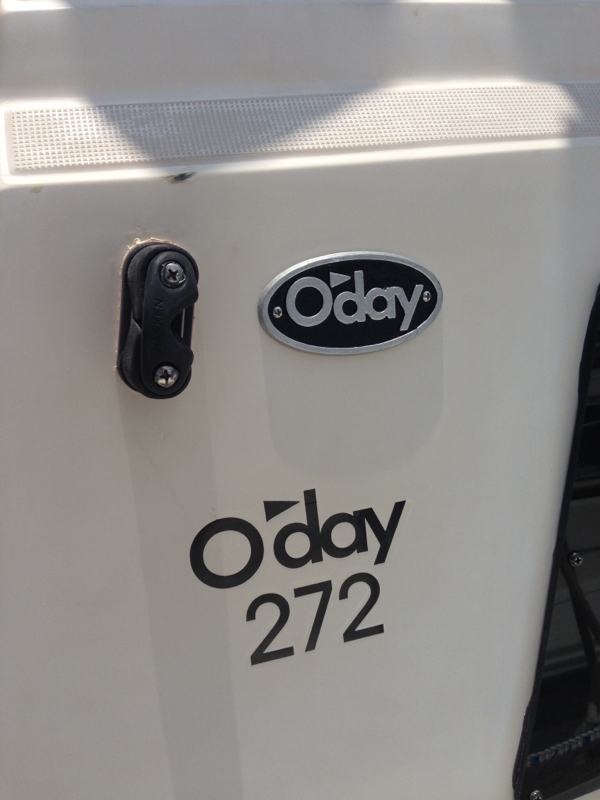

This is how the lettering and emblem turned out.
I used DoItYourselfLetting.com, and I used measurements from the old letters to get close.

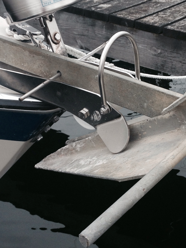

New anchor roller:
It is a Kingston. 3 1/2 inches wide. 15 inches long, I think. I had to trim the side of it to clear my bow cleat. I mounted it far enough forward to keep the flukes clear, and I drilled the roller and the anchor to install a pin. No bungees to hold it in place. The picture shows a temp rod of stainless holding the anchor now.
Another job done.
