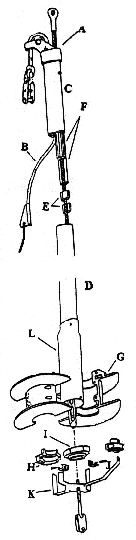

Hi - I recently purchased a 1986 Oday 272. It has a CDI 4/6 (I think). The problem I am having is that the line guard rotates when I unfurl the jib. As a result the furling line wraps around the outside of the line guard arms rather than inside around the drum. If I carefully rewind the furling line around the drum, it will furl fine. It's only a problem when i try to unfurl the jib.
After inspection, I don't see anything that keeps the arms of the line guard from rotating. This is not the enclosed drum style. Instead it has 4 arms that come up from below the drum, one of which has a hole that guides the furling line. ref. K
What needs to be adjusted or replaced?
Thanks!

best guess - model B. It has a stamped flat steel shaped rather than wire shaped line guides.

I don't know...mine is the same design as that shown but the guide eye has never tried to rotate w/the drum. In walking the docks I have seen cases where the eye was tied to a stanction base, but mine has never tried to rotate...I'll look this coming weekend when at the lake

The line guard is supposed to be clamped to the turnbuckle at the bottom of your forestay. If your turnbuckle is not secured with a cotter pin or lock nut you may be loosening and /or tightening your forestay every tim you furl/unfurl. That cage should be secured to the bottom stuf=d on the turnbuckle.
