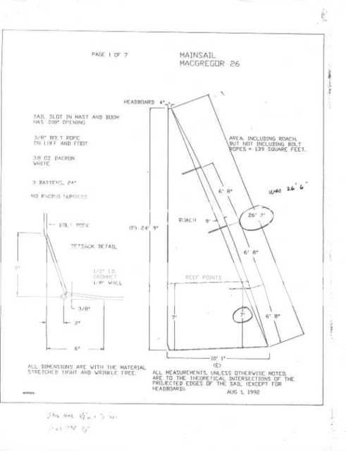

or mby lower the boom with a sliding goose neck (?)
sail looks kinda beat... not sure I would spend money on it..
OTOH, sliding gooseneck will allow to raise the halyard with sheave and the boom. more head clearance...
my .02

You should try it en judge for yourself if it is better, also if it alows more sail área you will have to increase the rudder área.
