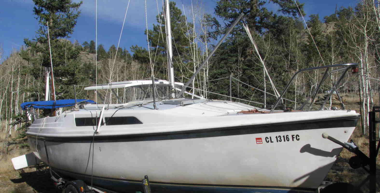

I trailer my 26S 95% of the time so I have raised the mast MANY times myself.

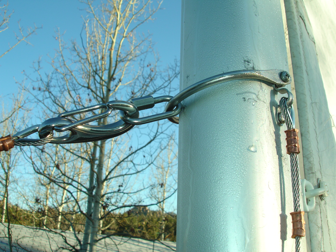

I use the stock gin pole which came with the boat with a modifiction (dont have a good picture - best I could find is attached). The stock gin pole has a pivot at the bottom just in front of the mast base and a rope/pully arrangment which is clipped between the deck and the end of the gin pole. I have the baby stays on either side of the mast. These keep the mast from falling to the side and I rebuilt them from 1/8 inch ss cable with ss thimbles and copper swags. I put quick connects on the baby stays but probably didnt need to as I never disconnect them - even when the mast is in the normal trailering posiition.
The modification I did was to add a 1/8 inch ss cable to the top of the gin pole which attaches to a bail on the mast about as high up as I can get it standing on the deck. I beleive this is similar to what Macregor is currently selling. I have a quick connect to the mast bail - rated for something like 2000 pounds. The nice thing about this cable between the gin pole and the mast is that once the mast if fully up, I can tighten the rope/pulley arrangement and it keeps the mast fully upright with the main side stays tight. This makes connecting up the front stay a "peice of cake" since your not fighting to keep the mast up at the same time. I use a hank on jib partly because it makes dealing with the front stay easy (as mentioned, I almost always trailer the boat). When the front stay is in place, I uncleat the gin pole rope and disconnect the quick connect and let the gin pole down on the deck - where it stays while Im sailing.
The rope/pulley arrangment on the gin pole goes to the cockpit and I lift the mast (from the cockpit) while pulling the gin pole rope. If something gets cought while raising the mast, I will cleat the gin pole rope and fix the problem. Once the mast is somewhat past 45 degrees, I just pull it the rest of the way using the gin pole rope. The baby stays keep it from falling side to side.
It really is a peice of cake to raise and lower the mast on this boat by myself.
The other nice thing about the gin pole on this boat is that you can just leave it on the boat always. I also like this for extended day trips to for example Lake Powell. If I had a halyard slip out of the upper pulleys, I can easilly drop the mast no matter where Im at (I also leave the mast crutch in place just for this reason).
