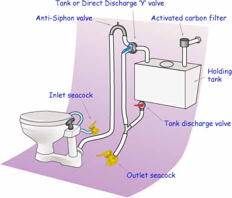

Based on my times there, I think a system with a holding tank that could be discharged in open waters (away from people and shore-based marine life) would make the most sense. Its a pretty commom model in many boats there.
Often a 5 gallon (40l) rectangular tank is mounted on the hull behind the toilet. It fills from the top, and a large valve and seacock on the bottom let it empty to the sea. Small and simple.
This images shows a bypass, which is nice not absolutely necessary.

Most of them have the system I describe in that image above, correct?

For me there would have to be an anti syphon in the inlet side to stop bowl fill. Admittedly with your drawing and gravity I would not need a discharge pump.
