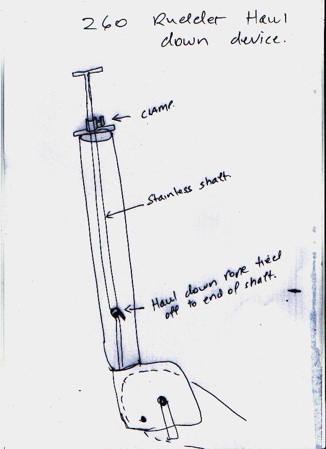

I responded to the other post also,
but, I'll copy it here also, because I think it's an interesting topic on a weak point.Perhaps, the whole think should be reversed to have the shaft push the rudder down and pull the rudder up with 2 ears tipped at a small angle to pin through a hole in the back of the rudder about 6-8" down. The means of holding it down could be either friction or tension, although my preference would be tension, as friction is hard to control, especially in saltwater conditions, and dosen't allow for returning to the prefered position.Jeff Peltier
