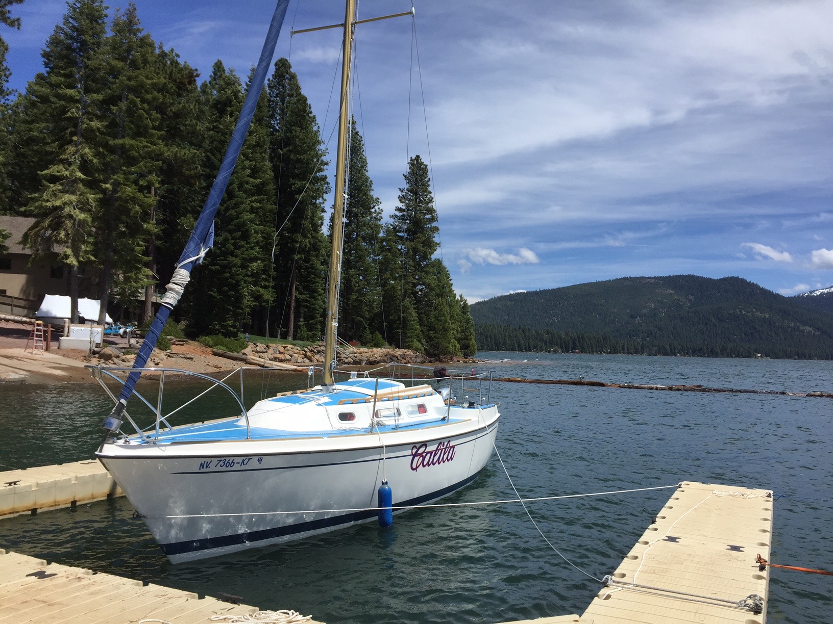

I have a chain and on that particular day the boat was floating high in the stern and the chain would not quite make it so the plan was to attach the chain once the boat had settled on the trailer out of the water. That would have pivoted the eye down and forward. It was my first retrieval of the boat and yes the strap was replaced immediately. Thankfully in this particular situation it was a private ramp and I was able to park the boat just a few feet away.
As far as how do I know. Well I don't have a DOT scale under it or anything like that but with the carpeting being smashed flat and the oil canning its a fairly safe bet. This particular ramp was a little steep but not ridiculously so and the friction of the keel is probably the only thing that kept it from coming off the trailer. You can see the ramp in the photo just off the bow
