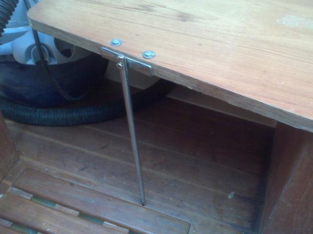

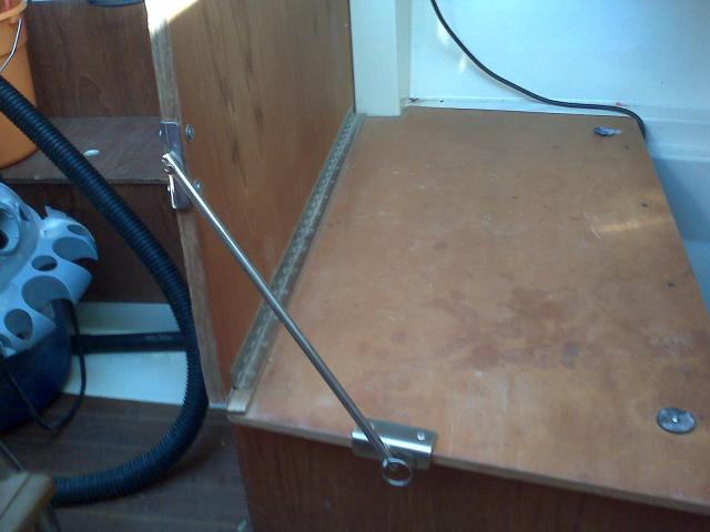

Hey while your reading this, on your settee (seat in the galley) closest to the companionway at the table, is there a metal bar that goes diagonally from the back of the seat to the base? mine is there but not attached, and I'm not sure as to where it goes when you lay the seat back to make it into the bed. I cant seem to find a pic anywhere and I dont get back home til wednesday. Also, not sure if either of us have original sinks in the galley, but other than needing to sanitize and flush mine I need to know how it works. I dont see any kind of hand or foot pump...

Shane, I took some pics. The bar braces the 90 of the bench, then becomes a leg to support the inward corner when the pin is pulled to fold the bench flat.
