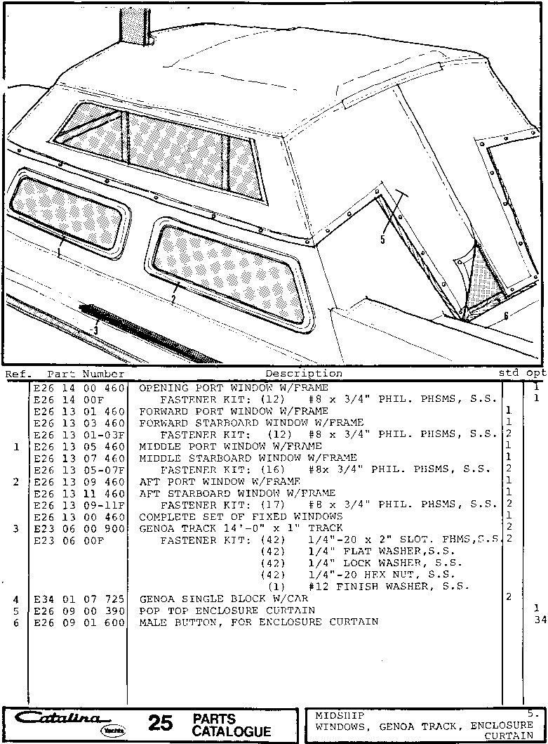

How does a pop-up top work on a sailboat? I tried googling it, but could really see what it is.
The top of the coachroof is a separate section. It is connected to the main coachroof by struts (usually 7/8" to 1" ss tubes) on pins. You lift the entire section from below, the roof lifts and moves forward, ending up at the mast. There is a support clamp at the mast to keep it there and from falling back.
Great idea, we had it on our C25. Standing headroom throughout most of the saloon. Many folks also have enclosures made of canvas and "eisenglass" (dodger window material) for light. Some have replaced the glass with screen material.

Thanks, Stu. Sounds like a very good idea. So it is open on the sides when up unless you have an enclosure?
