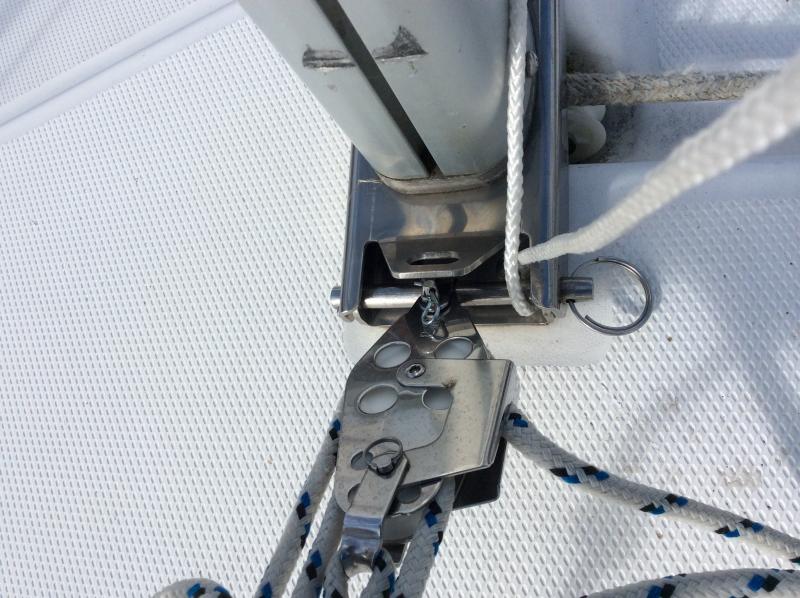

I have a quick question. Where do I attach the boom vang ? The mast pin (where it is in the picture), or the little tab at the foot of the mast ?

Either one will work, but I would use the tab on the mast foot since it looks like that is what it's for. I would also consider reversing your vang so the block with the cleat is up at the boom- will be easier to adjust.

There is what is called a twist shackle that you can use and align up straight with on the tab coming upward at a 45 degree angle.. If your mast is a Z spar or U.S. Spar, then there was a piece that was slid onto the mast pin holding the mast to the mast step which I think you can buy thru this store.

On the 23.5 there is a small ring that slides on the mast pin between the hinges when putting in the pin, like Dave says. The vang does not attach directly to the pin. I don't think the pins are made for that. I would take a wild guess that on yours that eye just above the pin was made just for the vang attachement.
I put my vang cleat at the mast end so the loose end is not dangling in the hatchway, but that is a matter of preference I guess.

Thanks Mates. I will put it back on the tab, or find the Hoojee Crazy Dave suggested.

Just remember to call it a twisted shackle and suggest that you take the vang block with you to insure the pin can go thru the hole. It is not called a hoojee. Most will not know what you are talking about but those at the stores will know when you reference a twisted shackle. Basically it is a shackle that is twisted so it will allow the block to go on correctly vs. twisted.

One more question if I may. The blocks on the boom vang are currently parallel to the deck, boom end and mast end. Should they be oriented vertically on this boat? In that case the twisted shackles would be just right.

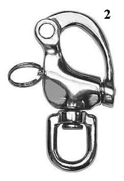

I'm not a vang expert, nor do I play one on TV, but I orient my blocks perpendicular to the deck. I don't think it matters as far as function. But, I do recommend the swivel snap shackles on each end as they allow you to adjust it to any position and make removal/installation quick as a "snap"! :doh:

The block orintaton is not critical for function. It does play a part in how accessable the line is and if the block is scrapping the cabin top. Set it up so it works well for you.
